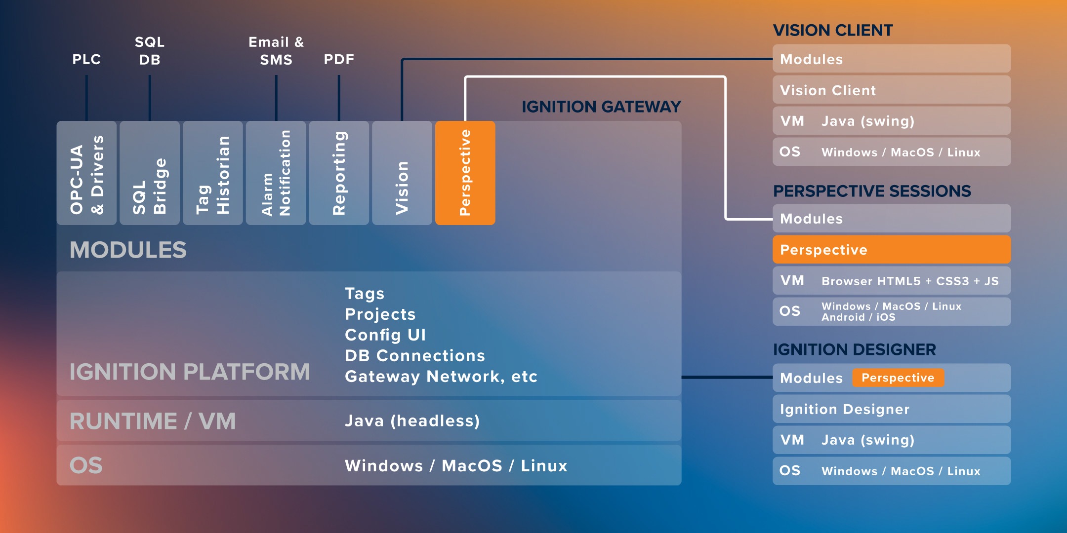

To understand why Vision and Ignition Perspective can run side-by-side, let’s take a quick look into how Perspective fits into the larger Ignition platform.
Vision Client Tech Stack
The Vision Client tech stack, as represented above, is similar to that of the Ignition Gateway and the Ignition Designer.
In the topology of a typical Ignition installation, there’s the Ignition Gateway, the Ignition Designer, and Vision clients. At the base of the Gateway is the operating system, which can be Windows, Mac, or Linux. Above the OS is the Java runtime/VM layer, which is what Ignition runs on. Above the runtime/VM layer is the Ignition platform, which provides many features and services like tags, projects, database connections, the Gateway Network, and so on. At the top of the tech stack are modules, which let you do a number of useful things like connect to devices, use databases effectively, send alarm notifications, generate reports, and, in the case of the Vision Module, to create applications which run as Vision clients.
The Vision clients and Ignition Designer have similar tech stacks. They also run using Java on top of the operating system, and the Vision client is cross-platform so it runs on Windows, Mac, and Linux.
Perspective Session Tech Stack
The Perspective Session tech stack is quite similar to that of a Vision Client, and both can run on the same server.
What we call a “client” in Vision is called a "session" in Perspective, and the two actually have very similar tech stacks. At the bottom of the stack is the OS. In addition to supporting Windows, macOS, and Linux, Perspective also supports Android and iOS. The next part of the stack is the web browser, which is very similar to the runtime/VM layer in the other stacks because it provides an environment to execute code, generate user interfaces, and communicate back to the Gateway. On top of that runs the Perspective session application itself, and then modules can augment the features of Perspective.
As you can see, Perspective is just another module. It installs into the Gateway and provides a design experience in the Designer just like other Ignition modules do. Vision is also just a module; it is not Ignition itself. Clearly, Vision and Ignition Perspective can run side-by-side on the same server.
