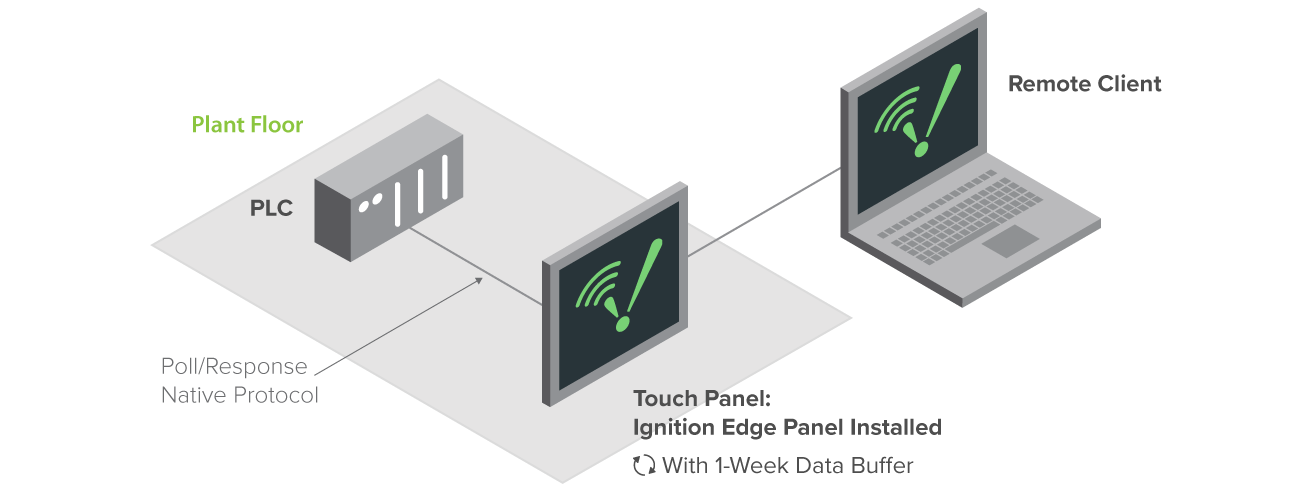

Standalone HMI
Use Ignition Edge Panel to create a standalone HMI at the edge of the network.
