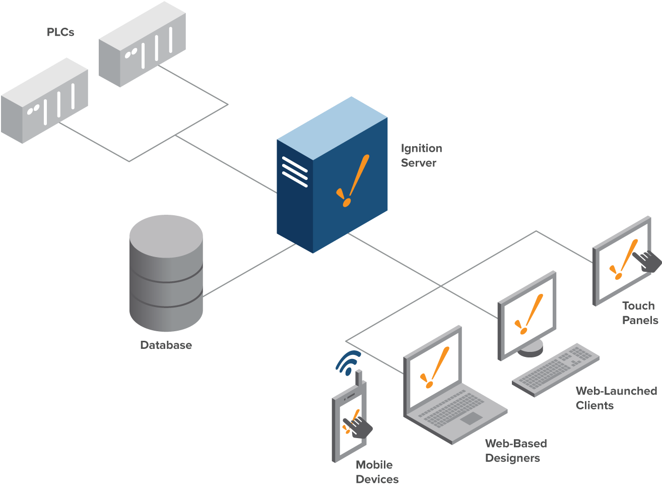

Single Gateway
Ignition’s most common architecture consists of a single on-premise Ignition Gateway connected to a SQL database, PLCs, and clients. In this case, all functionality is configured on the same Ignition Gateway. Ignition’s licensing is unlimited. However, Ignition is limited by the size of the hardware. With more capable hardware, Ignition can handle more device connections, tags, and clients.

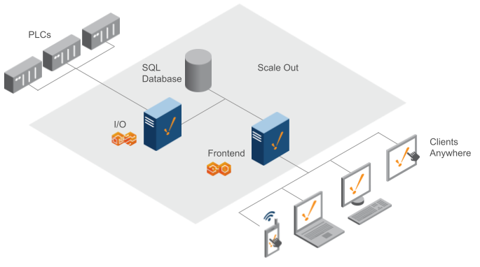

Scale-Out Architecture
In larger systems, it is often easier to have multiple Ignition installations to help split the load between the front-end tasks and the back-end tasks. This is perfect for single large systems that aren't split up into different sites. In cases where systems are split into different sites, the Hub and Spoke Architecture is usually a better fit.
In the Scale-Out Architecture, you have at least one Gateway that handles back-end communications. The Back-End Gateway deals with all PLC and device communications. The Front-End Gateway handles all of the Clients, serving up the data pulled from the Back-End Gateway. This is made possible through the Gateway Network, connecting Gateways to each other, and allowing tags to be shared through remote tag providers. It is important to note that the Scale-Out Architecture applies no matter where the deployment exists, either fully on-premise or hybrid with a cloud provider.

One Back-End Gateway / One Front-End Gateway
With this architecture, you have one Ignition Gateway communicating to the PLCs and performing back-end tasks such as polling live values, historian, and alarming. The Back-End Gateway is responsible for logging data to the SQL database. The Front-End Gateway handles all of the visualization clients (Vision and Perspective) and should also communicate to the SQL database for querying historical data.
With this architecture, you can handle more device connections, tags, and clients since you have two Gateways. You can easily expand to multiple Back-End Gateways and Front-End Gateways as the size of the project increases, allowing for easy scalability.

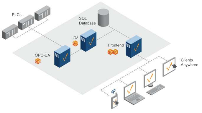

One OPC UA Gateway / One Back-End Gateway / One Front-End Gateway
With this architecture, a dedicated OPC UA Gateway that handles all of the PLC communication was introduced. Essentially, you are breaking apart OPC UA from a single Gateway. This architecture lets one handle a larger set of devices. The Back-End Gateway simply handles the tag value changes. You can easily handle a larger set of tags, in regards to history and alarming, with additional OPC UA Gateways for different sets of PLCs.

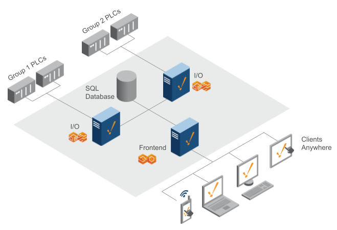

Two Back-End Gateways / One Front-End Gateway
With this architecture, you have two Ignition Back-End Gateways communicating to different sets of PLCs, allowing for communication to a larger set of devices and tags. For example, it is possible to handle approximately 250,000 tags from 200 devices. You can easily add additional Back-End Gateways as necessary.

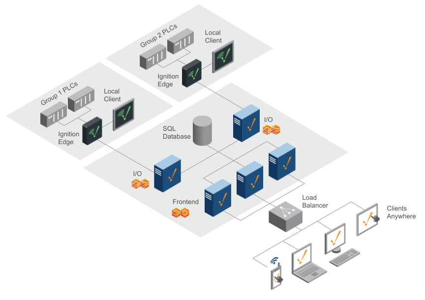

Full Scale-Out With Load Balancer
The best thing about the Scale-Out architecture is that it is easy to scale up Ignition as your system grows. In the image above, more Front-End Gateways were added to help handle an increase in clients, and a Load Balancer to automatically distribute the clients between them. When using a load balancer, it is important to turn on “sticky” sessions to ensure the connection stays consistent for at least one hour. The Front-End Gateway has to be completely stateless. It gets its data from the Back-End Gateways and the SQL database service. Using this architecture with an appropriate number of Front-End Gateways, you can handle thousands of concurrent clients along with a high number of devices and tags.
Examples of Load Balancers:
- F5 Load Balancer
- HAProxy
- AWS / Azure LB
