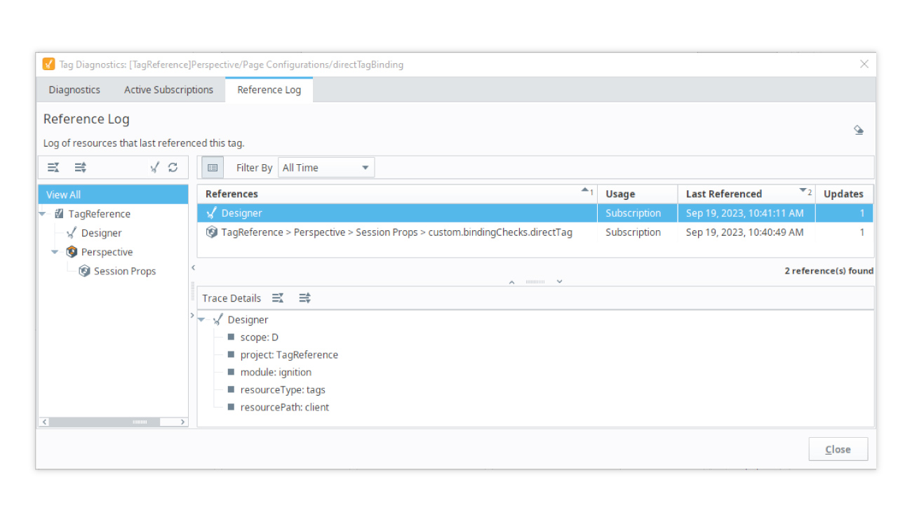

Tag feference log window
Tip 2: Get Instances Of Tag Usage With The Reference Log
This next tip is another way to make good use of the Tag Reference Tracker. Within “Tag Diagnostics,” you can also access the Reference Log. “The Reference Log is going to give an instance of where [a] tag is used, either in the client or in the designer,” Tyson explains. This usage could be reads, writes, subscriptions, configuration changes, etc. Just like with Active Subscriptions, to use the Reference Log, you’ll need to ensure that the Tag Reference Tracker is enabled in your gateway settings.

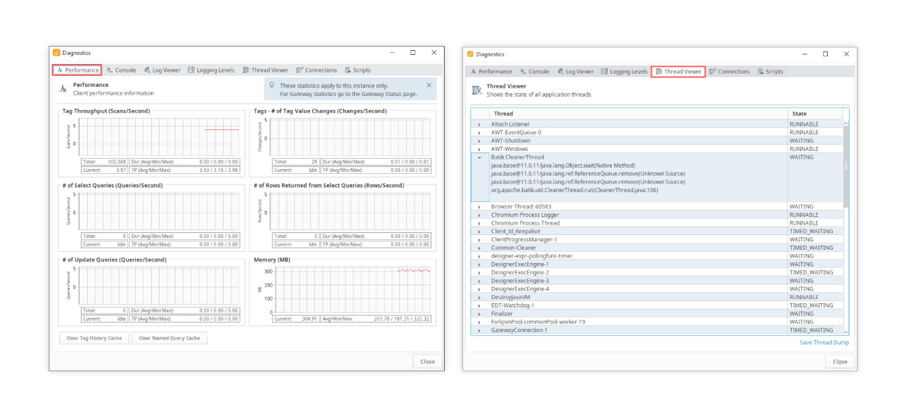

Tip 3: Speed Up Troubleshooting With The Help Of Diagnostics View
One way to troubleshoot more quickly is by accessing designer statistics via the Designer Diagnostics view (go to Help > Diagnostics in the designer). This window has numerous tabs such as “Performance” (to see, for example, how much memory you’re using, or tag throughput), and “Thread Viewer” (to see all threads and their states). Tyson offers an example of when this can come in handy: “If you call into support and you're having designer issues, the support rep might ask you to save a thread dump, which you can do here.”

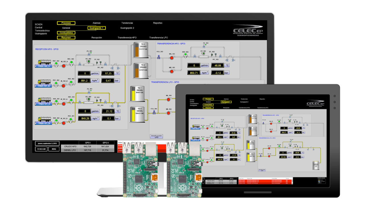

HMI screen design - adaptable interfaces
Screens courtesy of Innovatronica S.A.
Tip 7: Specify Components to Automatically Grow/Shrink
This is a quick way to improve the appearance of your HMI layout by ensuring the interface elements will automatically adapt to an appropriate size. If you’re, for example, using dynamic text within a component where the text could be different every time you view it, specifying the component to automatically grow or shrink based on the content within it is a simple way to improve user experience. “You can also do this with containers and pretty much any Perspective component. The size of the component is going to be based off the content that is inside of that component,” Tyson says. You can accomplish this by going to the property editor and setting the component’s basis to “auto” instead of specifying a number.

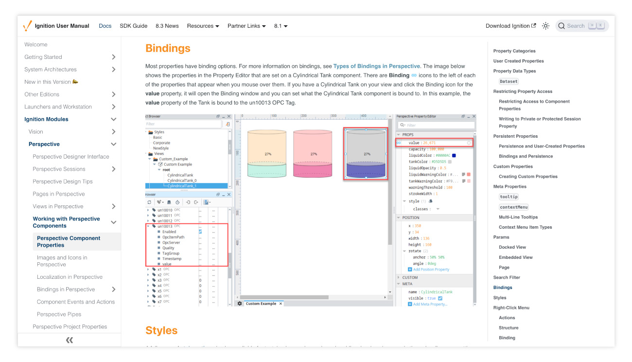

Ignition User Manual Screen
Tip 8: Copy/Paste Bindings
If you have a lot of scripts specified on your binding, this tip is a valuable time-saver. Simply right-click on a property that has a binding specified, and click on “Copy Binding” in order to copy the binding. “That would include all of the binding, any sort of transform, any scripts, mapping, formats, etc.,” Tyson explains. You can then paste that binding elsewhere by right-clicking and selecting “Paste Binding.”
By copy/pasting a binding, you’ll save time by not having to redo an entire binding — you can just paste a binding in and then edit only what you need to (say, a tag path for example).

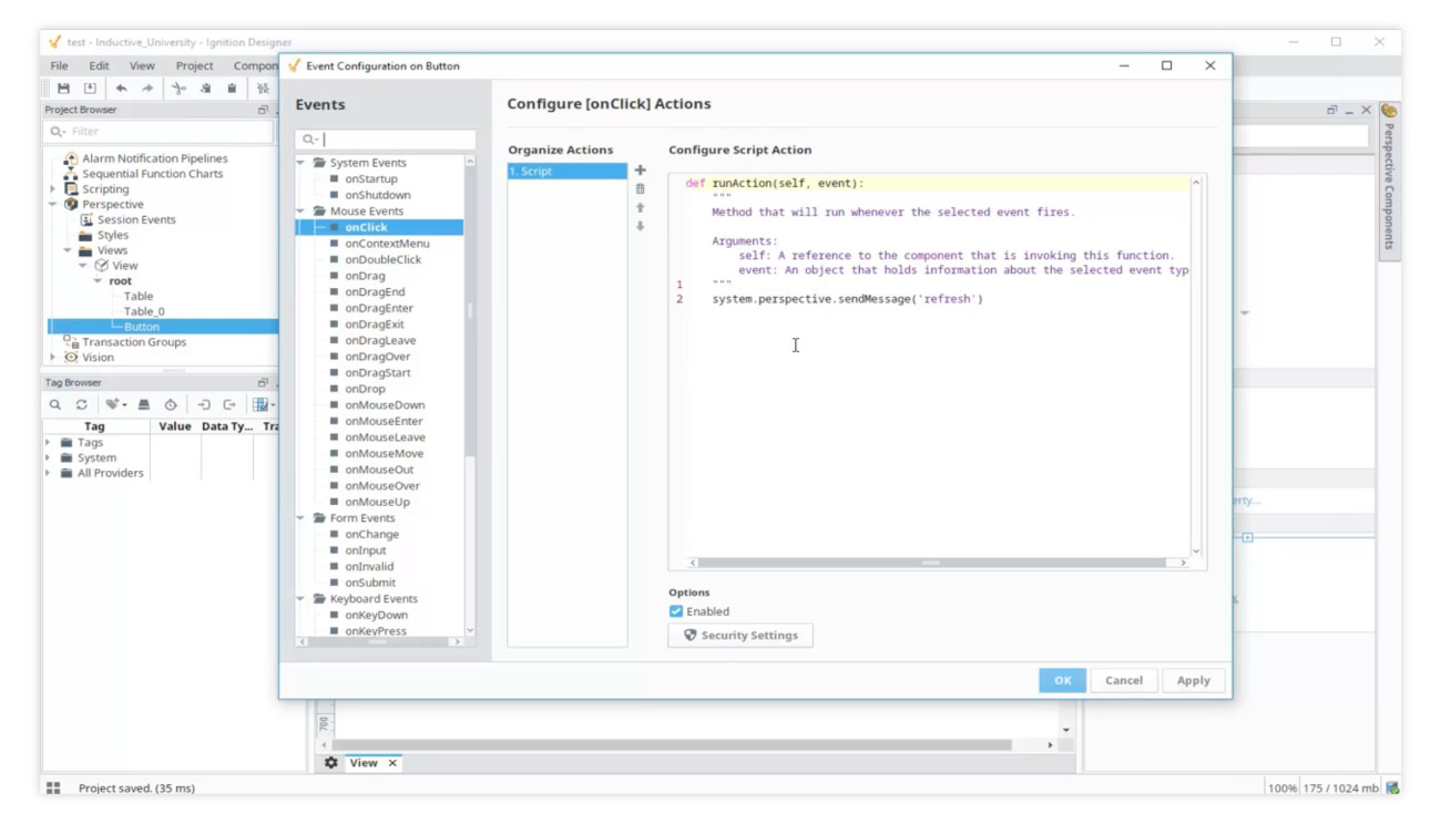

Tip 10: Send Data With system.perspective.sendMessage
This last tip is an easy way to send data across a Perspective screen. system.perspective.sendMessage lets you send a message from one event to a corresponding message handler. “This lets you pass data around a Perspective view without having to use all the in and out parameters,” Tyson says, “especially if you had embedded views inside of embedded views ... You don't need to tunnel those parameters all the way through; just use message handlers.”
