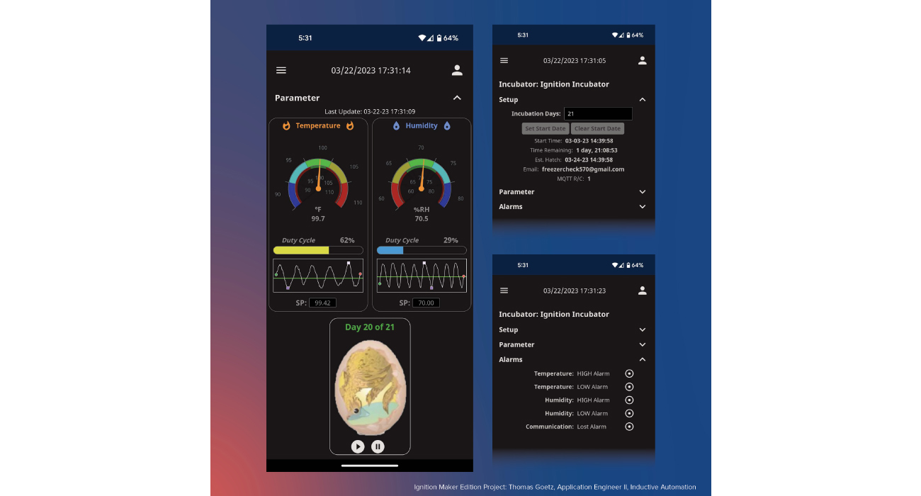

I used Ignition Maker Edition to build the most recent version of my incubator, and with the software’s ability for data visualization and improved communication, my project was able to truly evolve. The incubator runs a C++ based language (Arduino IDE) and now has automatic egg rotation, communication via a Hive MQTT broker, and a user-friendly UI with setpoint control, alarm notification, and data monitoring.
The alarm notification feature relieves me of the anxiety that something might go wrong without my knowledge, since I now get notified if the incubator loses communication, as well as if temperature or humidity gets too high or low. When there was a power failure a while back, the system immediately alerted me via my mobile device, and I was able to solve the issue in 25 minutes. Without the alarm I wouldn’t have checked on the eggs for six to seven hours, at which point I likely would have lost them all due to the cold.

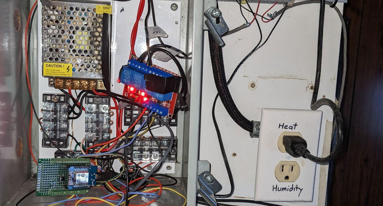

Incubator Hardware
A major goal for this project was to keep it as low-cost as possible, and I was able to achieve that, having spent around $150 for the current version of the incubator. I built a lot of the equipment myself and used a 3D printer for many elements.
Here’s a list of all the hardware that the incubator contains:
- Dorm Room Refrigerator
- Computer Fans
- WeMos D1 Mini Microcontroller
- 4 Channel 12V Relay Module
- Si7021 Temperature and Humidity Sensor
- 12VDC 4A Power Supply
- 100 Watt Tube Heater
- LGP-1 Gear Pump
- Custom Designed and 3D-Printed “Shower Head”
- Gear Motor
- Custom Designed and Machined CAM system

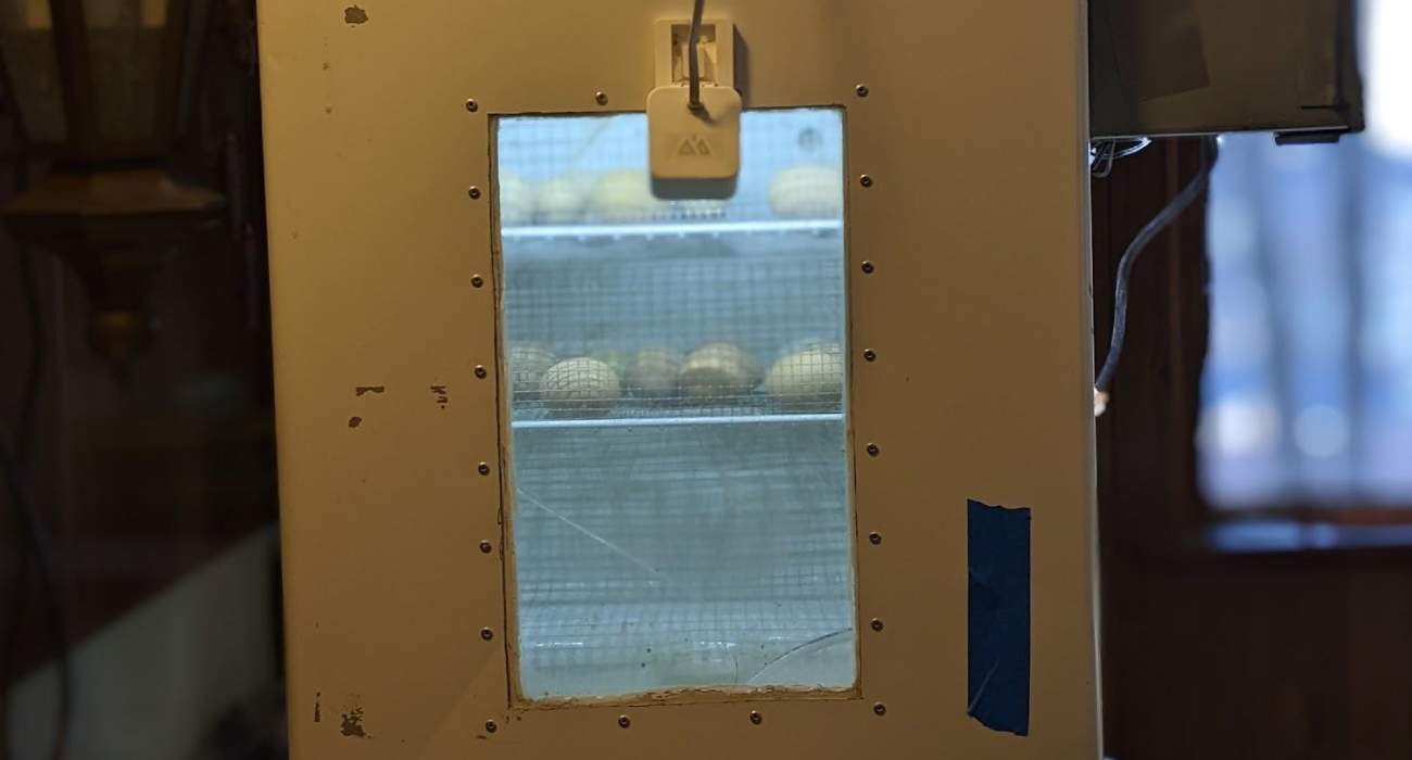

Finding Freedom with the IoT
The IoT element of the system makes my life a whole lot easier. The system publishes and/or subscribes to a number of different topics via MQTT, including temperature, humidity, heartbeat, temperature setpoint, humidity setpoint, and more. And the incubator toggles the heater and humidity pump ON or OFF based on the current value, setpoint, and deadband.
I run Ignition Maker Edition on my own server, and use a Hive broker that sits up in the cloud. Because of this, I can communicate with the incubator no matter where I am. And the incubator itself has mobility. Thanks to a WiFi chip on its microcontroller, I can easily connect it to a different network if I need to relocate it. Having such an easy, remote way to communicate with the incubator has been a game changer.
