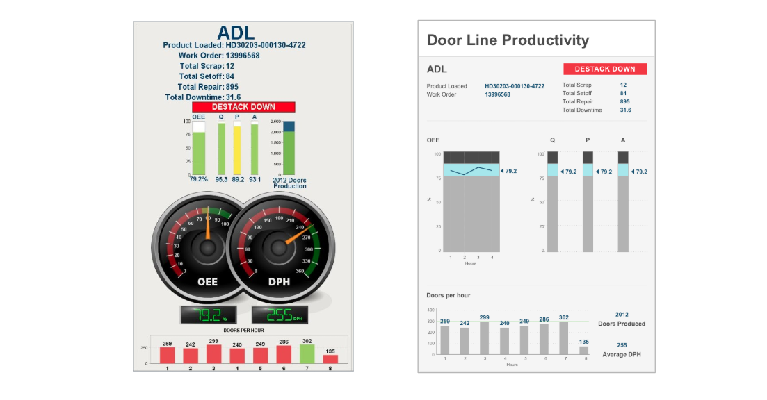

One of the most dramatic overhauls that the design gurus took on was submitted by an anonymous client in the manufacturing industry. Here’s the HMI example they were using:
![HMI Makeover: Initial Interface](/blog/sites/default/files/inline-images/HMI%20Slider%20under%20image.png)
At first glance, this screen’s 3D rendering and bright colors might look sophisticated, but these flashy design elements can actually make the operator’s job harder. Bright colors grab unnecessary attention, while overly complex graphics distract users from gleaning the necessary information from the image.
Our design gurus utilized six main rules of graphic design to take this project from cluttered to clean and efficient. Read on to learn how to apply these techniques, and see them in action on this project.

2. Limit Color
Color is one of the most important aspects of visual design, and one of the easiest tools you can use to draw attention to important occurrences on the screen. However, just as color can draw attention to important information, it can also distract if it is used too liberally, as we saw in the squint test. In the above HMI examples, there are over 10 colors at play on the screen. This keeps the focus away from the most important information: the OEE of each door line.
By eliminating unnecessary colors, operators are able to efficiently focus on what is important. For these HMI examples, pulling the color out of all but the most urgent areas will help the operator easily interact with crucial elements, like a mechanical shutdown, without the distraction of less important indicators. Our makeover gurus used bright red to indicate a mechanical shutdown, and green to show that devices are running. All other elements were toned down to blues or grays.

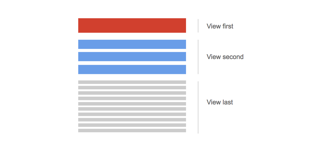

3. Leverage Visual Hierarchy
![Graphic Design Guide to Visual Hierarchy](/blog/sites/default/files/inline-images/Screen%20Shot%202018-06-29%20at%2012.12.18%20PM.png)
Visual hierarchy is an intuitive tool you can use to guide your end user through your project. A newspaper’s use of text is a great example of a visual hierarchy: the most important news is the headline, made of large bold text, then subheadlines with less important news are still bold, but much smaller than the main story. Finally, the details are in small print. On an industrial interface, make the most important factors the largest and easiest to spot, while less relevant information can be visually de-escalated with smaller fonts or lighter colors. Be sure to keep your text within the same theme or font when using visual hierarchy to limit distractions, and again, only use color when it’s a crucial element.

6. Simplify Images and Charts
Graphics, especially 3D rendered ones, can look cool — however, that’s all they accomplish in many cases. In fact, the image can veer focus away from content that is actually being displayed by the graphic. High-performance charts like sparkline charts enable users to quickly ascertain information without having to interpret a dial or look at multiple graphs, plus they take up less space. IA’s design gurus eliminated the complex gauges on the original HMI example screens in favor of a sparkline chart; this shifts the focus from the graphic image to the actual information being relayed: OEE rates.

The result is dramatic: after analyzing the table and determining its purpose (perhaps with a squint test), the IA gurus started their overhaul by toning down the color of the less important elements, changing bright reds and greens to blues and grays, highlighting the most important information, OEE, in blue. The most crucial information, whether the line is running or down, remains in bright red and green, since it is the most important thing for the operator to monitor.
Next, the team eliminated the gauge graphics, which didn’t provide helpful information and also had some redundancies on Doors Per Hour. They replaced the graphic gauges with a sparkline chart, which decreased visual noise for better user experience, and made the information easier to read.
The team then determined locations of the elements by using visual hierarchy, based on the needs of the organization. Now, the screen illustrates all the key components without effort for the operators, it’s easier to read, and increases operator efficiency. Overall, the IA design team’s efforts resulted in a makeover story worth the buzz.
