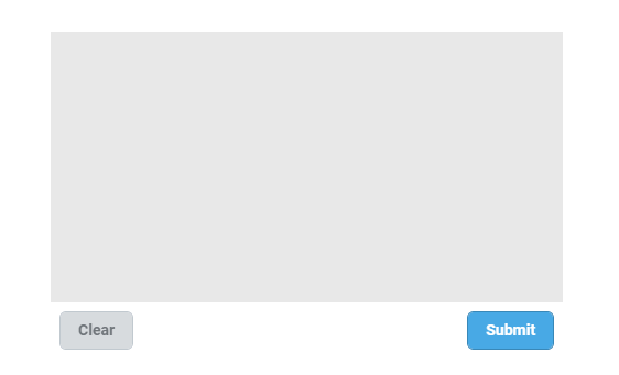

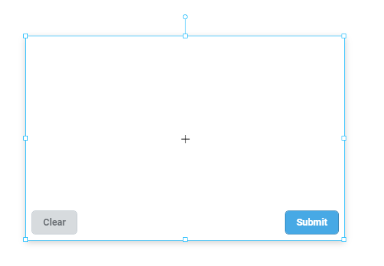

First up, we have a new addition to Perspective’s component library: the Signature Pad component.
Signature Pad
As the name implies, the component allows users to draw a signature (or whatever they want to doodle), and submit it. “Submitting” the signature will trigger a special onSignatureSubmitted event that provides easy access to a base64 encoded PNG of the signature, allowing you to store it for later use.
The obvious use case here is to help in situations where a process requires some sort of signature. By using the new component, you can capture signatures right from the session.
Sign In Action

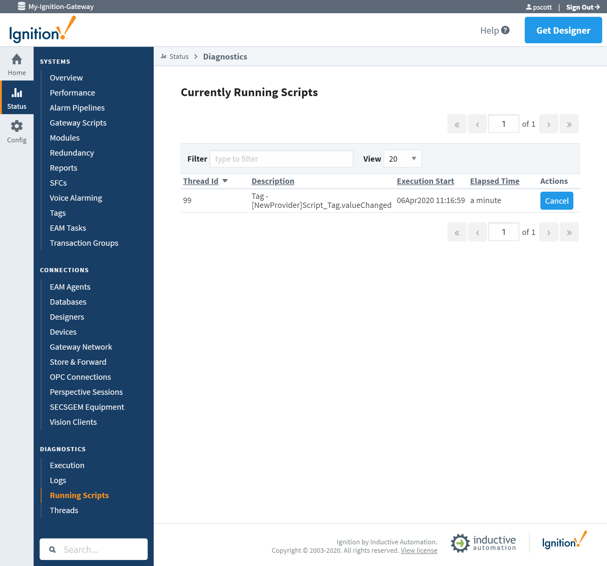

Fortunately, that’s no longer the case. In 8.0.11, we added several new interfaces that can display and interrupt running scripts. First up would be the Gateway, where we added a new Running Scripts page under the Status section.
Running Scripts Page

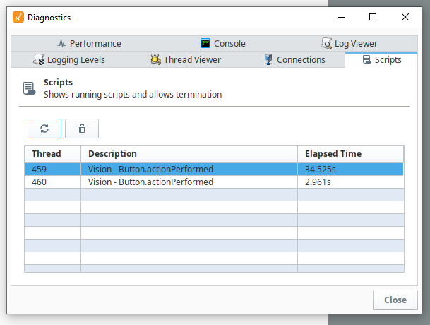

Next up, we added new interfaces in both the Designer and Vision clients that also show running scripts, designed specifically to show asynchronous scripts (sadly, can’t really use the window to show synchronous scripts). The new UI is available on the Diagnostics popup.
Diagnostics Window

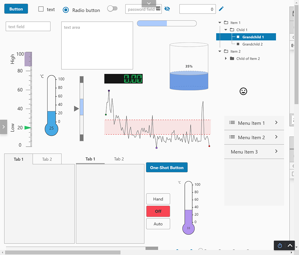

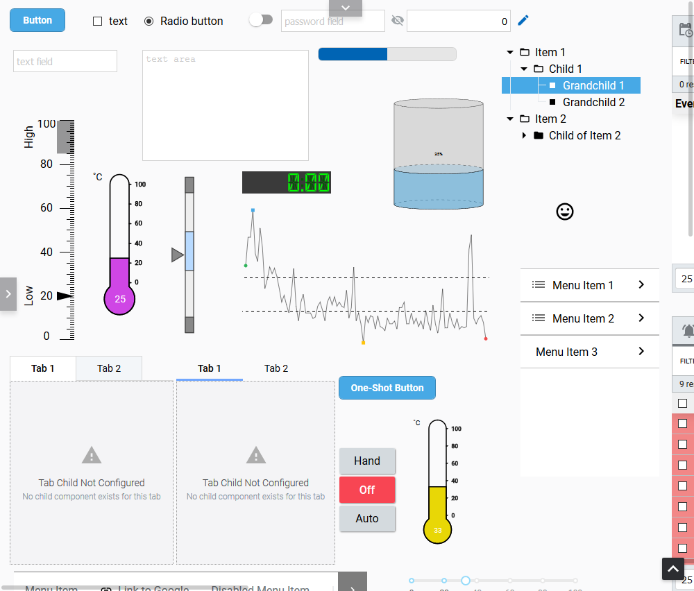

Here’s the old light theme (which most of you are probably using):
Before
Here’s the new light theme in action:
After
As you can see, there are some minor visual changes. Of course, as with all Perspective styling, you can freely override any styling rules you like. The benefit is that all components out of the box will consistently look great together.

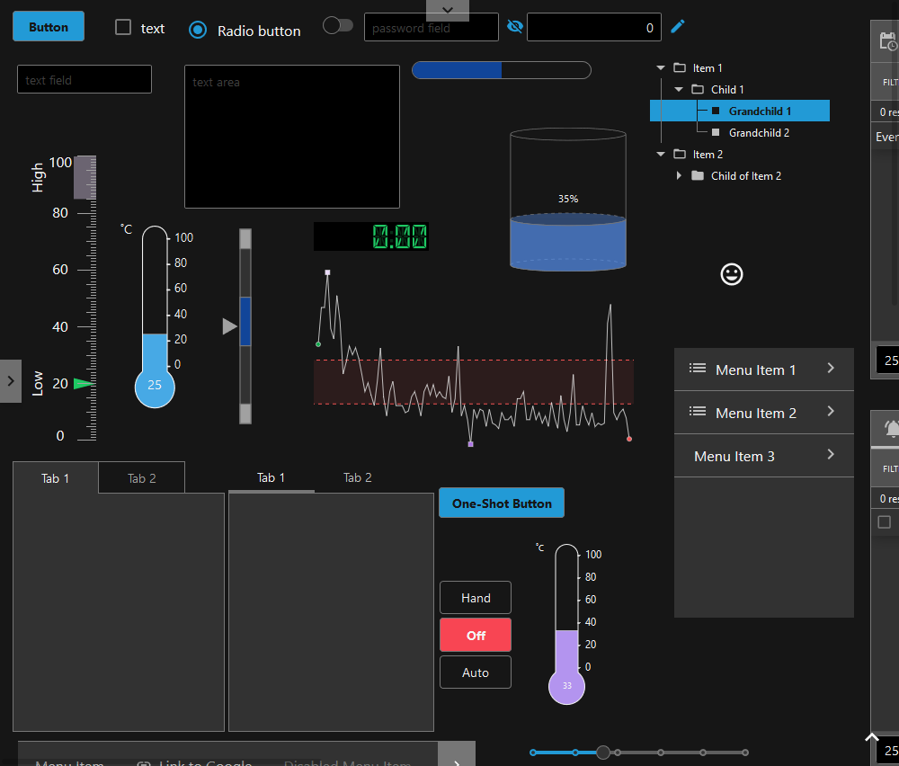

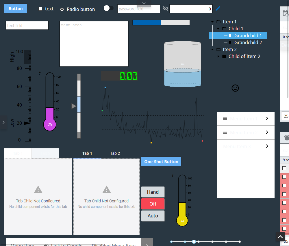

If you want to know what the dark theme looks like:
Current (yikes!):
Dark Before
After:
Dark After
This time we see a HUGE improvement!
