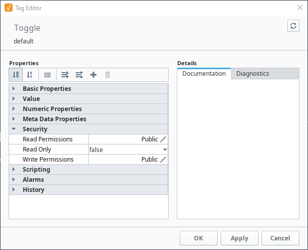

The next time you open the Tag Editor after upgrading, you may notice the security section has some different properties:
tagPermissions

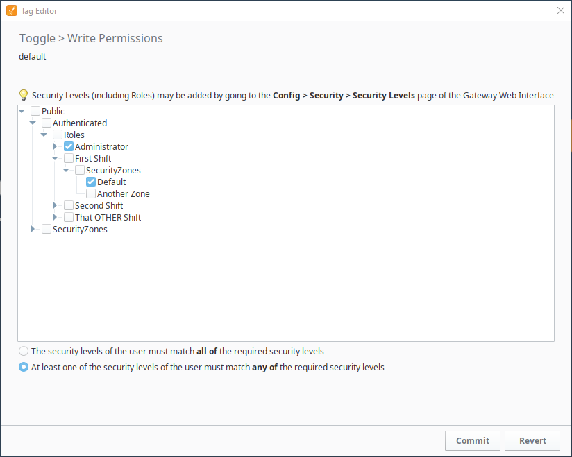

In addition to a dedicated “Read Only” property, we have the two new “Permissions” settings, which allow you to specify which Security Levels (or combination thereof) are allowed to interact with any tag.
writePermissions
When upgrading from an older version of Ignition, we’ll update the permissions settings on your tags to use the appropriate combination of roles and zones, so you may not even notice this new user interface in live systems.

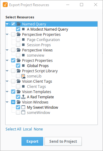

We made two smaller yet impactful changes to how a project is exported from the designer. Specifically, this dialog:
exportProjectDialog
It’s the same window you’re probably familiar with, but with some small differences. First of all, you may notice the blue “Local” text right below the tree. This is a new local option we added, which when selected, basically checks only resources in the current project, excluding inherited project resources. This is also the default selection option when that window opens now, so we won’t automatically include other resources from an inheriting project, unless you choose to do so: using the “All” option.
Secondly, you probably noticed the “Send to Project” button. Have you ever been building something really useful in a project, and found you wanted to move it to another project on the same Gateway? This comes up quite a bit if you’re trying to use project inheritance, as you’ll inevitably make something for one project, then realize it should probably be in an inheritable project, so that other inheriting projects can make use of it too. But to make that happen you have to do the “export-project, designer-switching, import-project” shuffle. If only there was an easier way.
Well, my friend, 8.0.13 is where your hopes and dreams come true. That’s what the “Send to Project” button is for. Pressing that button will take you to a new window that allows you to pick another project to send the selected project resources to.
Again, on paper these are smaller features, but if you’ve been making use of project inheritance, they’re both solid quality-of-life improvements.

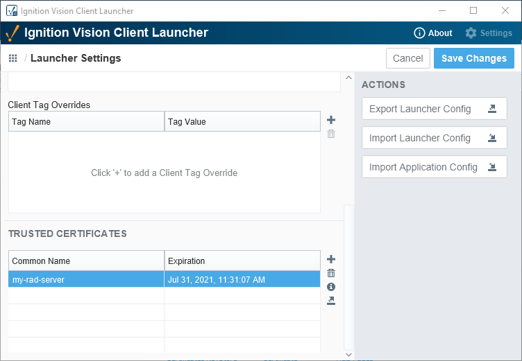

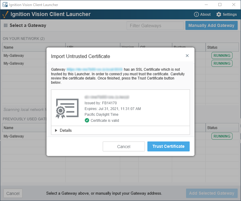

First, launchers now have a user interface that allows you to trust security certificates on client/designer launch.
Ignition Vision Client Launcher
In addition, we added a new Trusted Certificates table under the launcher’s settings, allowing you to view which certificates have been trusted, trust new certificates, or remove existing certificates.
Trusted Certs
