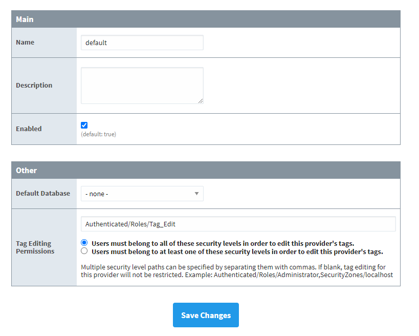

Starting in 8.0.16, you can use Security Levels to restrict edit access to tags in Tag Providers, allowing you to determine which specific users with Designer access are allowed to make changes to things like UDTs in a provider.
If you’ve been using Ignition since the version 7 days, you may recall a similar feature existing. With version 8’s new tag system, the old setting didn’t mesh well, so we temporarily removed it while strategizing a new approach.
Starting with 8.0.16, when you edit a Standard Tag Provider, you’ll be greeted with the new Tag Editing Permissions setting:
The verbiage on the radio buttons may seem familiar if you’ve tried using Security Levels in Perspective. Basically, you can specify a number of Security Levels (delimited by a comma) that dictate if a user needs all defined levels, or just one of them to be allowed to edit tags.
Once enabled and opted in, attempting to edit a tag will throw an “Access Denied” message, and prevent the edit. This applies to making changes from the Tag Editor, writing to tag properties in the Tag Browser, using the system.tag.configure function, and even “wild card” stuff like binding tag properties bi-directionally to a Vision component (yes, we check the security levels even in the Vision and Perspective runtimes).
In addition, this setting also dictates if the user is allowed to make new tags, as well as delete existing tags. Never again will you have to worry about a new application designer accidentally deleting that critical UDT definition.
As a friendly reminder, please note that editing a tag is technically a different thing than writing to it. Sure, writing to a tag is technically just editing the value property on the tag, but we felt the property should make the distinction between writing to the tag’s value, and altering the behavior of the tag altogether. Thus opting into this new setting won’t inhibit any existing write permissions you may have configured.
As always, we try to be careful when adding new features like this. By default, no restrictions are applied, so this feature won’t impact existing systems upon upgrade.

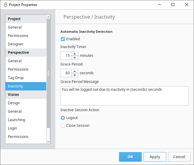

Next up, we have a new area of Project Properties, dedicated to detecting inactivity in Perspective Sessions.
Inactivity properties
We found a lot of users requesting a way to figure out how long it has been since a user was “active,” or interacting with the session on a semi-regular basis. With regards to Vision, we found users generally utilized the built-in system.util.getInactivitySeconds function to determine if a user is currently active.
More often than not, a user being considered “inactive” is generally used as a way to trigger some sort of logout behavior: the idea being that an “inactive” client suggests the user may have stepped away. Thus getInactivitySeconds calls are generally followed up by scripts that either switched to a lower access level user, or logged the user out of the client altogether. Considering this is such a common practice, we decided Perspective should have a more integrated solution.

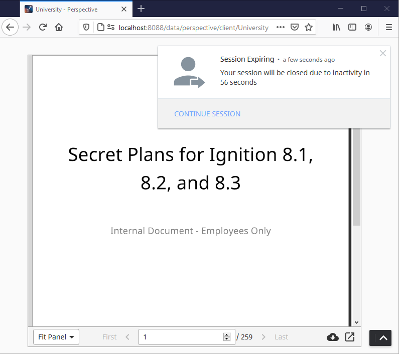

Regarding how this works, it’s fairly easy to use. First you have to enable the inactivity detection, then define how many minutes need to go by before the session is deemed inactive. There’s an optional Grace Period property (optional in that you can set it to 0), that shows the user a countdown, giving them a chance to interact before the Inactive Session Action occurs. You can see the grace period notification below:

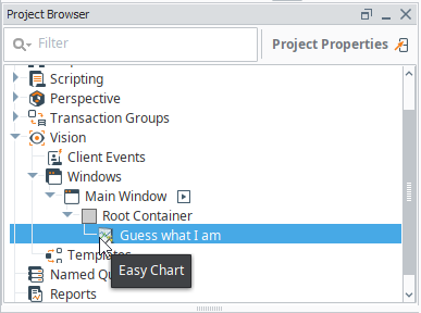

Project Browser Component Tooltips
When hovering over a component in the Project Browser, we’ll now show you a tooltip that declares the name of the component, making it much easier for folks newer to the module to be able to decipher existing projects.
