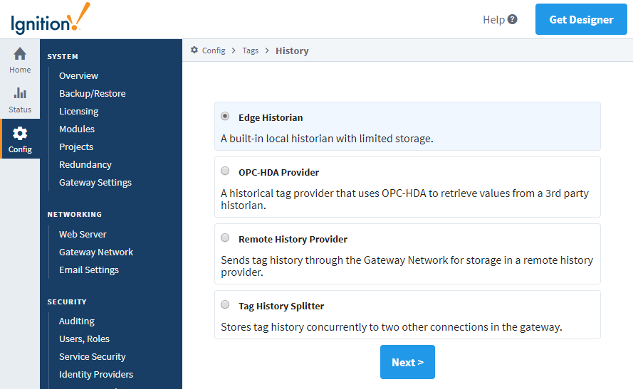

Built-In Historian
Since its release, Ignition Edge has had the ability to store tag history locally inside its internal database. This feature provided a way to visualize historical records in Edge projects without needing a separate SQL database, which was useful for the smaller devices that Edge was designed for. Version 8.0.4 brings this feature to standard Ignition Gateways.
Built-in Historian
This new built-in historian allows your Ignition Gateway to record tag history internally, without the need for a separate database installation. It works on a standard Gateway in the same way as it does on an Edge Gateway: one week of storage capacity, with the ability to synchronize the records with another Gateway with the Enterprise Administration Module (EAM).
New installations can use this feature as a means to quickly build a proof of concept for a prospective user, or be used in an impromptu demonstration — all without having to worry about installing a separate piece of software!
