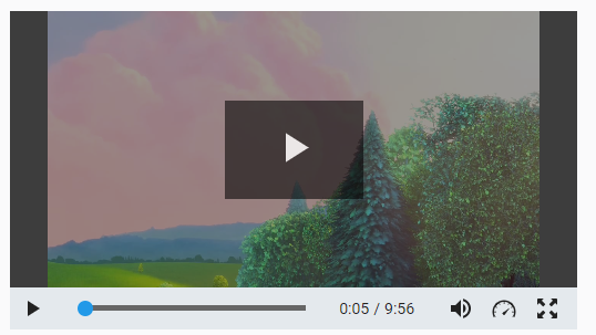

Video Player
The first component was highly requested by the community. Perspective now has a dedicated Video Player component, capable of playing hosted videos as well as streaming live feeds.
Perspective Video Player
The Video Player component has all of the common features you would expect of a video player, such as dedicated controls and variable playback speeds. In addition, the component is loaded with various status properties, signaling when the video is paused or ended, as well as various other states. This allows you to configure bindings and scripts that watch for status changes, and react in some useful way.

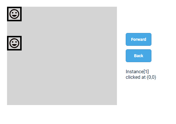

View Canvas
The View Canvas is a new component based on the Vision Template Canvas component. The component can embed one or more Embedded View instances and position them in a coordinate layout, allowing you to provide explicit XY coordinates to each instance. As with many of the other embedding components, you’re able to apply style configurations, and pass view parameters to each instance. If you’re familiar with the Flex Repeater component, imagine that but with a coordinate layout.
Additionally, the component was designed with the idea of applying CSS transitions to instances as their position properties are manipulated. So moving the instances, either by script or with a binding, will apply a smooth animation as the instance reaches its new position.
Lastly, there is a built-in onInstanceClicked event that triggers whenever an instance inside of the canvas is clicked, providing a means of knowing when the user clicks on an instance, as well as which instance was clicked.
Canvas for Perspective

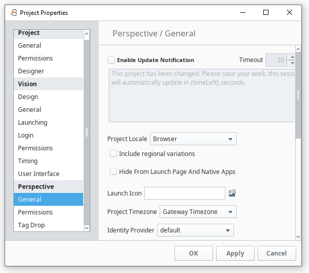

Hiding Perspective Projects from Launchers
Another short but sweet community request is the ability to hide projects from the various Perspective session launching platforms. In 8.0.6, you’ll find a new property located under Perspective General, appropriately titled “Hide From Launch Page And Native Apps”.
Hide Perspective Projects from Launchers
As the name implies, enabling this property will hide the project from the Gateway’s Perspective Launch page (under the Home section) and the project listing on the Ignition Perspective mobile app. This setting doesn’t prevent launching, so it’s a good idea to enable authentication on hidden projects to ensure unauthorized access doesn’t occur.

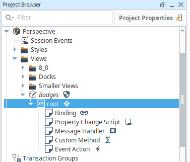

Perspective Badges
We added Project Browser badges (icons signifying some configuration) for Perspective resources, which was another community-requested feature. The icons were useful in Vision when attempting to understand how an existing window works. Being able to know which components contain scripts and bindings is helpful, especially so if the window was configured by another person.
With 8.0.6, several new badges have been introduced, continuing the trend that the Deep Selection badge started. In the image below, we see the new badges in place, located to the right of each component (and one on the “Badges” view).
Perspective Badges
Each has a tooltip to help users identify their meaning. Our hope is that this small change can help users quickly orientate themselves when looking at resources configured by other users.

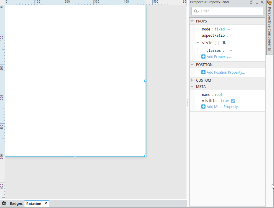

Perspective Rotation
Rotation in Perspective received an overhaul. While rotation properties have been present since the 8.0.0 release, the experience has been somewhat lacking. 8.0.6 brings some notable improvements to rotation.
First, rotation properties have migrated from Meta properties to Position properties. Upon upgrade, existing values and bindings will be migrated over to the new properties automatically, so no worries for those folks who have already started implementing rotation in their projects.
In addition, a new rotation UI has been added, making it easy to rotate components as well as set the anchor, or point of rotation, without manually typing values in the Property Editor.
Perspective rotations
