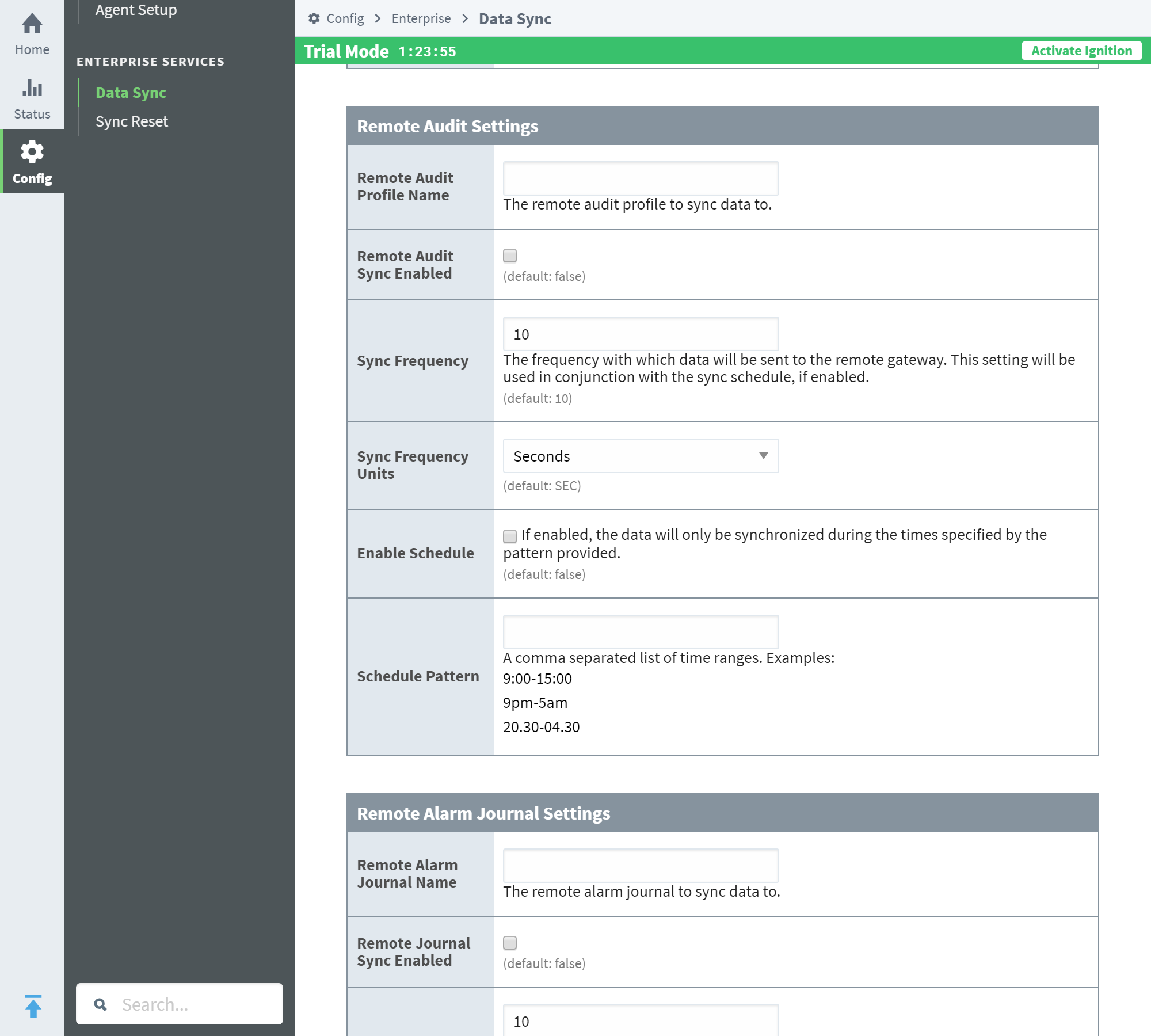

When upgrading an Edge gateway to 8.0.7, you’ll notice that the old “Tag History Sync” page is gone. In its place are two new pages: “Data Sync” and “Sync Reset.”
Ignition 8.0.7 Audit Settings
Data Sync contains the old Tag History Sync settings, in addition to new settings for Auditing and Alarm Journal sync. This allows you to configure how often synchronization triggers, as well as set a schedule for any of the sync services.
The Sync Reset page is designed to help re-synchronize the local records with the remote system’s records. The point of the page is to resynchronize the local records with those in the remote profile after a gateway restore occurs on the edge system: internal records are backed up with gateway backups, so after a restoration, you’ll most likely want to re-synchronize the local records with those stored in the remote system.
The big takeaway from this new feature is that your Edge installations can keep track of their own events for local viewing, as well as sharing them with the hub.
