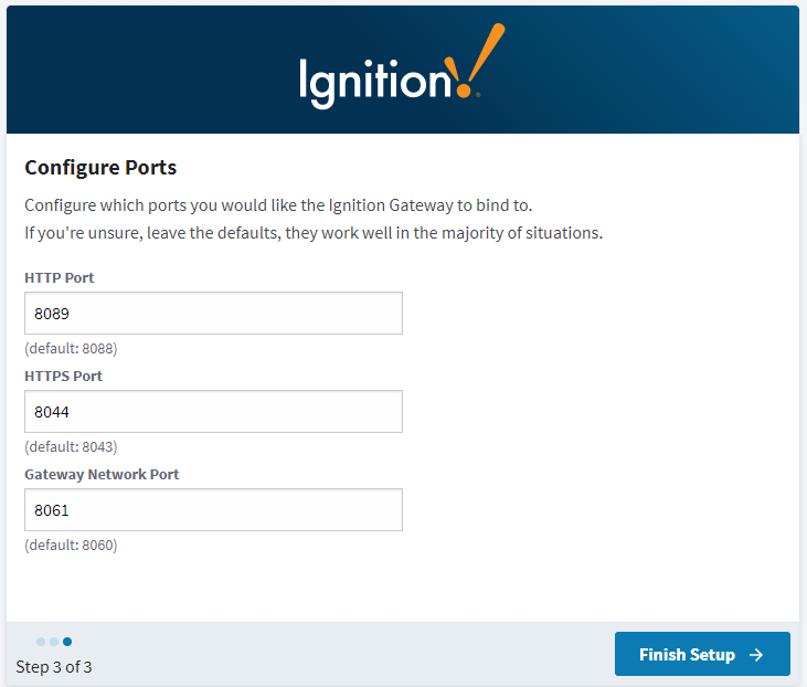

We’ve been iterating over the installation process for a while now, including commissioning — the part where your web browser opens and asks you a couple of questions, like which edition you want to install. In 8.1.1, we’ve continued this iteration by including the Gateway Network Port configuration, next to the HTTP and HTTPS ports.
Commissioning Ports
A small change, but nice if you’re deploying a system that’s going to be interacting with other gateways over the Gateway Network. The added Gateway Network Port text field here potentially saves you several clicks later on.
As part of this same effort, we did something really subtle, but quite impactful. During commissioning, we’ll try to detect if the defaults for those ports are already bound to something. If so, we’ll try again with a different port. We’ll keep doing this over and over until we find free ports for all three configurations. In the image above, the normal ports are all blocked because I have a separate gateway running on the same system, so commissioning incremented the port values for all three settings by one, and found some free ports, which I can use.
This port iteration is exciting, because it’s now easier than ever to get two Ignition systems running side-by-side on the same system. In the past, you had to muck about in some configuration files to make sure your two gateways weren’t stepping on each other's toes. But, since we’ve been adding all of these small changes to the process (such as letting you change the service name during install), you can now just run the installer twice, picking different installation directories for both (or however many gateways you want to run simultaneously). Rather nice for folks who aren’t too familiar with virtualization and containers.

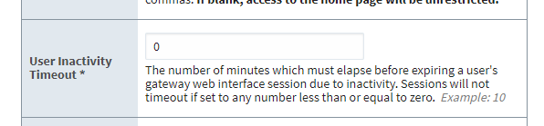

On the security side of gateway stuff, we added a gateway-level property that allows you to determine how long it takes for a user’s gateway web interface session to be closed due to inactivity. Before 8.1.1, we provided a fairly lengthy inactivity window, which some folks felt was a little on the insecure side of things (rightly so). Thus we added the new property, allowing you to determine how long that inactivity window is.
You’ll find the new setting under the gateway’s general security settings (Gateway > Config > Security > General).
User Inactivity Timeout
If you’re upgrading, we set this setting to 0 by default to maintain existing functionality, but newly installed systems will use a default of 10 minutes.

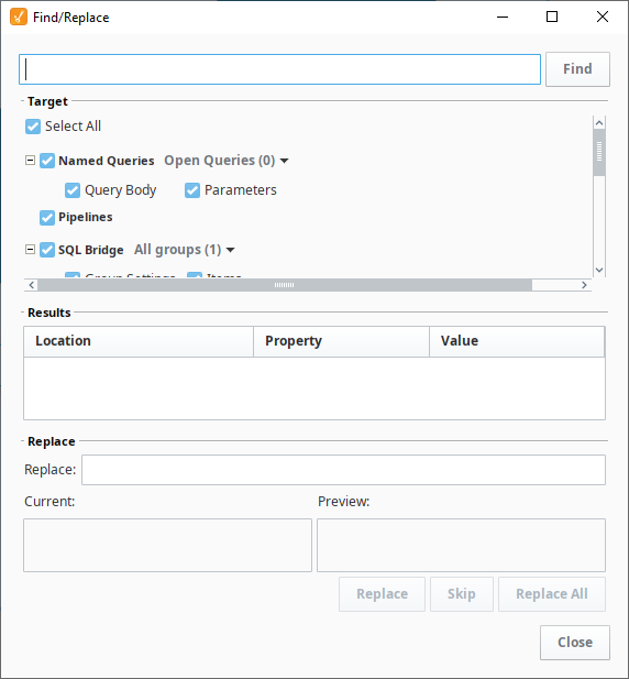

We made some further improvements to the Designer’s Find/Replace window, which can be used to search strings throughout your project and tags. Aside from a couple of bug fixes, we also added Named Queries to the selection of options, so now you can find and replace those silly parameter naming conventions your colleagues keep coming up with.
Second, we added a “select all” checkbox at the top, making it easy for you to check or uncheck every box in the window.
