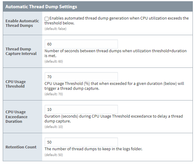

Snapshots Can Help You Get Out of a Bind
In the last release, Ignition 8.1.12, a new feature allowed you to get a thread snapshot from the diagnostic window. The thread snapshot gives you a file that you can provide to IA Support, helping to troubleshoot issues when the designer or Vision client has locked up.
In 8.1.13, that feature is coming to the gateway level. In the Gateway Settings section, you'll find a new category called Automatic Thread Dump Settings. With these settings, you can set parameters that enable the gateway to automatically take a thread snapshot when a gateway experiences an unusual CPU load due to blocked threads. You can share the file with IA Support to help troubleshoot your system’s issue.

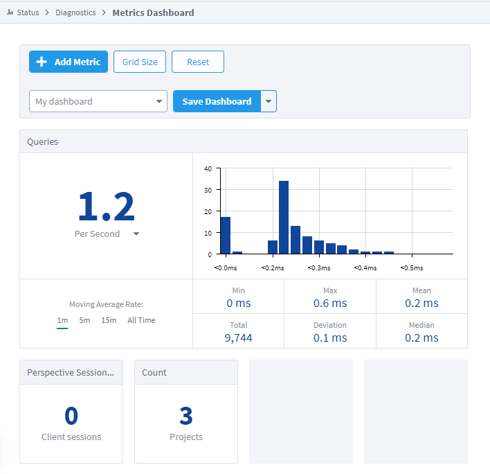

The Gateway to More Metrics
To clarify the phrase above, we’re actually giving you more metrics for your gateway. To give you a better idea of how your gateway is performing, in 8.1.13 we added a Metrics Dashboard to the Gateway Settings Section. Here you can just drag and drop from a selection of pre-defined metrics to build out a custom dashboard. Now you and IA Support can check the status of your gateway at a glance.
Metrics Dashboard

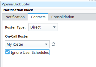

An Alarming Update
User schedules are used in alarm notification pipelines so that certain contacts get notified about alarms based on their work schedules. However, there are some instances where notifications need to be sent to contacts regardless of whether or not they are currently on the schedule.
To address this, 8.1.13 adds a “Ignore User Schedules” setting to the Contacts tab on the Notifications Blocks. When checked, the notification block will ignore the associated user schedule and notify all listed users when an alarm event happens.
Pipeline Block Editor
