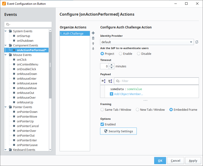

As for issuing challenges, we added two new features.
First, we added an Auth Challenge component action. In addition to triggering a challenge, the component action allows you to pass arbitrary data through a payload which can be examined after the challenge is complete.

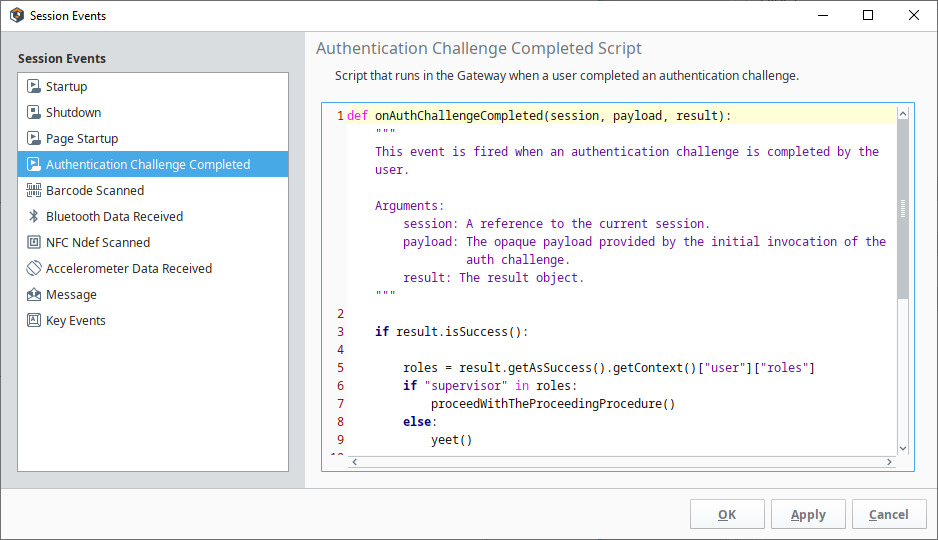

So we have ways to trigger a challenge. How do we handle the results of the challenge? That’s where another feature comes into play: the Authentication Challenge Completed session event script.
Authentication Challenge Completed Script
Here you can define what happens after the signature has been provided, as well as examine the challenger’s roles and credentials. For example, you could actually capture electronic signatures using the Perspective Signature Pad component.
