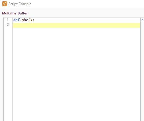

Two additional quality-of-life features are code folding and visible whitespace. Code folding gives you the ability to collapse class and function bodies in the editor, which helps you to focus on certain sections of code. Visible whitespace is particularly useful for Python. In Python, the use of indents has great significance as it defines blocks of code but keeping track of indentation within a script can sometimes be difficult. With 8.1.18, you can show whitespace by including an arrow that represents the indent, making confusing indentation errors a thing of the past.
Show Whitespace

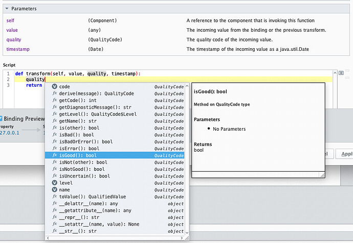

Enhance Type Completion
In 8.1.18, variable and parameter types now have type (as in, datatype) awareness. In various contexts, such as extension functions, parameter types are suggested and inserted automatically. For example, in a script transform, when you type quality, the new feature is aware of the parameter type and displays methods and properties related to QualityCode.
Autocomplete
Prior to this update, you would have to either check the results of a method passed into the function dir() or refer to the appendix section of our user manual to get the variable and parameter type information you’re looking for. Both solutions also required you to copy over the method or property from one place into the location of your script. The new feature dramatically improves the scripting workflow and saves a considerable amount of time. System functions and Python’s top-level built-in functions are currently part of the enhanced type completion. Project and Python standard library scripts are planned to follow.

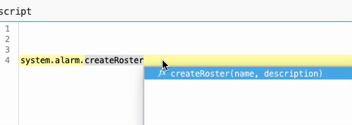

Parameter Completion
Along the same vein of enhanced type completion, the new script editor offers parameter completion assistance. When the feature is enabled, it presents a list of functions based on what you have entered in the script editor.
Parameter Completion Assistance
Once you select a function, all associated parameters are automatically filled into the current line. As you tab through each parameter, you’ll see dedicated tooltips that provide a brief description of that parameter. This new feature aims to improve your quality of life and development speed.

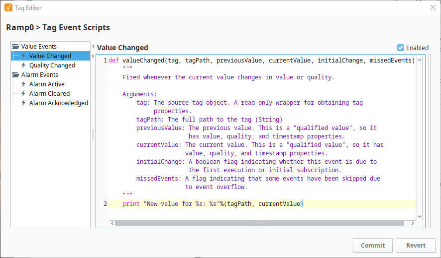

In addition to the Autocomplete, our development team revisited the docstring in the script editor window. Those who have worked in the scripting window are familiar with the purple text that outlines argument functionality, but unfortunately the text took up a lot of space and couldn’t be removed or edited, which could sometimes cause confusion for new users.
Pre-8.1.18 Tag Script Editor
Tag Event Script editor, prior to 8.1.18

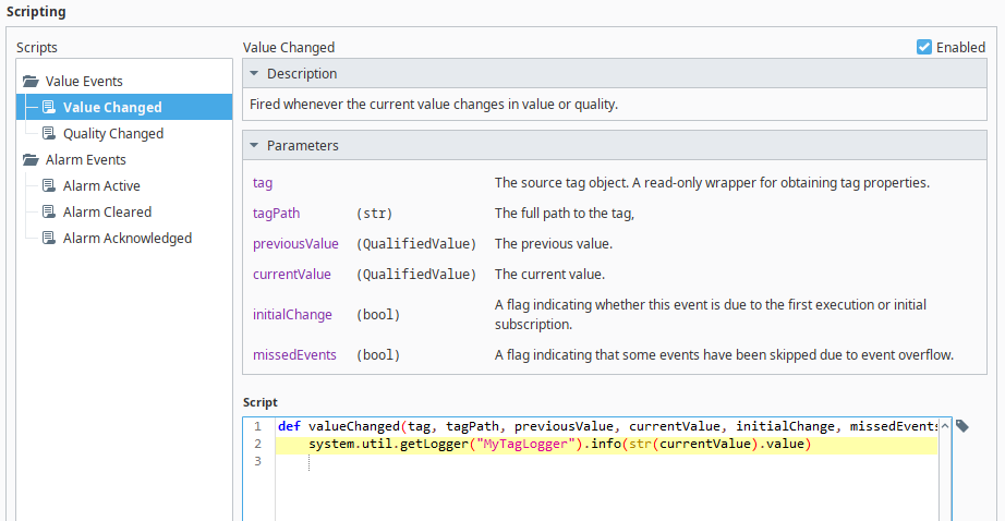

In 8.1.18, we’ve removed the docstring from the script editor window and given a dedicated, collapsible panel in the interface. The script editor is now free of that purple text, improving clarity and giving you more space to work with.
Tag Event Script editor in 8.1.18

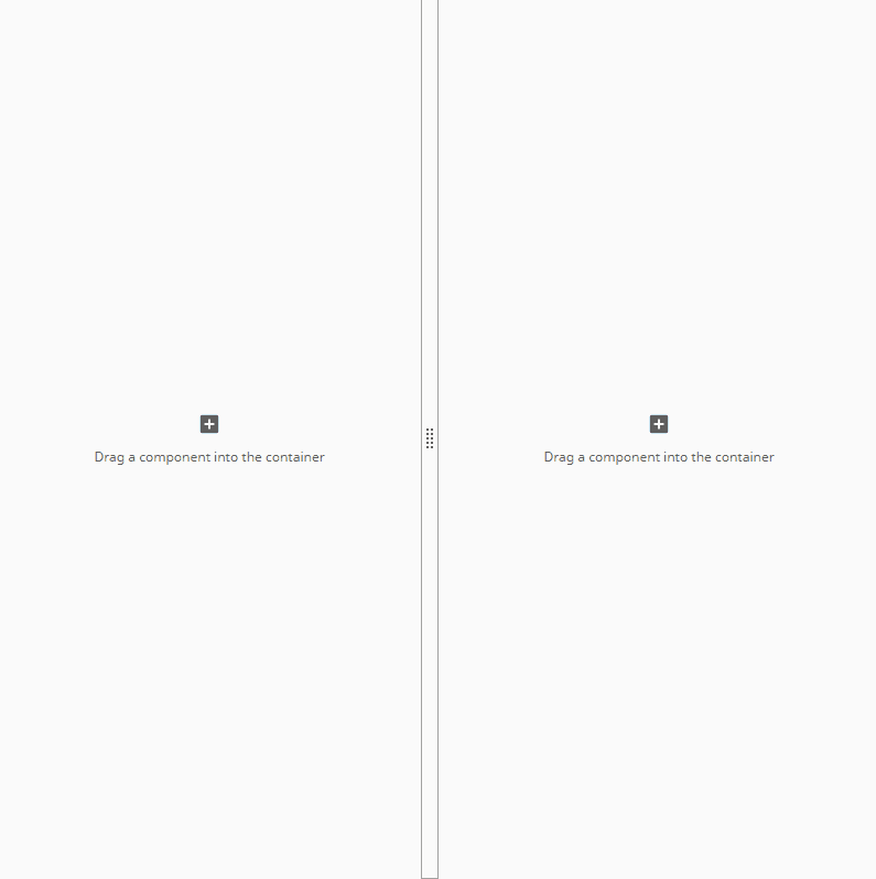

A New Container
Perspective is getting a new container component called the Split Container. This new container is ideal for data-dense screens. As the name suggests, the container is split into two sections divided by a user-adjustable slider. The container can be oriented either horizontally or vertically, and items in either section of the container can be resized depending on the placement of the slider.
Split Container
