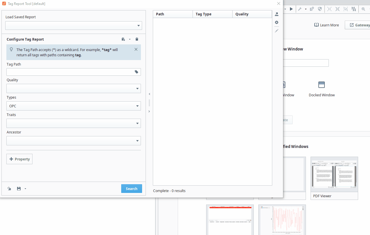

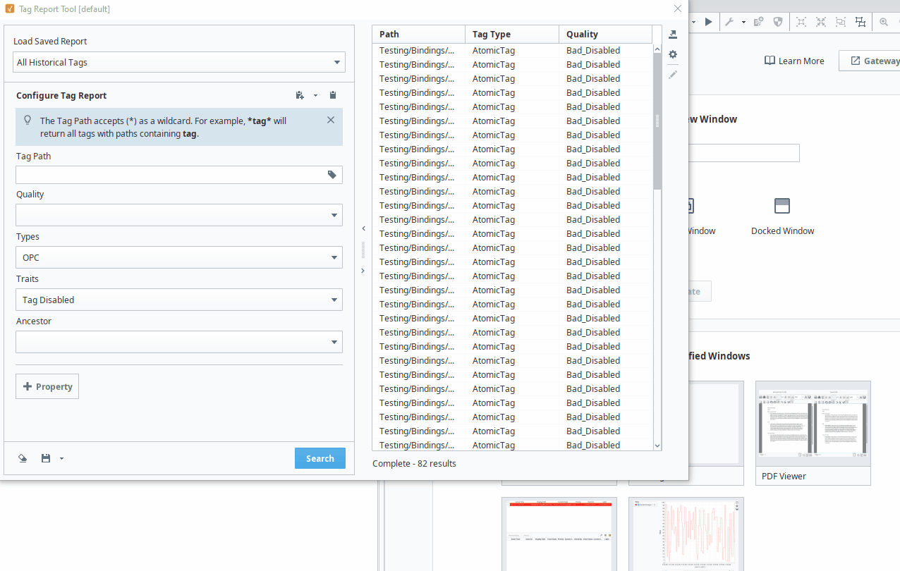

With Ignition 8.1.19, we are happy to announce the addition of the Tag Report Tool. When you open the Tag Report Tool from the Tag Browser, a new UI will appear. Here you will be able to quickly build queries that can search for specific tags based on its Tag Path, Quality, Types, Traits, Ancestor, and other properties. Once you have defined the parameters for a specific tag search, you are then able to save that query for later use as well as generate a CSV export of the search results.
![Editing, Saving, and Loading Tag Report Tool queries](/blog/sites/default/files/inline-images/image1_4.gif)
This gif demonstrates the Editing, Saving, and Loading Tag Report Tool queries.
![Saving Tag Report Tool search results into a CSV file](/blog/sites/default/files/inline-images/image2.gif)
This gif demonstrates saving Tag Report Tool search results into a CSV file.

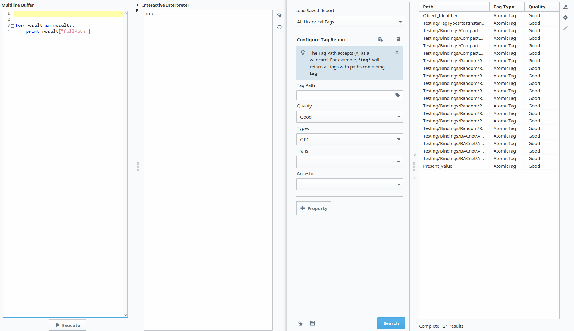

You can also perform the tag search via a scripting function system.tag.query(). The results from this scripting function will be the same as the Tag Report Tool, but in the form of a list of dictionaries that define each tag result. Additionally, all tag queries can be copied from the Tag Report Tool UI and translated into Python syntax for quicker script use.

This gif demonstrates converting a search query from the Tag Report Tool into a runnable Python script.
The Tag Reporting Tool and the new scripting function will definitely save you time when you need to search for certain tags within a large Ignition implementation.
