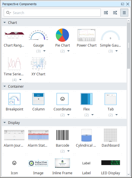

The Perspective Component Panel received a few changes. First, instead of the old list view, components can display visual representations of the components, as opposed to the old list representation.
Perspective Components - Panel Full
The main benefit here is that the components have a more distinct look in the panel. Furthermore, they give you a better idea of what the component is, which should help newer folks find their way through Perspective’s component library.
If you’re a fan of the old list view, then no worries! You can switch to the old style with the toggle in the upper right corner of the panel.

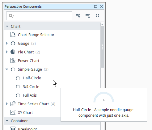

In addition, we added some component variants to the panel. If you drag a variant into a container, the resulting component will inherit some predefined property changes. This allows your newly created component to be preconfigured in some way.
For example, the Half-Circle gauge shown above is the “default” gauge you can create today, whereas ¾ Circle and Full Axis have their startAngle and endAngle properties preset to different values. So if you’re looking for a gauge component that’s already set to a ¾ circle, you can use the variant instead of modifying the startAngle and endAngle properties yourself, saving you a little time.

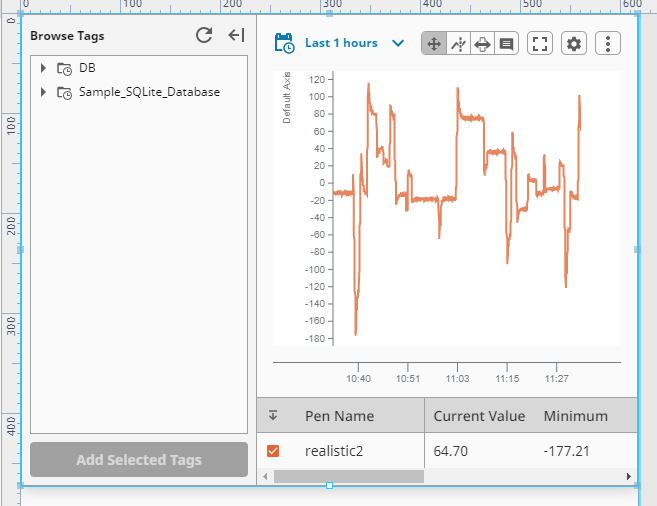

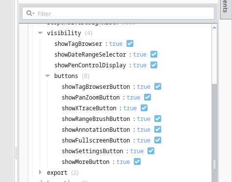

A user request we received after the Power Chart’s introduction was to remove some of those interactive elements. Meaning, give the chart a way to hide those ancillary panels and buttons. So we added a whole set of visibility properties to the component that allow you to make the Power Chart a simple chart with no user-driven interactions.
Visibility Properties
Instead of having all of those elements on display at all times …
Browse Tags - All
… you can have a clean chart with no interactive elements, perfect for dashboards and other displays that aren’t meant to receive user input.

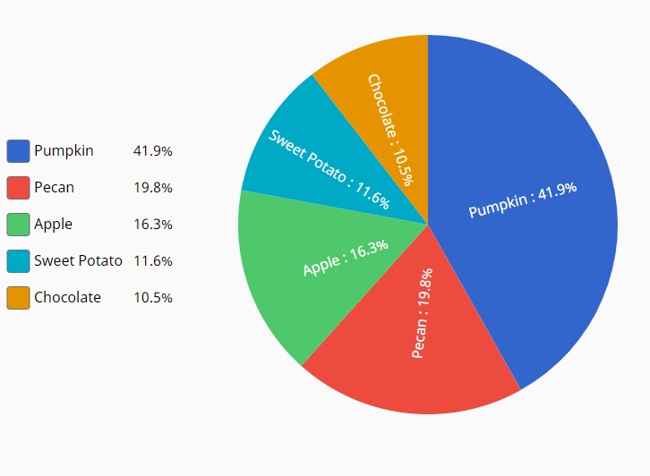

The Pie Chart component received two new sets of properties. First would be the labels.inside set of properties, which allow you to put labels inside the pie wedges instead of always showing them outside of the wedge. In addition, there are some formatting properties that allow you to further change the appearance of the label.
Aside from that, the component now has a set of legend properties that allow you to customize the legend. For example, now you can reposition the label to the side of the chart, instead of using the default position below the pie.
