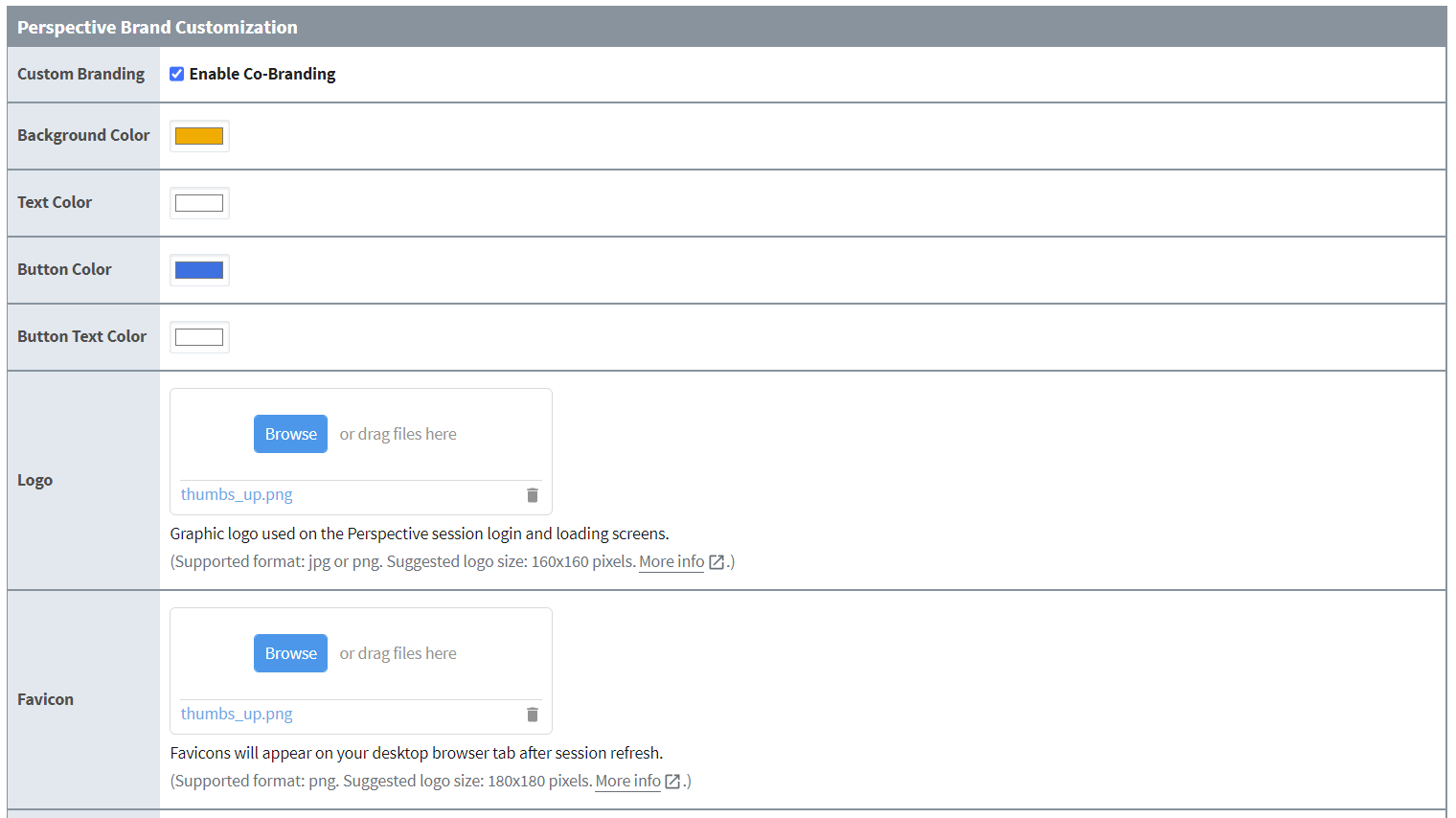

Our community has been asking for ways to bring more customization to the look and feel of their Ignition projects. We listened and we’re excited to introduce a new feature that allows you to co-brand your Perspective projects.

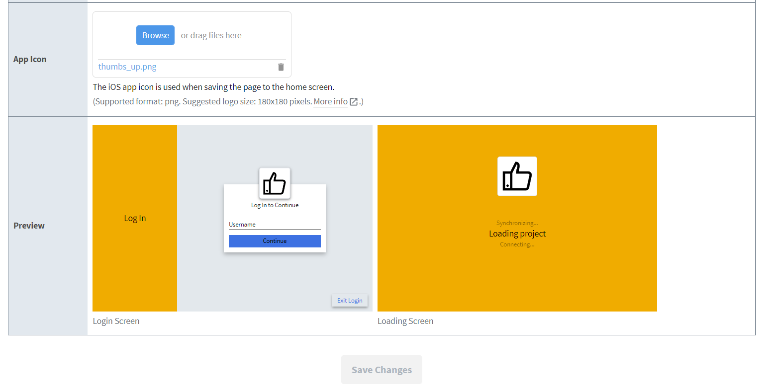

In Ignition 8.1.20, you can now customize many parts of your project, including logos, favicons, background colors, buttons, text, the Perspective loading screen, and the internal IdP pages (a.k.a. login screen). You can also customize the color on the banner located on the Session Status > Gateway popup.
Co-Branding
Co-Branded IdP

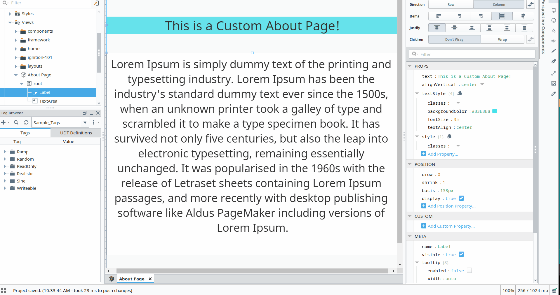

Lastly, you can customize the About button and the About popup with a user-defined view path. If you have your own content for the About section you can specify a path to that location.
About
About Popup
