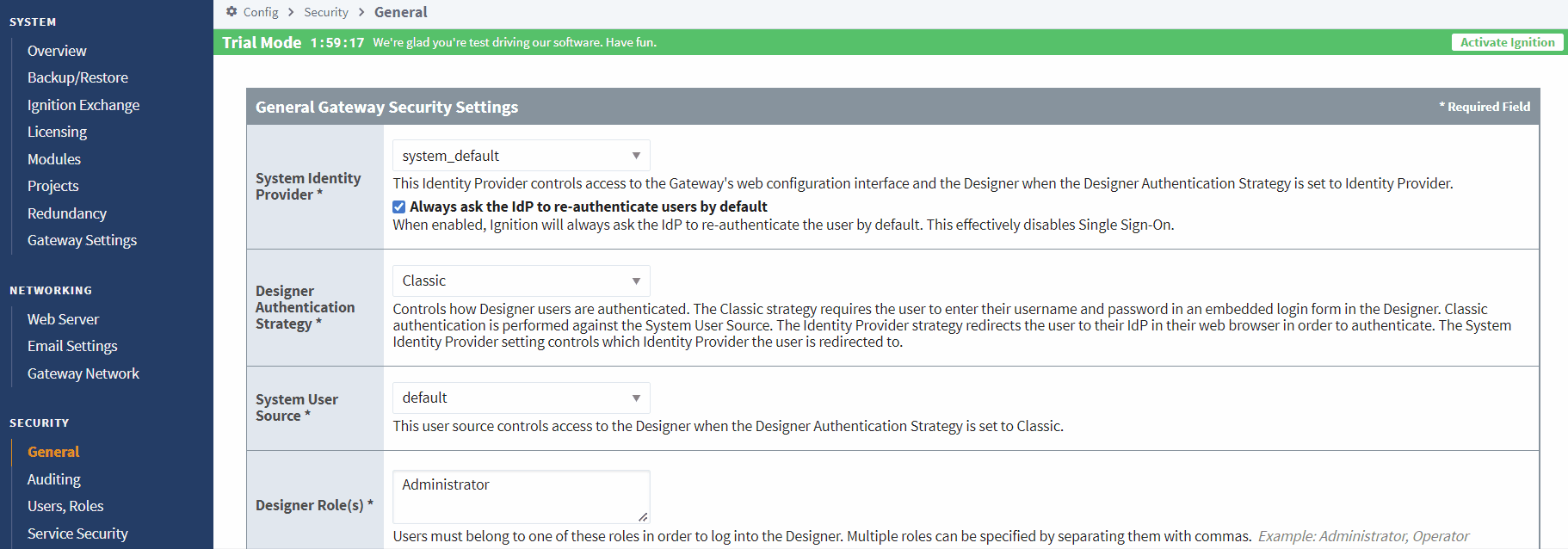

Auth Tokens
Let’s start with a solution to a pain point that has frustrated many an integrator. Before 8.1.24, when a session temporarily lost communication to the gateway, all IdP-authenticated Designer and Vision Client instances would need to be restarted so that users could log back in.
8.1.24 fixes this problem with auth tokens. Now, logging into the IdP generates a special auth token with the session on the gateway. This token is then saved in the Designer or Vision Client instance memory after successful IdP authentication. In the case of an interrupted connection, Designer or Vision Client instances can pass the valid auth token to the gateway and securely reconnect.
![Auth Token](/blog/sites/default/files/inline-images/Auth%20Token.gif)
The lifecycle of an auth token can be controlled in two ways.
The first option is Designer Auth Token Inactivity Timeout, which defines the number of minutes that must elapse during disconnection before the auth token expires. Inactivity Timeout must be greater than zero, with the default set to 10 minutes.
The second option is Designer Auth Token Time-To-Live (TTL). This setting defines the maximum number of minutes the auth token exists regardless of connectivity. If TTL is set to any number less than or equal to zero, the auth token does not expire except from inactivity. The TTL default is set to 0 minutes, meaning it does not expire.

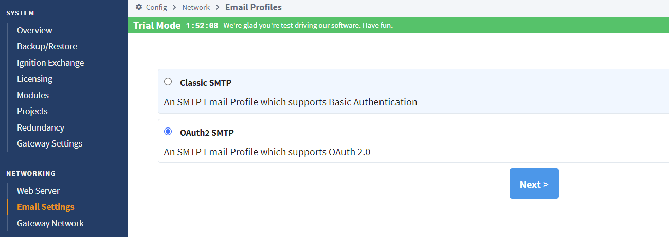

OAuth2 SMTP
Security is a constantly evolving beast and taming it requires modern standards and techniques. These days, something as tried and true as the username/password combo is often not secure enough. Some servers no longer support Classic SMTP with only username and password authentication.
With that in mind, 8.1.24 refactors “SMTP Profiles” into “Email Profiles.” The Email Profiles give the option of choosing either Classic SMTP, which supports basic authentication, or OAuth2 SMTP, which, true to its name, supports OAuth 2.0.
![Email Profiles](/blog/sites/default/files/inline-images/Email%20Profiles.png)

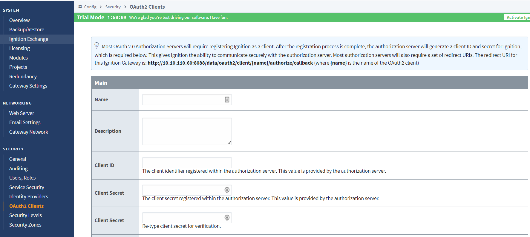

8.1.24 also adds OAuth2 Clients, which can be managed in the gateway config page. OAuth2 Clients use auth tokens, similar to the Designer and Vision Clients mentioned above, to securely request SMTP to send email events.
![OAuth2 Clients](/blog/sites/default/files/inline-images/OAuth2%20Clients.png)

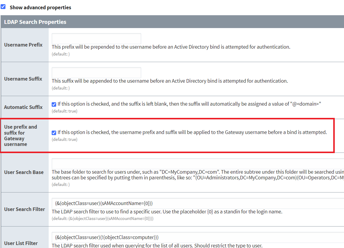

Username Prefix & Suffix
A customer-requested feature adds a new checkbox option in the LDAP Search Properties for toggling username prefix and suffix to all three Active Directory user source profiles. If marked as true, this setting applies prefix and suffix to the gateway username before a bind is attempted. Naturally, this option defaults to true on upgrade to match the behavior before the upgrade. It’s also worth mentioning that 8.1.24 removes the strict validation for gateway username setting so that =, ,, and other characters are now allowed.

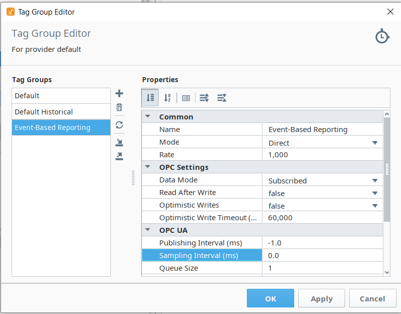

Ignition puts a premium on configurability, not just within the platform itself, but also with how it interacts with outside hardware and protocols. To better adapt to systems subscribing to BACnet or DNP3-supported devices, Ignition 8.1.24 has a new Tag Group OPC UA extension property that allows the Sampling Interval to be requested independently of the Tag Group Rate.
If the Sample Interval is set to 0, instead of Tag Group polling, event-based or report-by-exception changes will come directly from the device. For certain devices or system architectures, this method reduces unnecessary sampling to save additional overhead.
![OPC UA Event-Based Changes](/blog/sites/default/files/inline-images/OPC%20UA%20Event-Based.png)

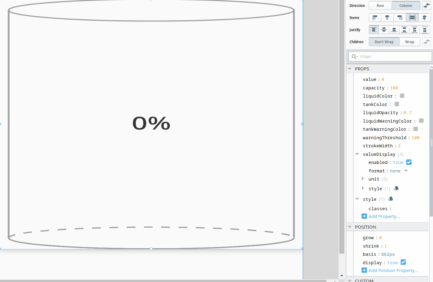

Cylindrical Tank
First up is the Cylindrical Tank component, which now has new format and unit display properties. The format property gives the option to display a value as an integer, percent, or currency, the latter option finally delivering a method for putting the whole “time = money” philosophy into practice.
The unit property can then append a chosen string to the front or back for further customization. For example, if you had a thousand-gallon tank, you could choose “integer” for your format, then enable the unit property and simply enter “/ 1000” to display an exact volume for the tank.

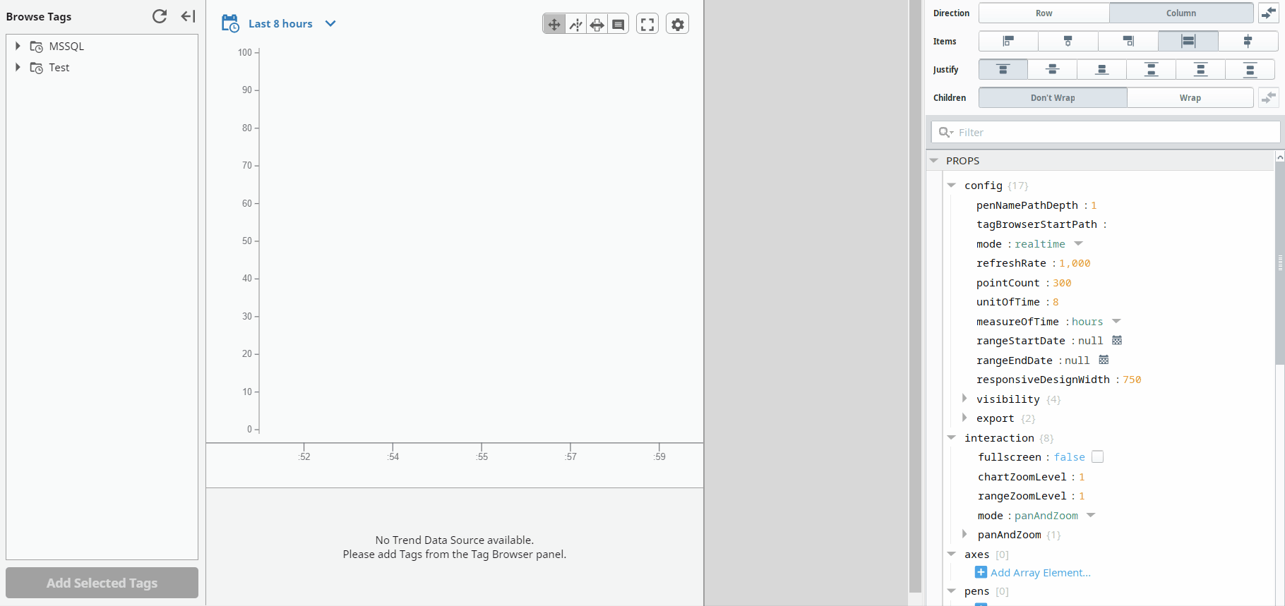

Power Chart
The Power Chart component now has an additional config option, penNamePathDepth, that can display an expanded tag path. When this option is set to 1, only the tag name will appear. However, the higher the number is set, the further back the tag path will display, all the way to the gateway. For example, setting penNamePathDepth to 3 would appear as grandParentFolder/parentFolder/name. This option is a great method for visualizing an individual tag path that is both precise and immediate.
![penNamePathDepth](/blog/sites/default/files/inline-images/penNamePathDepth.gif)

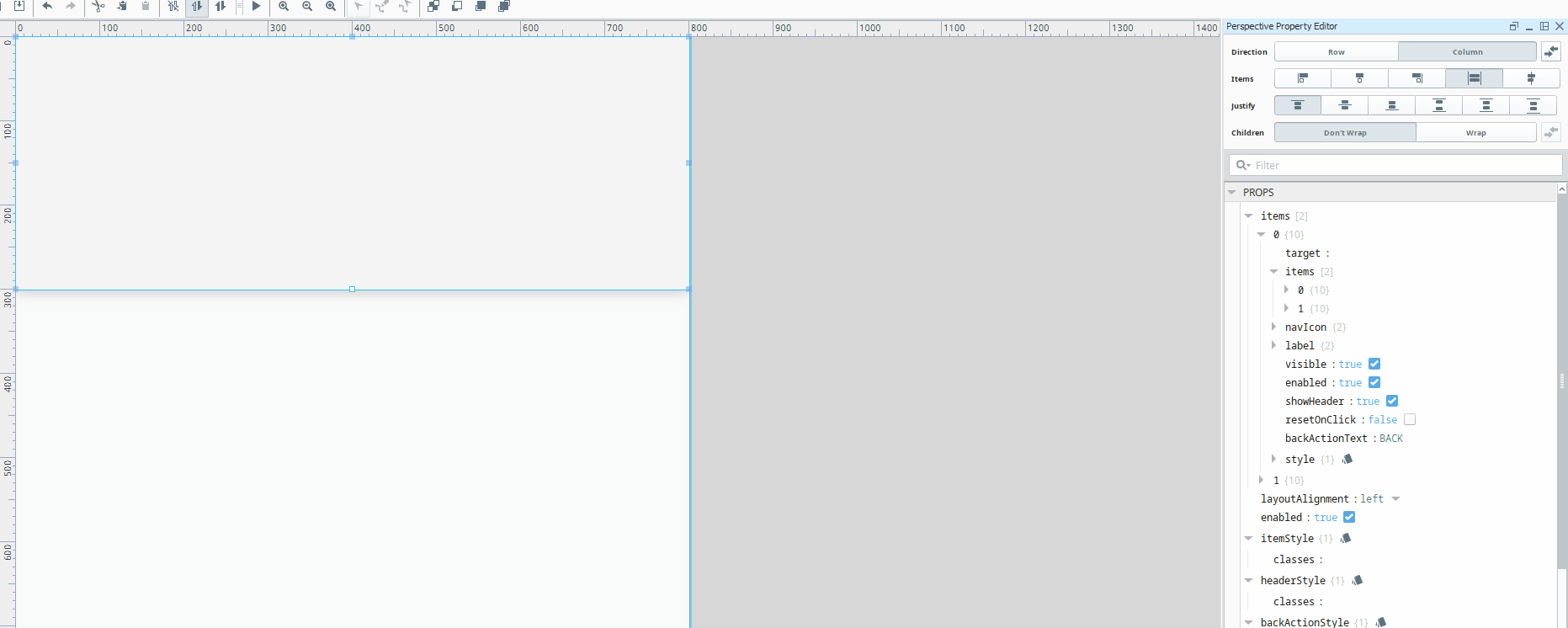

Menu Tree
The Menu Tree component’s "backActionText" root now acts as the default back button for all levels of menu items. Individual sub menus can then override this text with their own "backActionText" configuration property. As exemplified in the GIF below, this update provides more clarity when backtracking through heavily nested menus.
![backActionText](/blog/sites/default/files/inline-images/backActionText.gif)

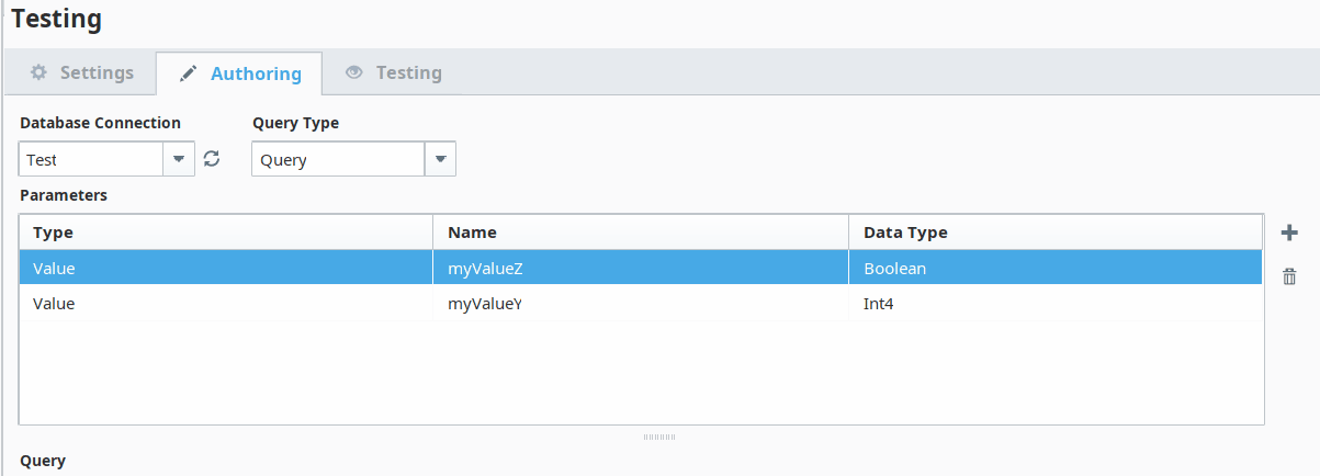

8.1.24 now automatically commits any changes made in the Named Query Authoring tab when you switch to another tab. This change provides a quicker, more user-friendly experience when testing out queries. All you need to do is edit your parameter and switch tabs. No more forgetting to press Enter, and no more double-checking.

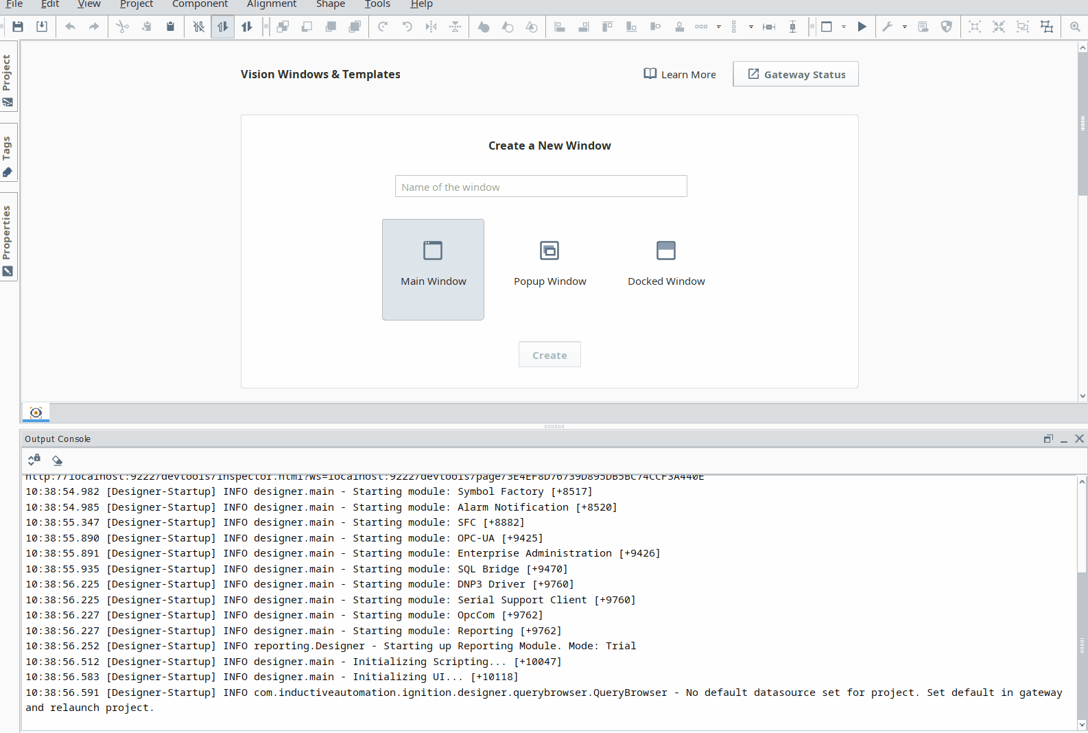

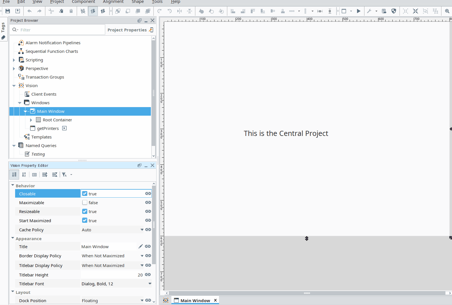

A double portion of delicious side dishes comes from the Designer edit menu, which gets some expanded functionality and can now be used against Output Console messages as well as Vision Property Editor fields. Previously, tediously, frustratingly, these tasks were not possible. Now, simply highlight the desired value or input, click Edit from the top menu, select Copy, and paste into a new window.
![Copy to Output Console](/blog/sites/default/files/inline-images/Copy%20to%20Output%20Console.gif)
![Copy to Vision Property Editor](/blog/sites/default/files/inline-images/Copy%20to%20Vision%20Property%20Editor.gif)
