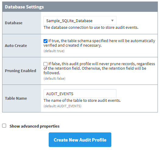

Audit Profile Pruning Change
We made a small but significant change to how audit profiles behave. In the past, audit profiles would always prune (i.e., delete) records based on their Retention setting. While you could set Retention to 0 days to disable pruning, we found that a fair number of users never realized this, which is understandable. So we added a new “Pruning Enabled” setting to Database Audit Profiles that explicitly enables pruning, which you’ll see below.
Prune Setting
Pruning On Upgrade
Note that the default value for the new setting is “false”, meaning the gateway won’t prune any records initially on new audit profiles. However this also applies to existing gateways that upgrade to 8.1.3+. After upgrading to 8.1.3+, records in database audit profiles will no longer prune any records unless you enable the new setting.
This is a fairly significant change to existing systems, as you’ll need to make a configuration change after upgrading. However we found many users would prefer if the audit profile did not prune records automatically, so this change in behavior is seen as favorable in some cases. Especially for those users in heavily regulated industries where audit trails are mandatory.

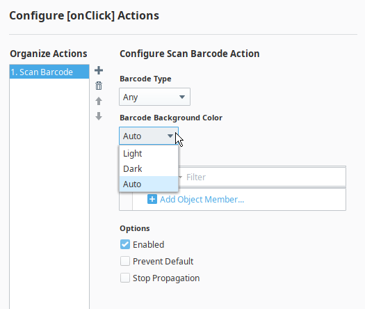

Scan Barcode Action Background Color
The Perspective Module’s Scan Barcode action can now read barcodes that have a darker background. Furthermore, the action received a new setting that lets you specify the background color of the barcode in case the default “Auto” option is having trouble doing it automatically.
Scan Barcode Settings

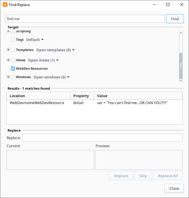

Added Web Dev to Designer’s Find/Replace
The Designer’s Find/Replace window can now search through Web Dev resources. Note that it does search through each of the various HTTP Methods for Python Resources, making searching through all of your Web Dev resources a breeze.
Web Dev Resources Find Replace
