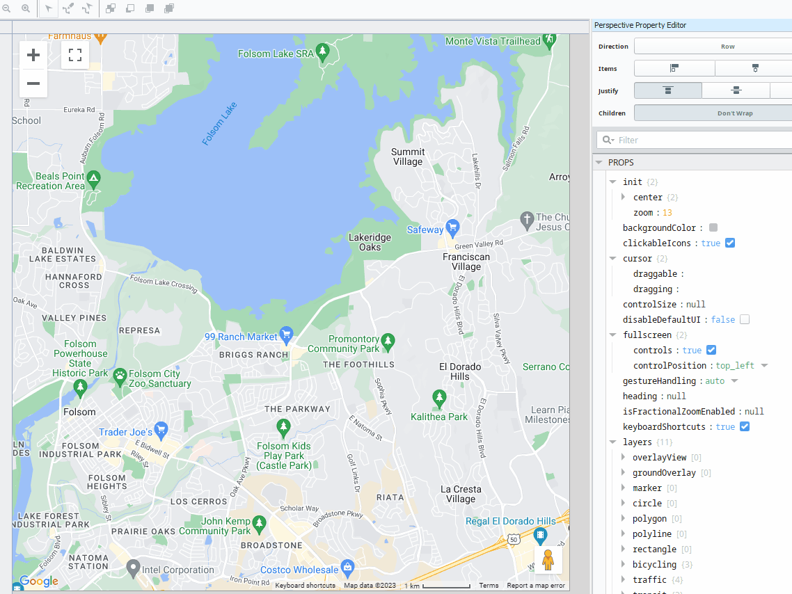

Google Map Component

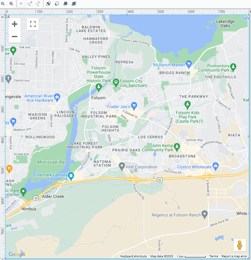

Ignition 8.1.33 adds a brand-new, brand-name Google Map Component to Perspective. This first-party component offers some additional features compared to the existing Map Component. It possesses a more sophisticated — and scriptable — interaction event model as well as allowing you to create layers of Markers, OverlayViews, Ground Overlays, KML (Keyhole Markup Language), Traffic, Transit, Bicycle, and Polygons (Circles, Rectangles, Polylines, and Polygons).
The Google Map Component utilizes tiles to easily slot into existing views and provide improved flexibility. That said, one thing to keep in mind is that while the existing Map Component is based on the Leaflet open-source JavaScript library, the new Google Map Component requires both an internet connection and a Google API key.
Basic Map Interaction:
Adding/Editing a Circle Layer:
Circle Layer

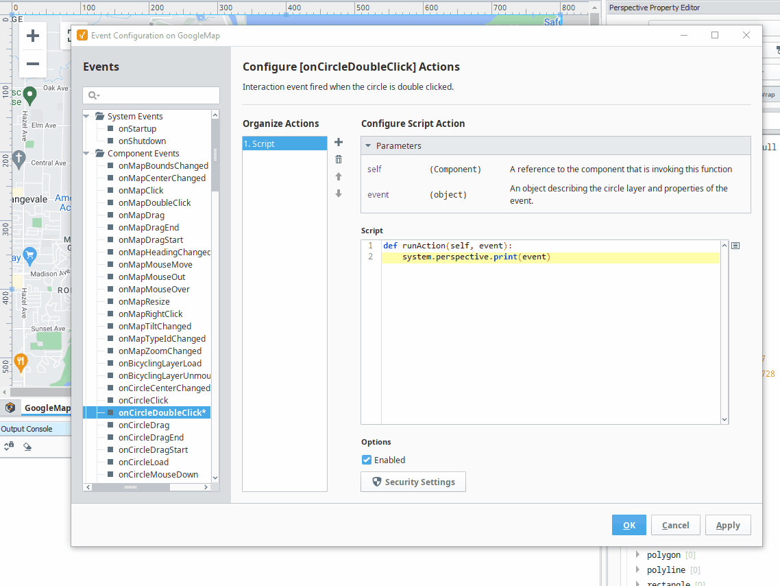

Basic Script Example:
Script Example

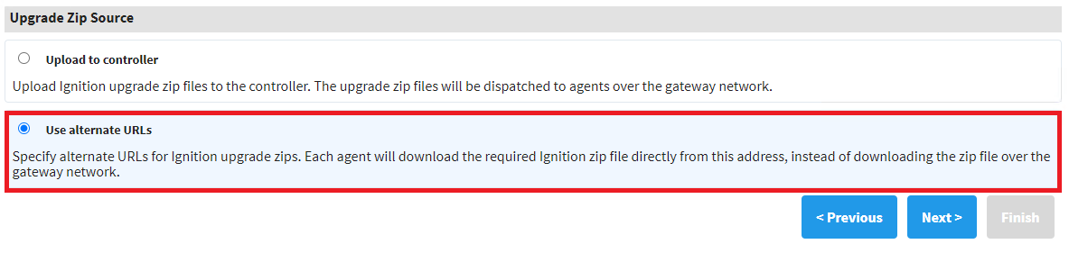

First, the EAM Remote Upgrade prep task can now specify a URL that points to an Ignition upgrade zip file, which will be downloaded directly by agents as opposed to passing through the gateway network.
EAM Alt URL

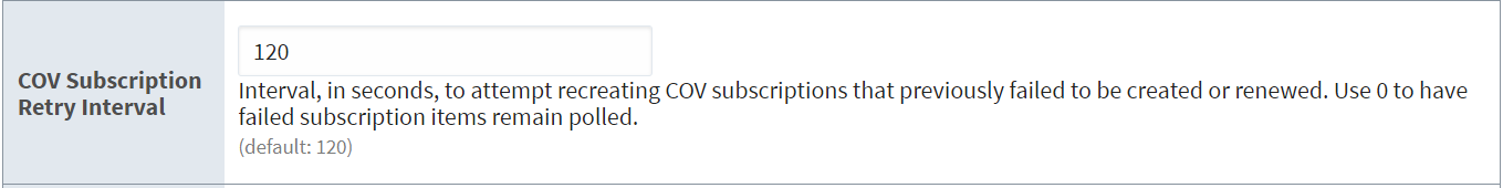

A periodic background task for the BACnet Driver will now attempt to recreate previously failed COV subscriptions. The task rate can be adjusted via the newly added COV Subscription Retry Interval setting.
COV Sub Retry Interval

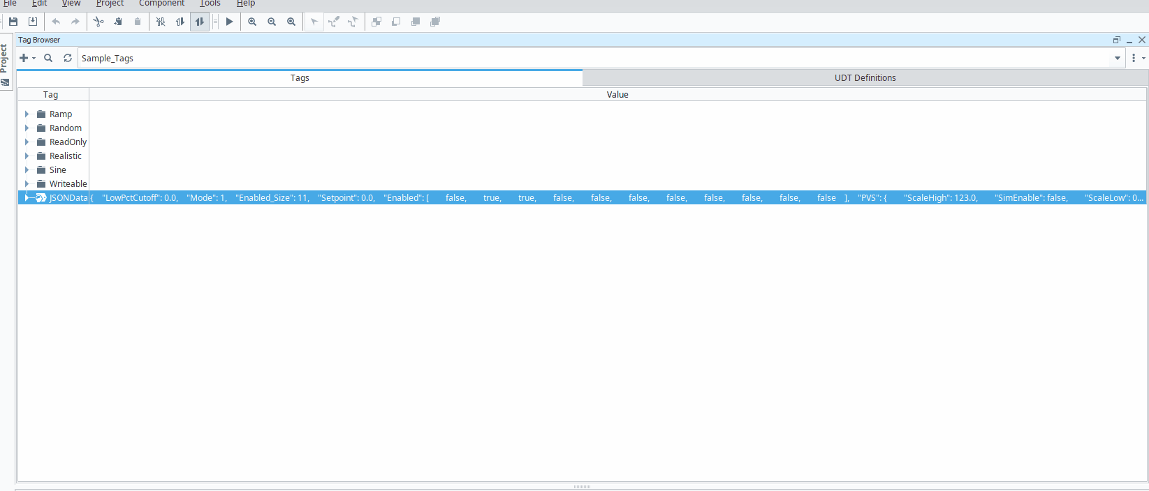

Tags & UDTs
You can now use JSON array coercion for array types and leverage methods such as jsonGet in array-typed derived tags to fetch nested elements of JSON documents in dependent tags.
JSON
