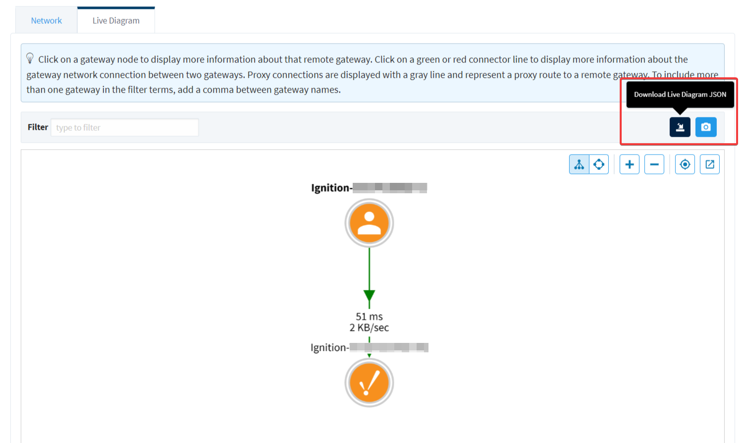

Gateway Network Diagram
Ignition’s Gateway Network Diagram provides a quick way to see how your Gateway Network is laid out. Previously the only way to share this diagram with someone else was to take a screenshot, which had its limitations (such as blurry visuals when there were more than 30 Gateways).
With 8.1.38, however, users can export the Gateway Network Diagram with a new “Download Live Diagram JSON” button, creating a JSON file that is viewable on Kindling. And since this JSON file isn’t static, the viewer can customize what they see in the diagram by filtering Gateways.
Another handy update is that the Diagnostics Bundle now includes this same Gateway Network Diagram file. So you get easy access to it, along with other useful metrics files that look at the status of the Gateway, all wrapped up in one convenient zipped export.

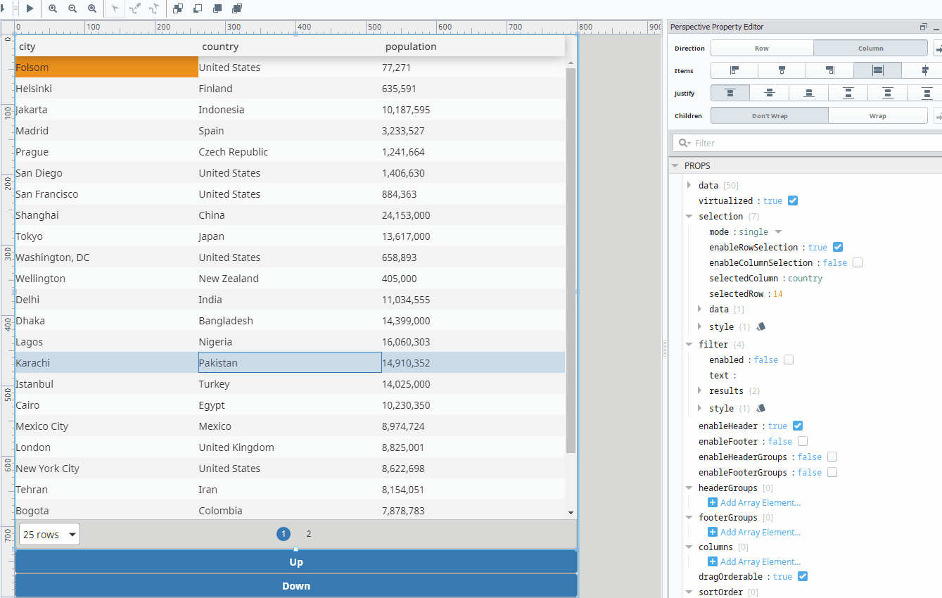

Perspective Table Component Improvement
A 2023 Ignition Community Conference attendee requested this quality-of-life Perspective update, which enables the Table Component to page and scroll to a selected target when either the selectedRow or selectedColumn properties are changed by an external source (as opposed to through direct user interaction).
