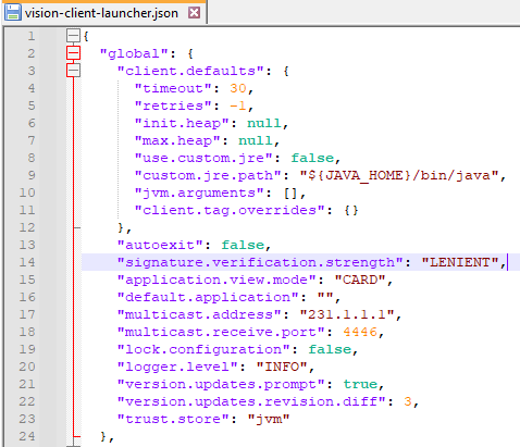

Launcher Signature Verification Options
8.1.40 offers you greater control over an important security measure by adding two new signature.verification.strength options for the Designer Launcher and Vision Client Launcher:
- AIR_GAPPED: no revocation checks performed and disallow older Gateways
- LOOSE: no revocation checks and allow legacy Gateways
Currently, the default option is still set to “LENIENT: soft fail on revocation checks and allow legacy Gateways.” The AIR-GAPPED and LOOSE options were added for users who need more flexibility with signature verification checks in cases when OCSP servers shouldn't be communicated with.
![Launcher Signature Verification Options](/blog/sites/default/files/inline-images/Launcher%20Signature%20Verification%20Options.png)
If you have air-gapped machines, for example, you may decide you don’t want super strict checks when downloading a Vision Client Launcher or a Designer Launcher onto your server machines (since your machines aren’t open to external network traffic). In this type of situation, the AIR_GAPPED or LOOSE signature verification strength options may better suit your needs.

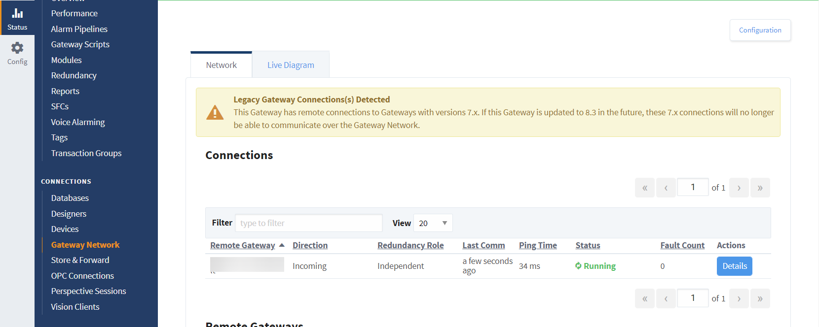

Gateway Network
We added a remote Gateway platform version to the Gateway Network status page, which will give users a warning when legacy (7.x) Gateways are detected.
![Gateway Network](/blog/sites/default/files/inline-images/Gateway%20Network.png)
With this update you’ll be able to easily view which remote Gateways are still running 7.9. This is especially helpful with Ignition 8.3’s release approaching, because 7.9 Gateways won’t be able to communicate with 8.3 Gateways.
If you’re still using Ignition 7.9, we highly recommend that you upgrade to 8.1 since it has many powerful features and several years of support ahead of it. For guidance on making this transition, check out the 7.9 to 8.1 Upgrade Guide.

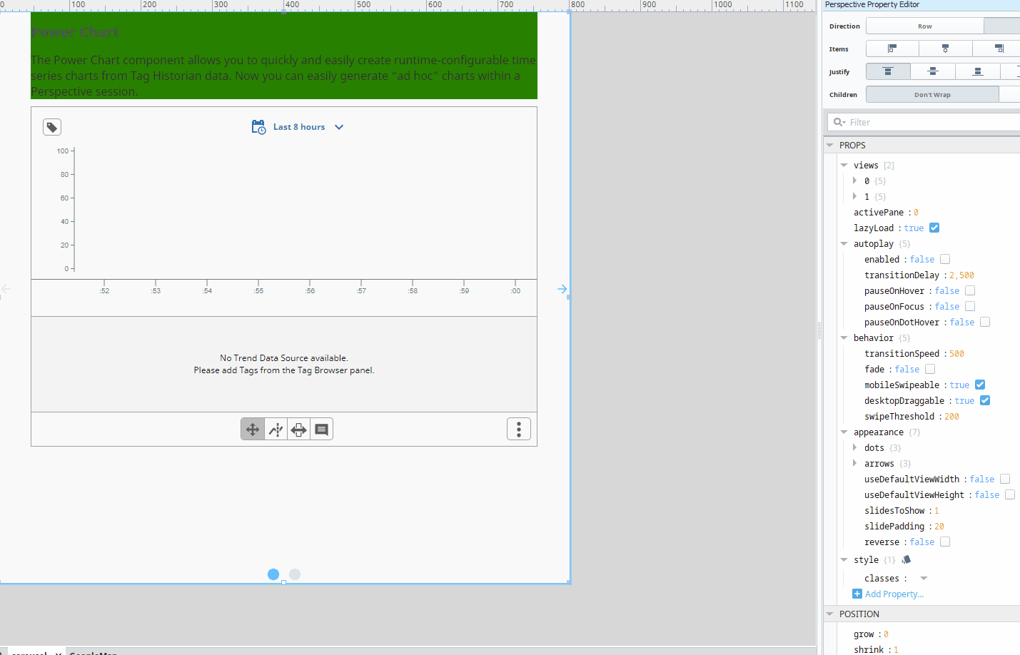

Perspective Carousel Swipe Threshold
We added a new swipeThreshold property to Perspective’s Carousel Component.
Previously, the carousel swipe threshold was set to 50% of a component’s width (meaning once you reached the halfway point of a view you’d automatically swipe to the next one). This threshold was unconfigurable.
But now you can customize that break point value to whatever suits your preferences or functions most naturally for your devices. This new capability will be especially helpful for tailoring the user experience on mobile devices.
![Perspective Carousel Swipe Threshold](/blog/sites/default/files/inline-images/Perspective%20Carousel%20Swipe%20Threshold.gif)
Additionally, to help improve user experience, we’ve adjusted the default value of the swipe threshold to 200px, with a minimum value of 50px allowed.
