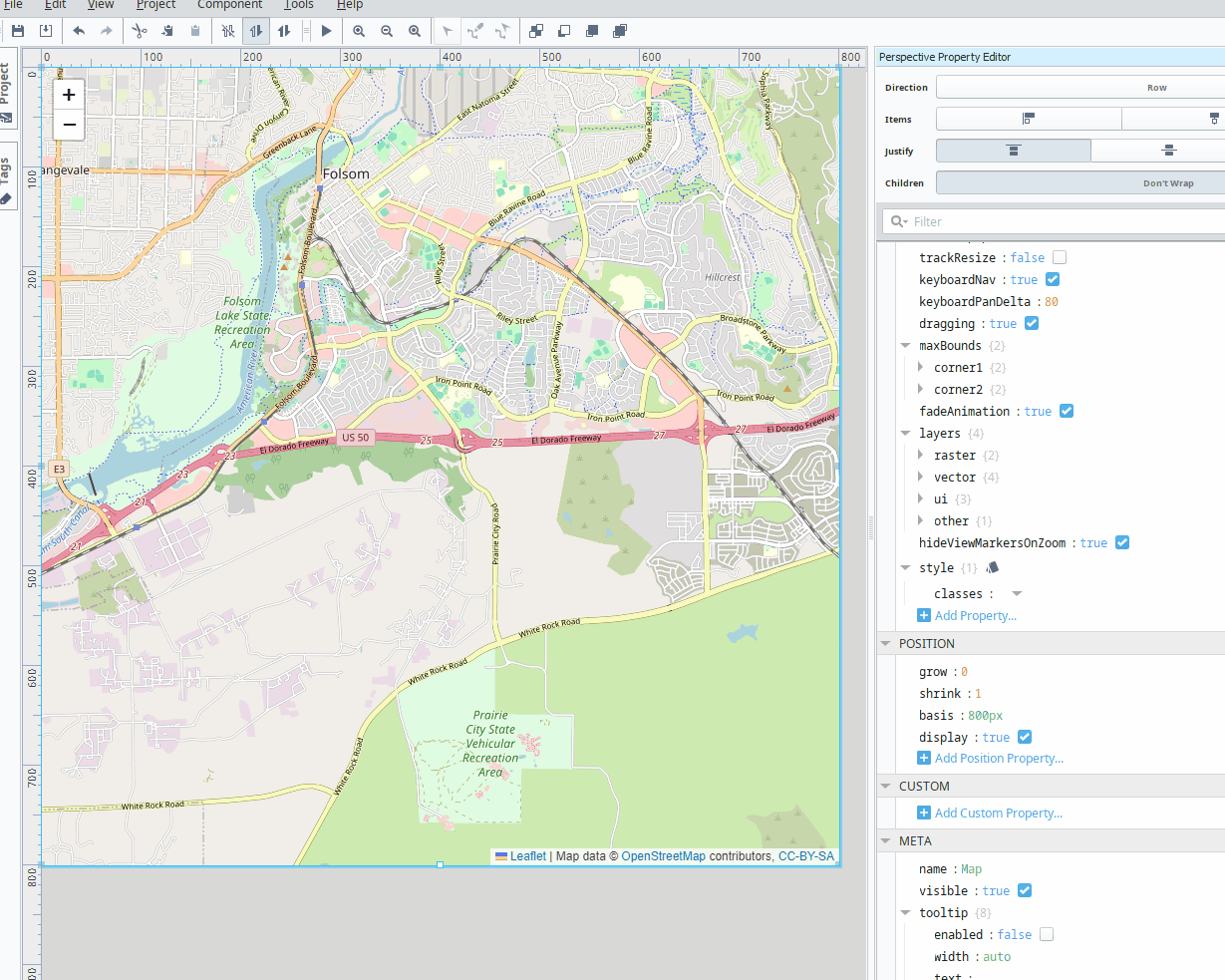

Perspective Map Component
A new user-requested feature in Perspective’s Map Component makes it easier to customize the colors and overall look of your maps to suit your exact preferences.
We’ve added a new className string property in styleOptions for the Perspective Map Component’s geoJson feature layers. This will enable your project to recognize additional CSS configurations defined in different style sheets elsewhere. Now when you add in a new styleOptions object you’ll be able to use the handy className property to add in a CSS configuration.
A couple tips:
  • The class name has to be a string
  • To include Perspective style classes, prefix them with “psc-”
Perspective Map Component Customization

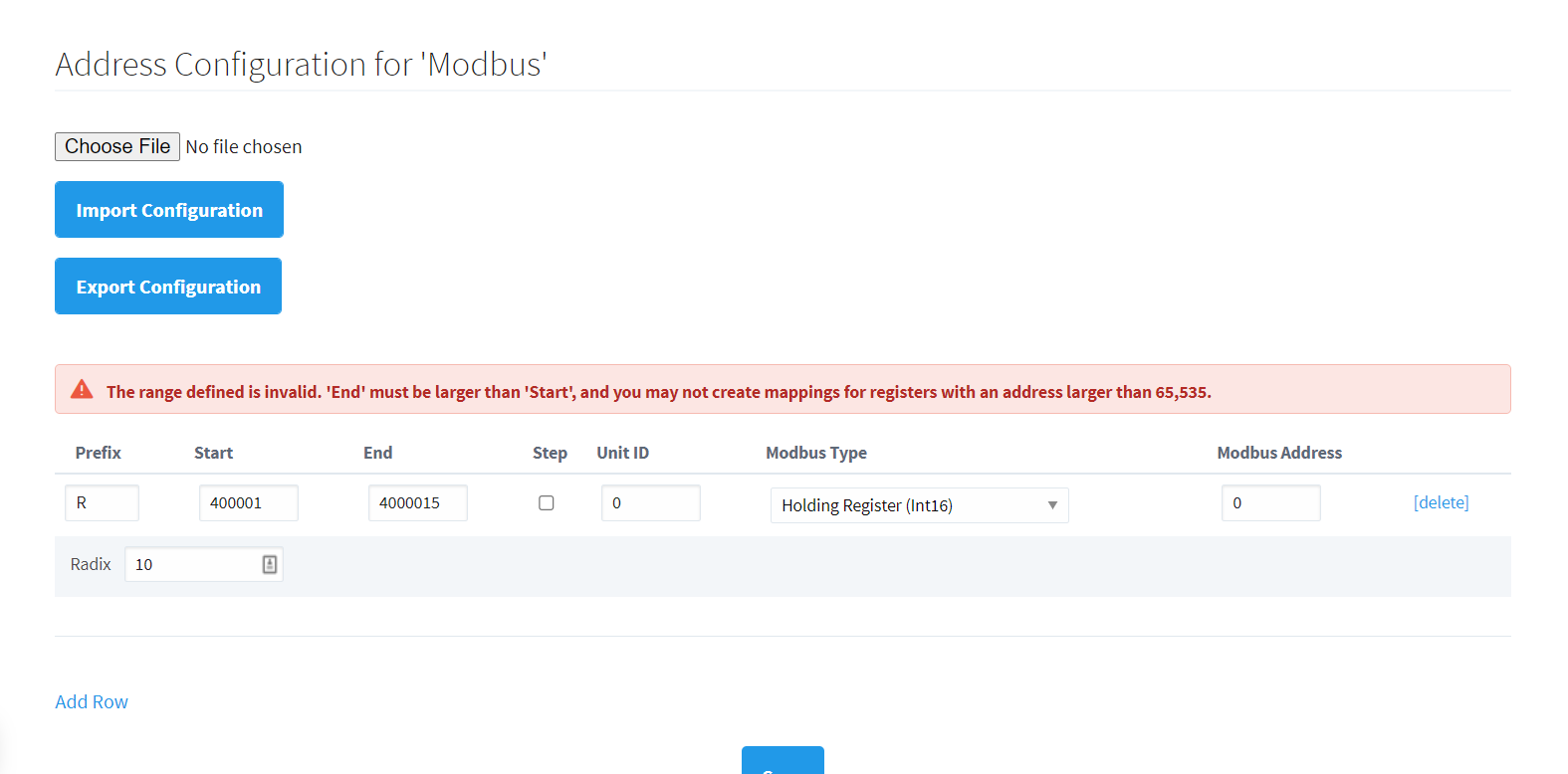

Modbus Driver Configuration Validator
We added a new validation feature to the Gateway’s Modbus Driver configuration. This validator will help keep your Ignition Gateway running speedily by preventing user input error when setting up device connections.
When you’re specifying how many registers you want to read, the validator will verify that both the range of values and the values themselves do not exceed 65,535.
The validation of the range will prevent you from inadvertently creating extremely large address mappings (a situation that could cause the Ignition Gateway to slow down). The validation of the values themselves will prevent you from using invalid addresses (since 65,535 is the Modbus Driver’s maximum valid value).
This precaution is a handy fail-safe. If you, for example, accidentally type extra digits into the “end” field, a warning will appear to alert you that you’re adding way more subscriptions than you actually want (and you’ll be prevented from doing so). Now, you’ll be able to avoid maxing out your CPU/memory and causing unnecessary downtime from an errant keystroke.
