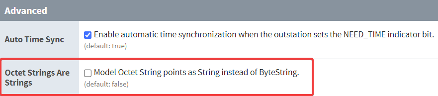

New Octet Strings Setting For The DNP3 Driver
8.1.44 adds greater convenience to the DNP3 Driver by enabling the reading of octet string points (byte arrays) as string types — without scripting. Please note that this new feature is specifically for the latest DNP3 Driver, not the legacy version.
Previously, it was a little bit of a pain to turn octet string point values into a string in the Ignition tag system. Since the expression language doesn't support operating on array values, converting the byte array value to a string required a custom scripting function. But now, you can have the DNP3 Driver model and deliver these values as strings with automated ease, simply by using the “Octet Strings Are Strings” advanced setting.
New Octet Strings Setting For The DNP3 Driver image.

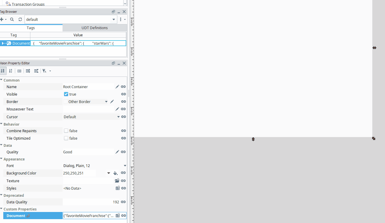

Document Data Type In Vision
The variety of data type options for Vision just got bigger in 8.1.44. Now, in addition to the existing integer, long, short, float, double, Boolean, string, color, date, and dataset options, you can also select “document” as a data type in Vision's custom properties.
This option is a way to store types of data that are along the lines of a JSON structure into a tag itself. The ability to do this already exists in Perspective, and you’ll now have that same functionality in Vision. With the document data type you’ll be able to view structures similar to how you can in Perspective, with a nested JSON structure look.
Document Data Type In Vision image.
