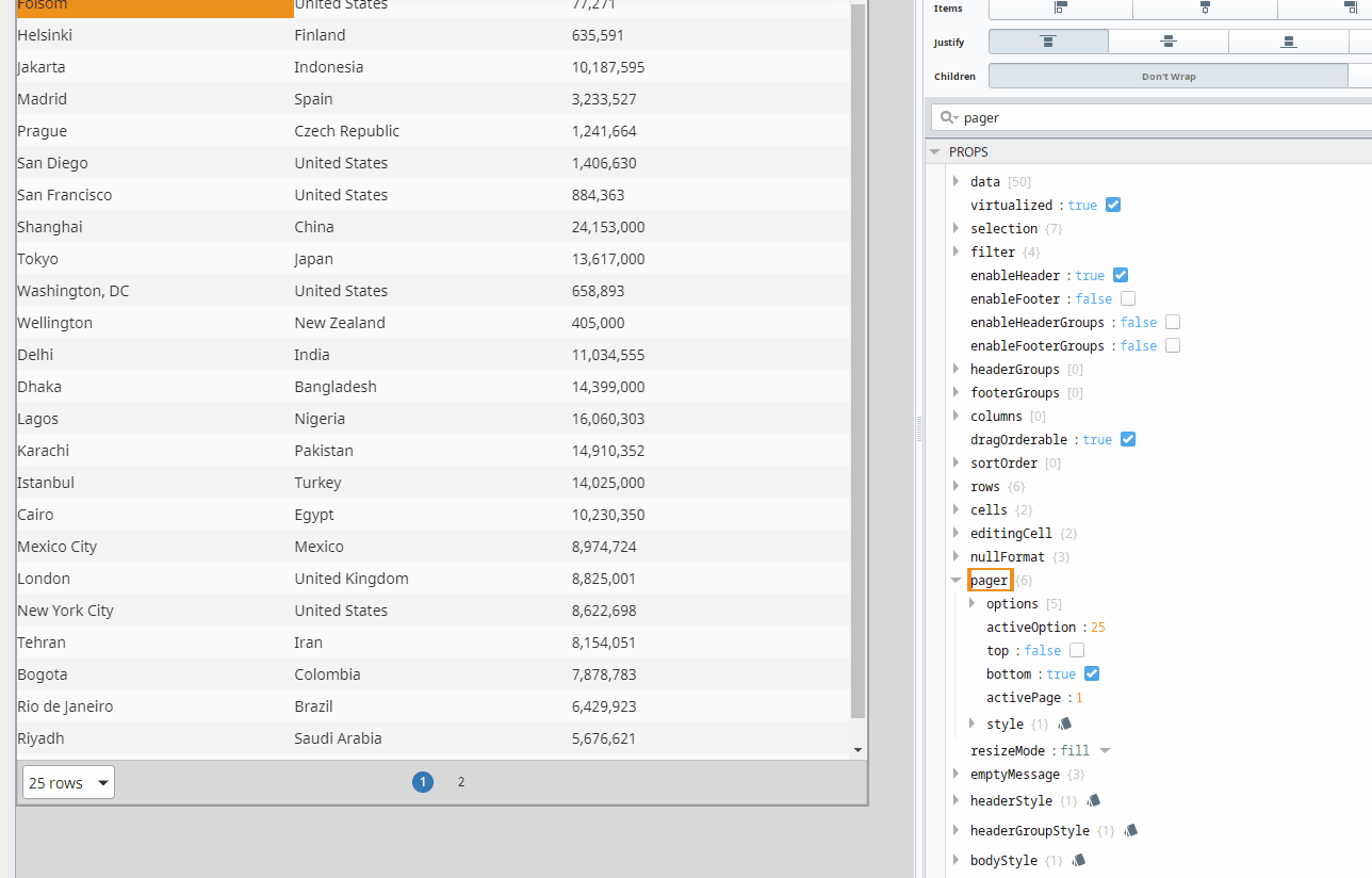

New Perspective Pager Property
In Perspective, you can now change the number of rows displayed at runtime in an active client with a new activeOption pager property for table components. We’ve introduced an updateOptionFromProps method (for allowing external writes to the activeOption property to update the pager's pageSize), along with a syncOption method (for allowing internal writes to the pager's pageSize to update the activeOption property).
Previously, with table.pager.initialOption bound to a view parameter, once a table component was first rendered, the (now soft-deprecated) initialOption property didn’t enable changing the amount of rows displayed in the table, unless it was configured to be persistent. Essentially, this property just didn’t play well with bindings.
But with the new activeOption property’s ability to accept runtime updates, things are a lot simpler. Its functionality is especially useful for views that appear on different screen sizes, when you might not want to use scroll bars, offering an easier way to control the appearance of views.

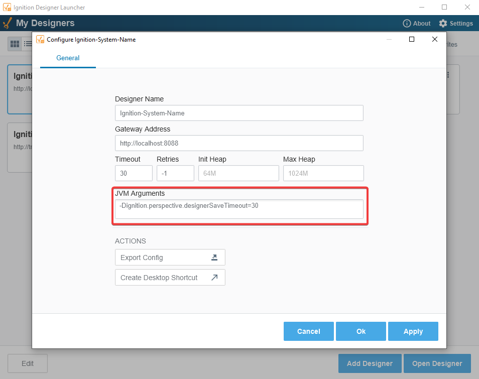

Improved Save Operations In Perspective
With 8.1.45, the experience of building in the Perspective designer just got even better. We added the designer system property ignition.perspective.designerSaveTimeout to control how long the designer will wait for the embedded browser frame to return results. The new property’s default timeout period is 60 seconds — three times longer than the previous timeout period.
Additionally, we improved asynchronous handling, so things should feel a little snappier when you’re working in the designer. And we made error messaging more explicit if you encounter issues while waiting for browser resources during a save operation, so that you have a clearer understanding of what’s going on.
These refinements to Perspective’s saving process should help eliminate some stressful moments as you build industrial applications, bringing a little more zen to your workflow.
