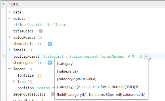

Never to be outshined, Perspective also received a number of functionality improvements. First up, you can now format the text on wedge tooltips in a pie chart. You can type in a specific format and look, but we provided some built-in options to get you started. Look for the new tooltipFormat property at the root of the component’s props. As always, you can more details in the user manual.
Pie Chart Prop

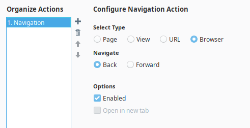

Speaking of the Navigation component action, we added a new “Browser” option that allows the session to go forward or backward in browser history. In short, you can add your own Forward and Backward buttons to a view — great if you wanted to add this functionality to an application that’s primarily being viewed by Perspective Workstation.
Browser Action

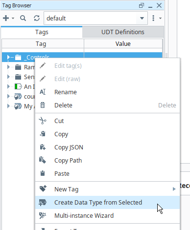

Ignition 8’s Tag Browser is continuing to evolve as we rework it for the newer platform. Users have commented that they miss the old functionality that allows them to select a number of tags and create a UDT definition. I’m happy to announce that as of 8.1.5 you’ll find that functionality has returned in all its glory. Selecting an option will now open a new window with the UDT already constructed. From there, you can make any further configuration changes before finalizing the new data type.
Create Data Type
