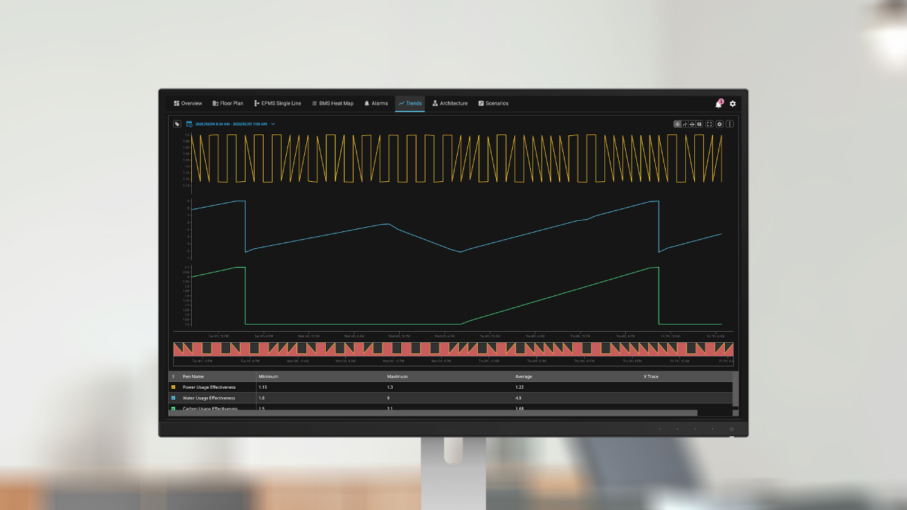

Optimize Time-Series Data Management
Core Historian Tips
The new Industrial Historian Solution Suite in 8.3 offers multiple industrial historians to optimize how you store, analyze, and manage time-series data. One of these historians is the built-in Core Historian, which has native data aggregation, requires zero database configurations, and needs no maintenance. The Core Historian has up to eight times better write performance and 600 times better read performance than Ignition’s previous internal tag history provider.
“It’s the easiest historian to deploy with Ignition!” Inductive Automation Sales Engineer Adam Koch says. “You just configure a historical provider in the gateway and Ignition does all the work. No external connection is needed.”
Maggie Rosenkrans, another Sales Engineer here at IA, explains that “It’s a great use case for when you don’t want or can’t manage a relational database for reasons such as limited resources.” For example, if the cost of managing a relational database is prohibitive or you don’t have a database administrator on staff, the Core Historian could be a great choice for you.

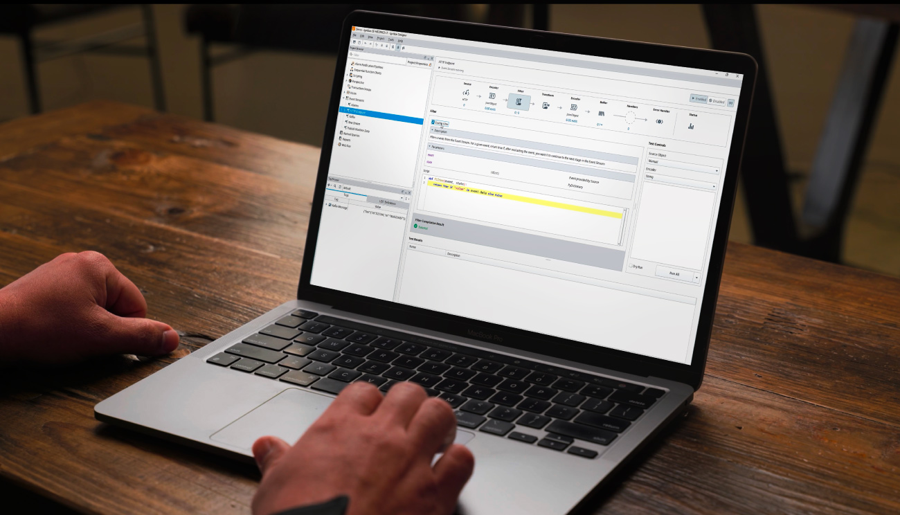

Event streams module
Do More With Event Data
Event Streams Tips
You can achieve event stream processing easily with 8.3’s new Event Streams Module. This exceptional new tool enables you to connect systems that don’t normally communicate with each other. Use it to map, filter, and route data between subsystems, centralize data flow, and handle asynchronous events in Ignition.
There are a ton of practical applications for Event Streams. You can use it to make Ignition a central data hub by managing and syncing event-driven data coming from many different sources and to many different destinations, including producing and consuming data with our new Kafka connector! Since you can use it to monitor events in real time, you can get real-time tracking and monitoring for vehicles, fleets, and shipments. You can also capture and analyze sensor data from IoT devices or other equipment for valuable insights. Additionally, you can use it to get an API “easy button” to handle data coming from APIs and push it to any internal or external source. Plus you can use it to boost asset management by collecting data from assets in real time.
Fischer offers up a handy tip for using Event Streams: “Use a Tag Source to watch tag values, writing to a database when the value matches certain conditions, such as out-of-band values or zeroes.”
