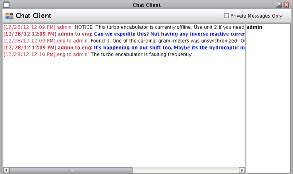

![Ignition Chat Client](/blog/sites/default/files/inline-images/Chat.png)
Click here to download the chat client project backup
It is a .proj backup. You can import it into your project through the Ignition designer by selecting File > Import... from the file menu.
If you type in a message and press enter it will send the message to all users. If you double click on a logged-in user to the right, it will send the message directly to that person. In that case, it will put the following into the text box:
/msg admin here is my message
The /msg admin tells the script who to send the private message to. Only users other than yourself will show up in the logged in list to the right.
