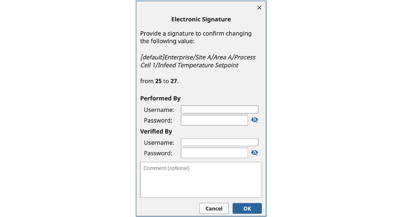

Firstly, the function can only validate against a User Source, not an Identity Provider. Companies who are using external Identity Providers like Okta or Azure Active Directory, which are not linked to a User Source, would have to configure a dedicated User Source (such as an on-premise Active Directory server) just for collecting signatures. This User Source would need to be set up, maintained, and synchronized with the Identity Provider to ensure compliance.
Secondly, calling system.security.validateUser() to generate a signature requires the application developer to collect a password from the user, which could create a security risk in the case of a malicious actor or if the password is inadvertently leaked through a seemingly innocuous logging command. If a company is using an Active Directory-linked User Source or otherwise synchronizes the password with an external Identity Provider, this security risk could extend to other applications that use the same authentication provider.

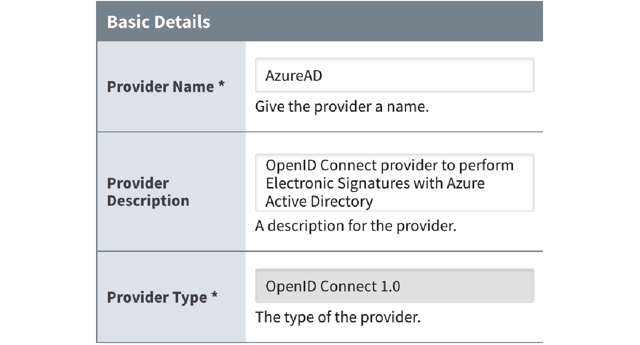

To use the new electronic signature support, an Identity Provider must first be configured. You can use either Ignition’s built-in internal Identity Provider or an external Identity Provider that supports SAML or OpenID Connect.

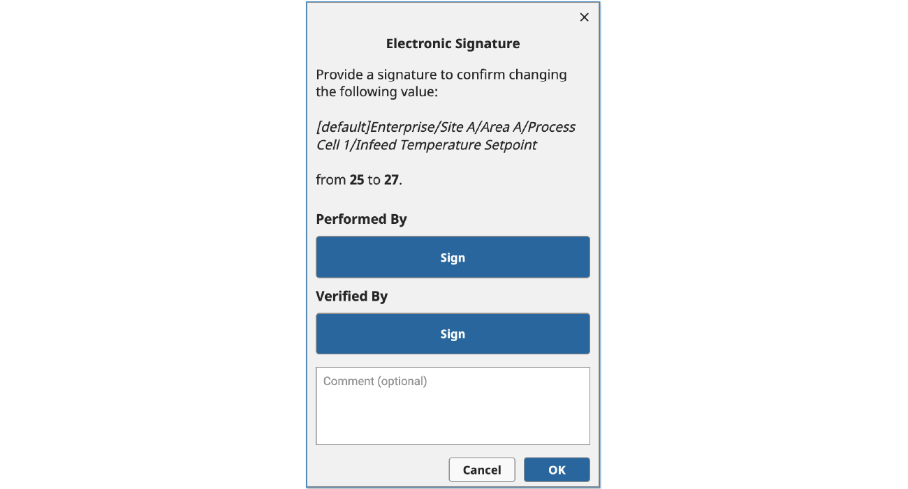

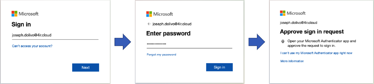

Once an Identity Provider has been set up, you can use the new system.perspective.authenticationChallenge() function to redirect users to an Identity Provider to perform the authentication process. In the example below, we trigger this function call when one of the “Sign” buttons is clicked.
This function supports several optional parameters that can impact its behavior, including a payload and a framing option. In this case, we are using the default “self” framing option (which is supported across all Ignition clients), which redirects the user away from Ignition and over to the configured Identity Provider to step through the authentication process.
![Authentication Process](/blog/sites/default/files/inline-images/4IR%20Solutions%20Guest%20Blog%20Main%20Graphic%20Screenshot%2011.png)

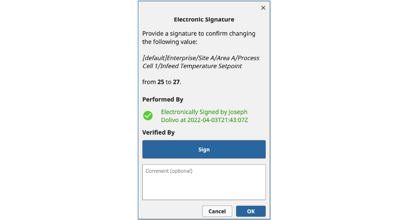

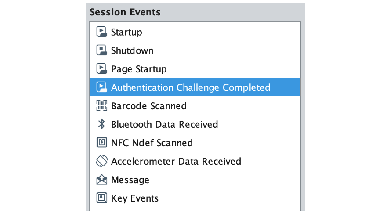

If the user successfully completes the authentication process, they will be redirected back to the Ignition application, and a newly added Perspective Session Event Handler called “Authentication Challenge Completed” will be triggered that contains the result of the authentication process, the optional payload that was previously sent, and a Session object, which your application can use to react to the authentication attempt.
To achieve the example below, we are using custom Session properties that allow us to reconstruct the view state, verify appropriate user roles, and provide a visual confirmation of the signature.
