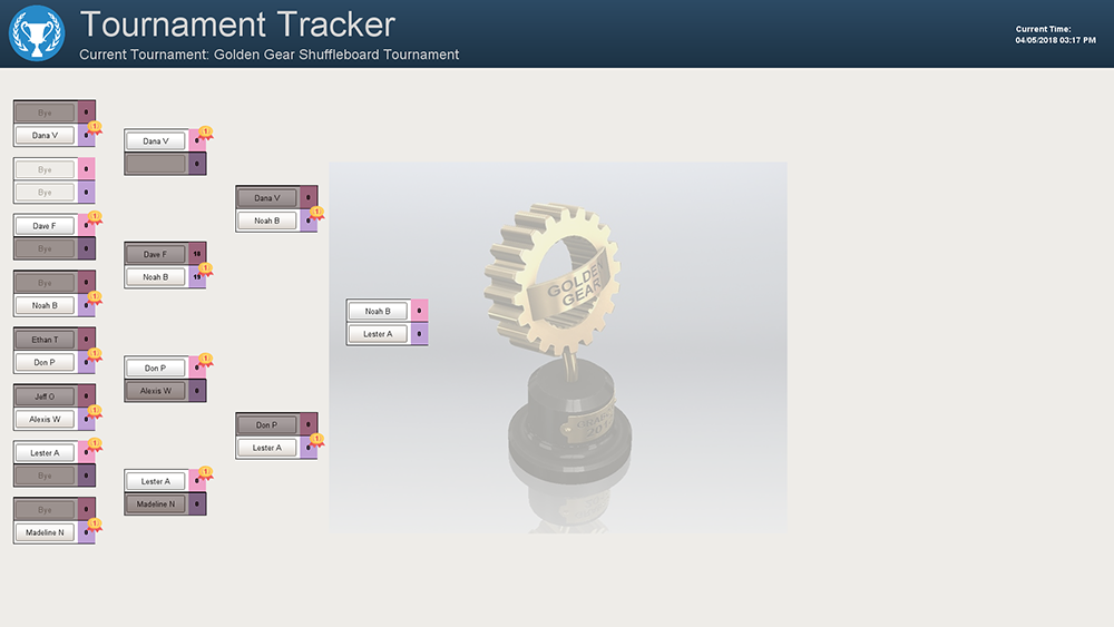

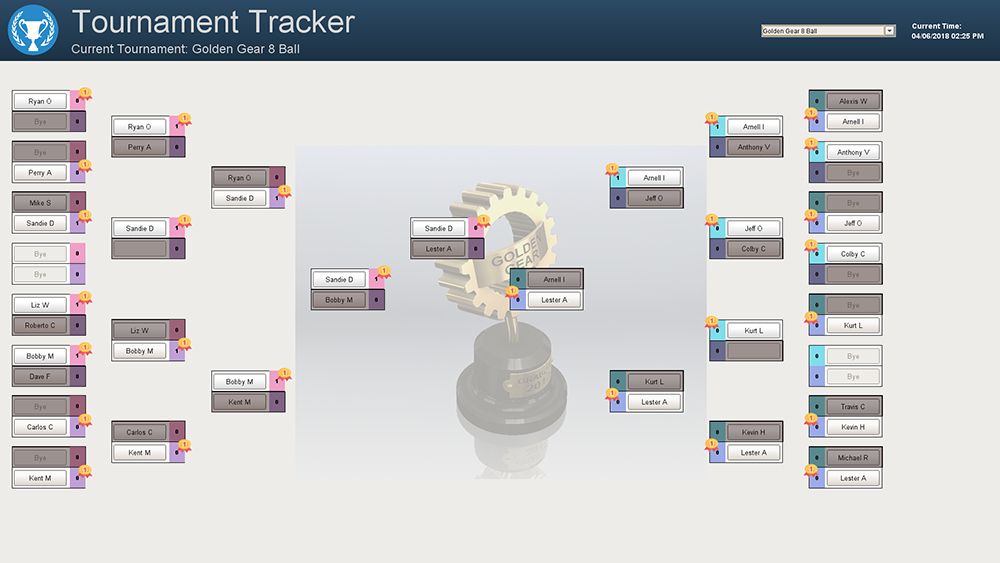

After verifying that tournament data and matches were being recorded properly, the next step was to display the brackets. I initially considered the Template Repeater component but settled on the Template Canvas so that I could have complete control of x and y positions and the ability to use different templates in the same canvas component. To simplify things further, I made one project for both the TV and the tablets.
When the first round is 8 brackets or less, we display brackets from the left side to right:
When more than 8 brackets exist in the first round, we bring them in from left and right:

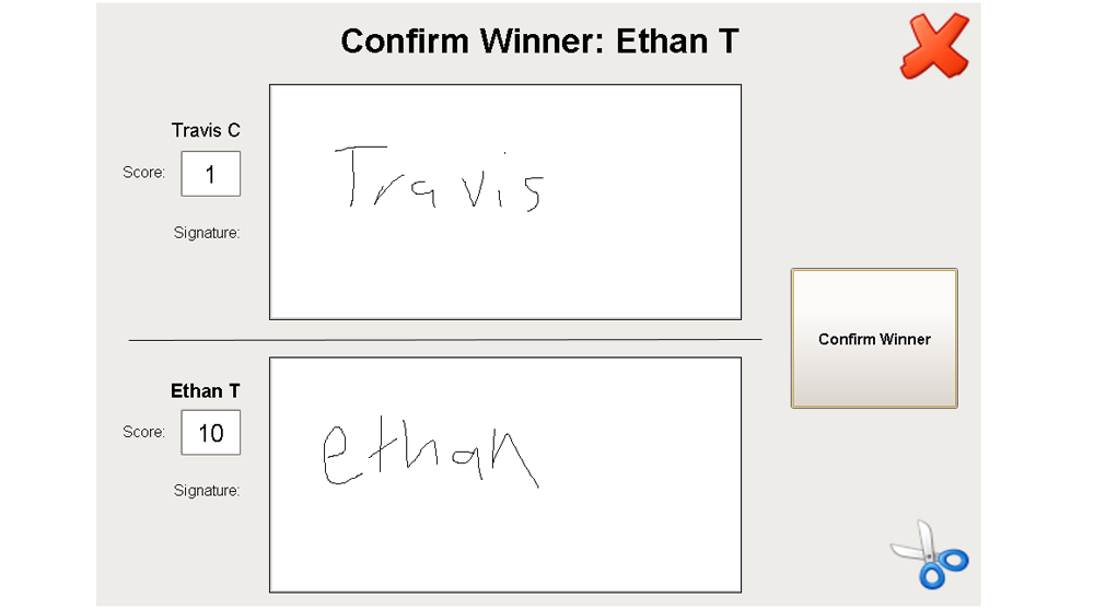

After a match is complete, the winner’s name is selected and a confirmation popup appears to set the score. Since the Golden Gear Games were serious business, we required signatures from both contestants and stored these as blobs in the database. The page then immediately updates the brackets with the new information.
