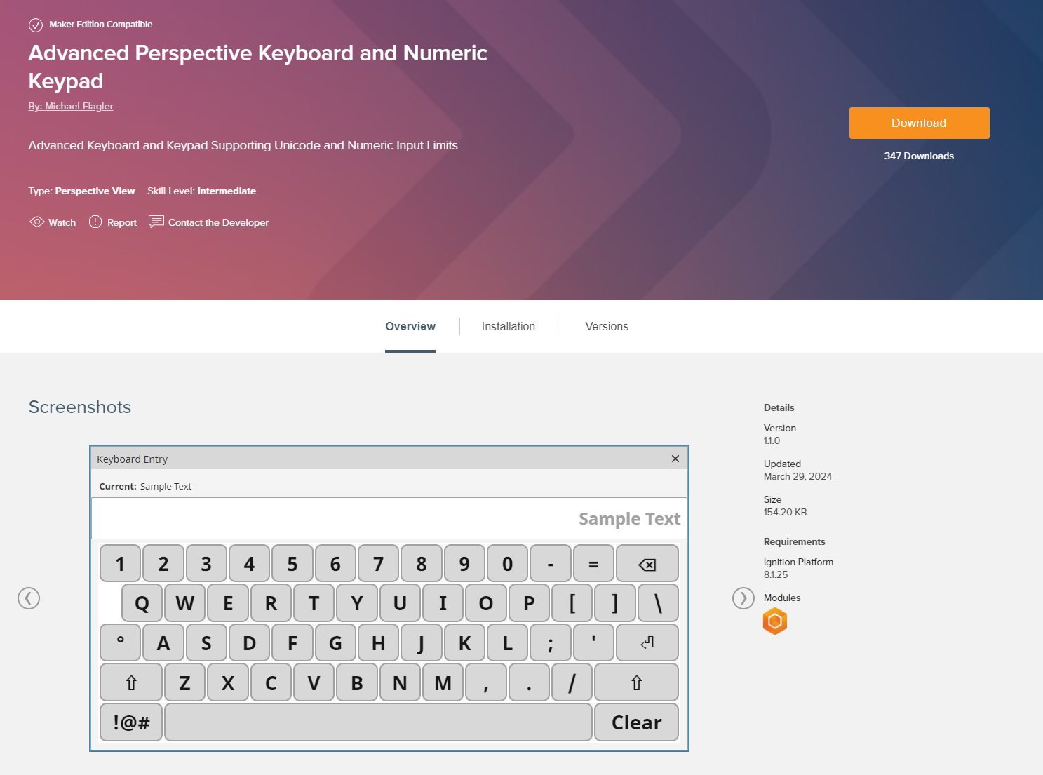

While Vision had an integrated touchscreen keyboard, Perspective requires additional components to accomplish this. For Perspective, we can either use the operating system’s built-in OSK or integrate it as a component directly into Perspective. There are pre-built Perspective components available on the Ignition Exchange for OSK and numpads. When integrating the keyboard directly into the Perspective session, disabling the OS’ built-in OSK is required.
Fig. 1. Ignition Exchange resource for on-screen keyboard as Perspective component

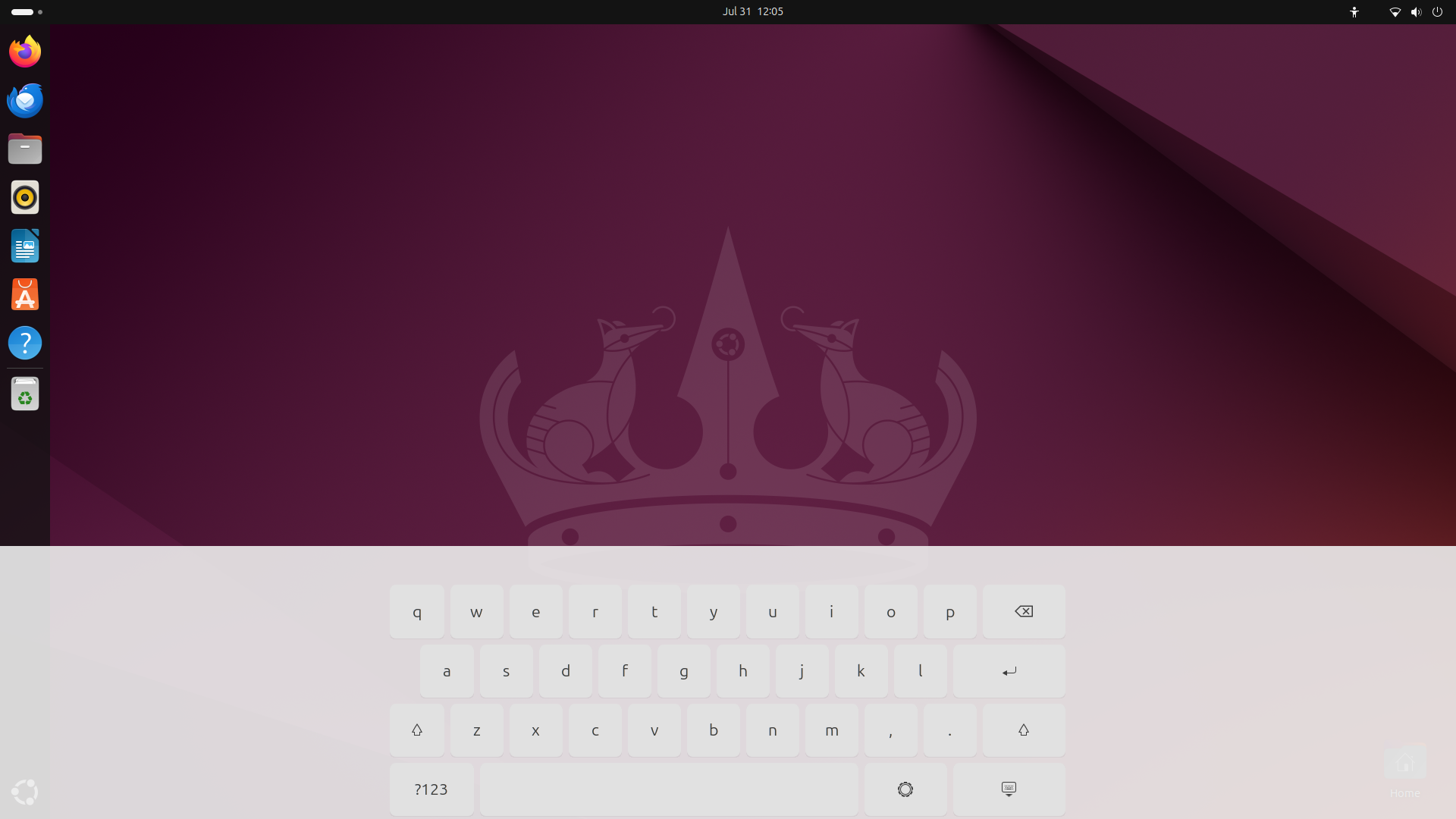

You can enable the OSK in the accessibility system menu under the typing section. It will pop up from the bottom of the screen, occupying about one-third of the screen space, and you can manually bring it up by swiping from the bottom of the screen (PCAP screens only). This can present challenges as input boxes can become blocked by the OSK window.
Fig 3. Default GNOME OSK in Ubuntu 24.04 LTS
