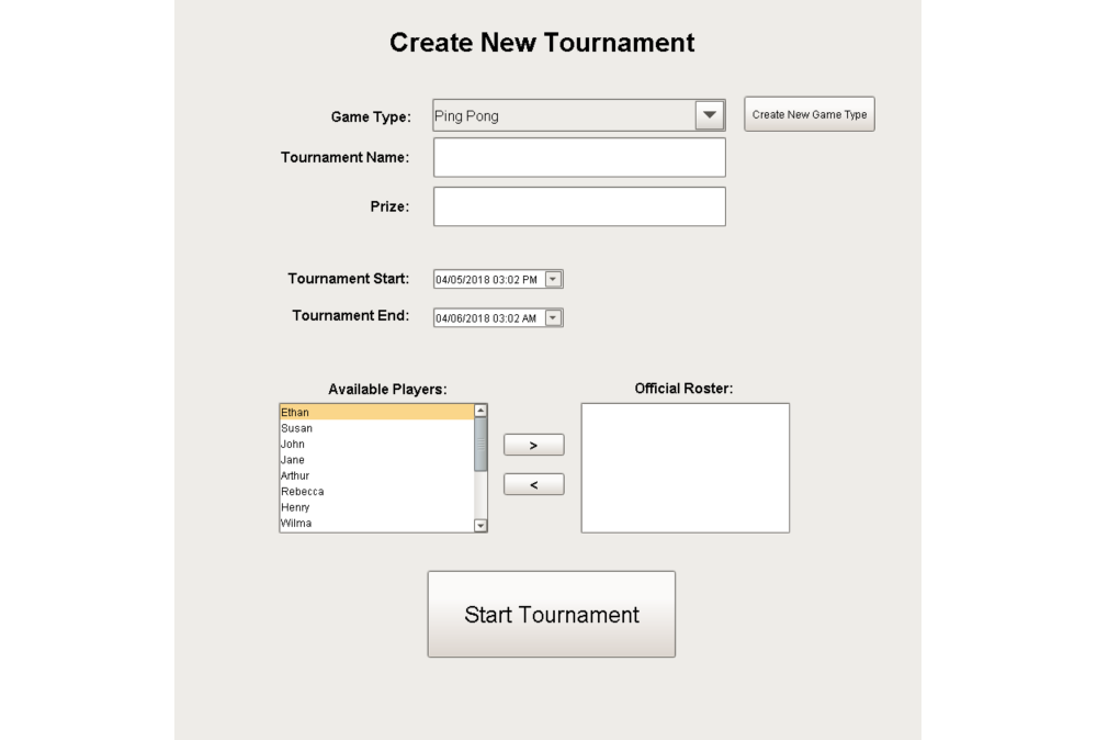

Where the Action Begins: The Tournament Creation Screen
Screen - Create New Tournament
The tournament creation window

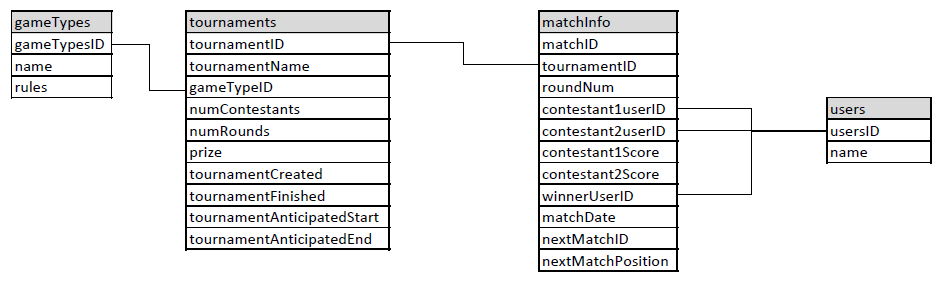

Database Design
Tournament Tracker Database Schema
Here is a peek at the tournament tracker’s database schema. You can see how the tournament creation screen maps to columns in the “tournaments” table.
Managing Player Rosters
One requirement was that the system needed to accept a roster containing anywhere between 1 and 32 contestants, then automatically shuffle the contestants and add byes as necessary. To accomplish this, I sent the dataset from the “Official Roster” list and passed it into a shared script for processing. The script takes the total number of contestants in the dataset and passes it into the following function to get the next power of 2:
def next_power_of_2(x):
   return 2 if x <2 else int(2**math.ceil(math.log(x,2)))
This is the total number of contestants needed to make enough brackets for the first round. Subtract the number of contestants in the roster and you have the total number of byes. A for loop then adds these byes to the dataset. Next, I added a column named “random” to the dataset and used randint from the math library to assign a random number for each contestant/bye. Finally, I used system.dataset.sort to sort the dataset by this new random column and our roster of first-round matches was nearly complete!

One of the biggest design challenges I encountered was how to advance winners of each bracket to the next round and correctly keep track of bracket positions. I approached this challenge by creating the final round first in the matchInfo table and retrieving the matchID.
Next, the script creates the next set of rounds above and stores them to matchInfo with nextMatchID set to the matchID of the final round. This process iterated for the number of total rounds in the tournament, each time inserting the nextMatchID previously created. Ultimately the first round is inserted last with the contestant user IDs from the roster with byes we created first. When a contestant wins, the next match is updated with the contestant’s userID.
Here is a simple example using 3 contestants: The next power of 2 is 4, thus we need 1 bye (userID=0 for byes). Below, you see matchID 602 is created first and roundNum is set to 2. Next you see the first-round matches: 603 and 604, both of which have nextMatchID set to 602. Also note that nextMatchPosition is used to determine whether the winner of the match should be set as contestant 1 or 2 for the next round.
Match Info Table
Three rows from the matchInfo table showing a simple two-round tournament

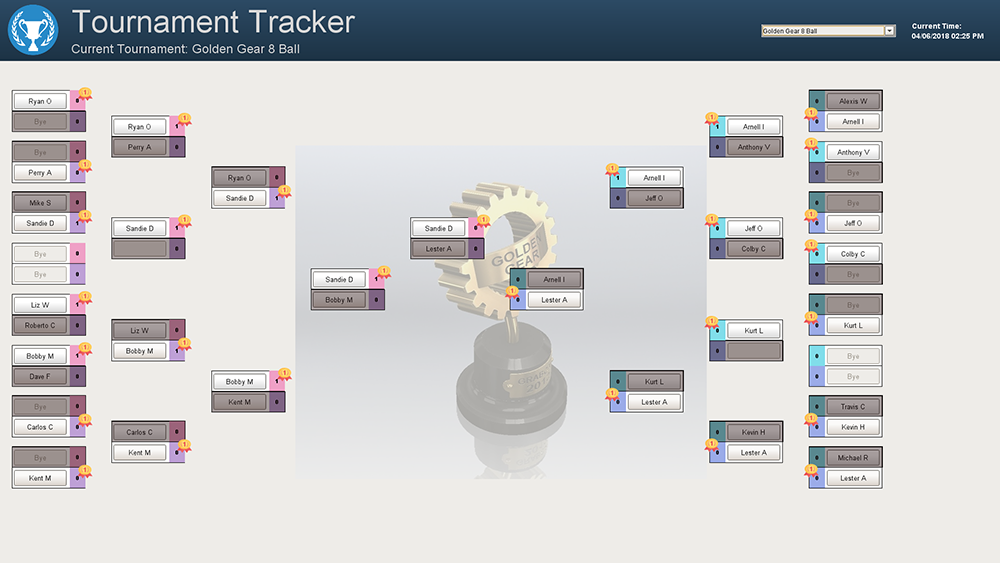

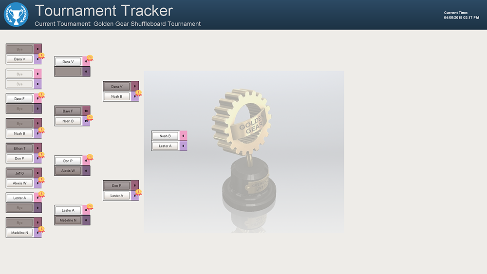

After verifying that tournament data and matches were being recorded properly, the next step was to display the brackets. I initially considered the Template Repeater component but settled on the Template Canvas so that I could have complete control of x and y positions and the ability to use different templates in the same canvas component. To simplify things further, I made one project for both the TV and the tablets.
When the first round is 8 brackets or less, we display brackets from the left side to right:
Tournament Tracker Example
A nearly completed tournament showing prize ribbon emblems for the winners of each match
When more than 8 brackets exist in the first round, we bring them in from left and right:
A tournament with 16 matches in the first round

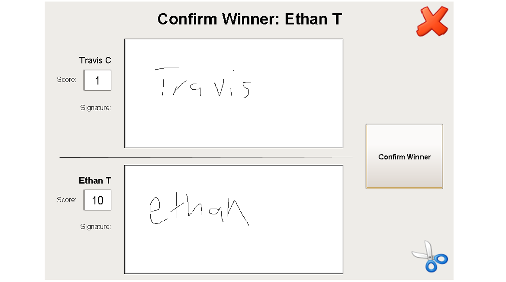

After a match is complete, the winner’s name is selected and a confirmation popup appears to set the score. Since the Golden Gear Games were serious business, we required signatures from both contestants and stored these as blobs in the database. The page then immediately updates the brackets with the new information.
Confirm Winner Screen
Inputting scores and signing to confirm the winner
