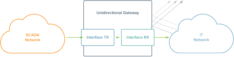

4: Consider Using a Data Diode
If you have an extremely sensitive network that doesn’t need outside data, consider a data diode. This is a device that only allows data to flow out of your network, but not flow into it, thus completely cutting off one major vector of attack.
