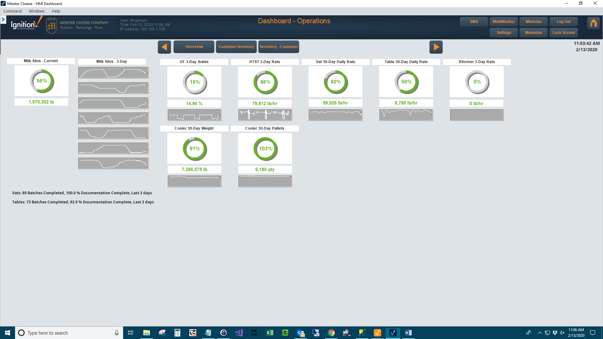

Operations Dashboard for Meister’s Cheese Plant

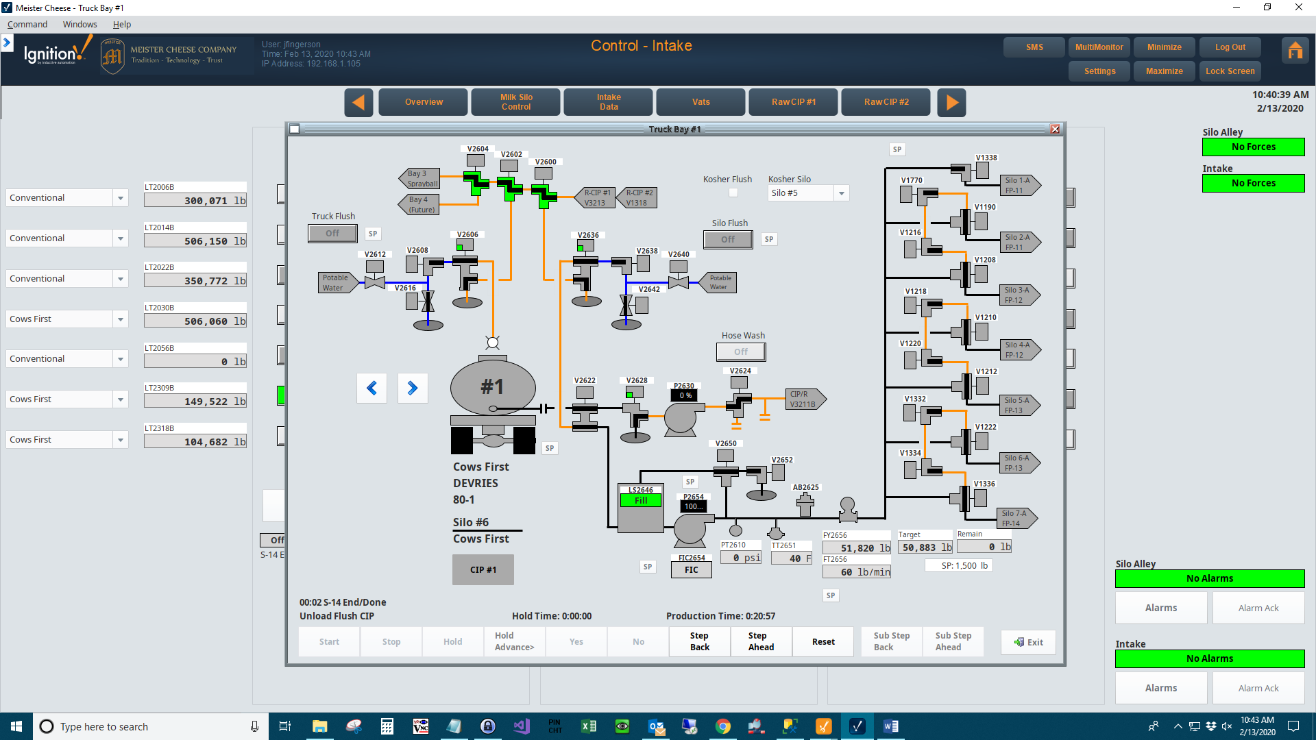

Meister’s platform now has more than 50 active clients, including clients on the manufacturing floor to monitor and control processes and clients in the company’s offices. Meister has separate control screens for each of the different processes in the plant. An example is shown below.
Intake Control Screen
In reflecting on the importance of Ignition to Meister, John said, “Everything in our plant is being run off of one moderately-sized server ... I still haven’t found anything that I can’t do with Ignition simply and efficiently.”
