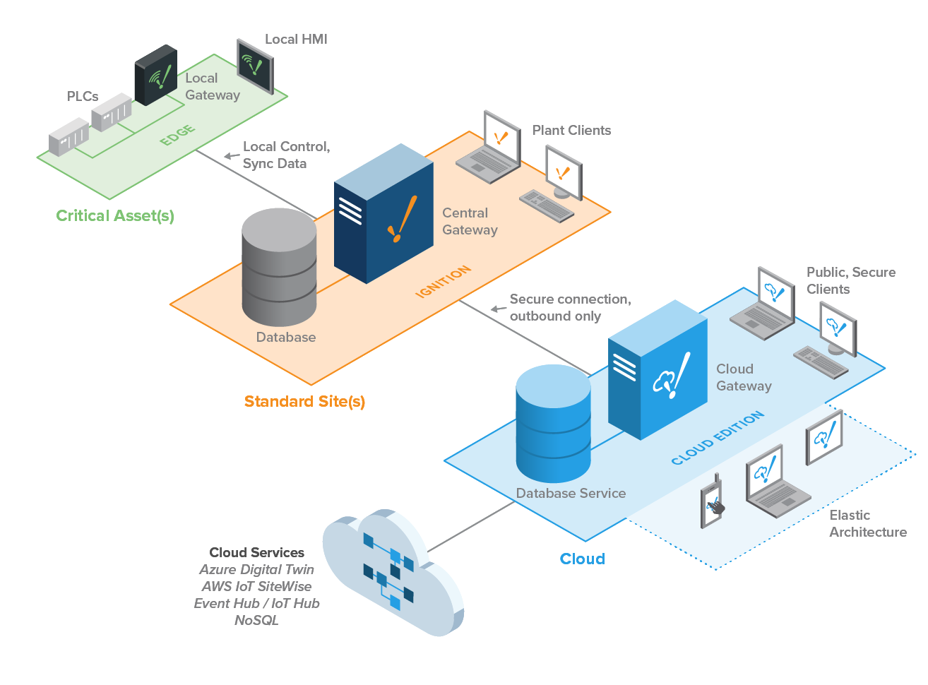

Before delving into different architecture types, it’s important to first be aware of the different Ignition editions.
Ignition
Ignition is the foundational platform that covers most solutions. It includes an expansive set of device and database drivers to act as a hub for everything on your plant floor for total system integration. For more information, please visit the Ignition page of the Ignition User Manual.
Ignition Edge
Ignition Edge is a lightweight, lean version of Ignition with software solutions designed for devices used in the field and OEM devices at the edge of the network. For more information, please visit the Ignition Edge page of the Ignition User Manual.
Ignition Cloud Edition
Ignition Cloud Edition is a cloud architecture-based version of Ignition. Unlike standard Ignition and Ignition Edge, which are available as installable software on Inductive Automation's downloads page, Ignition Cloud Edition is available through major cloud computing marketplaces such as Amazon Web Services (AWS) and Microsoft Azure.
Besides distribution, there are other key differences that distinguish Ignition Cloud Edition from standard Ignition or Ignition Edge, such as device connectivity and module granularity. For more information, please visit the Ignition Cloud Edition page of the Ignition User Manual.

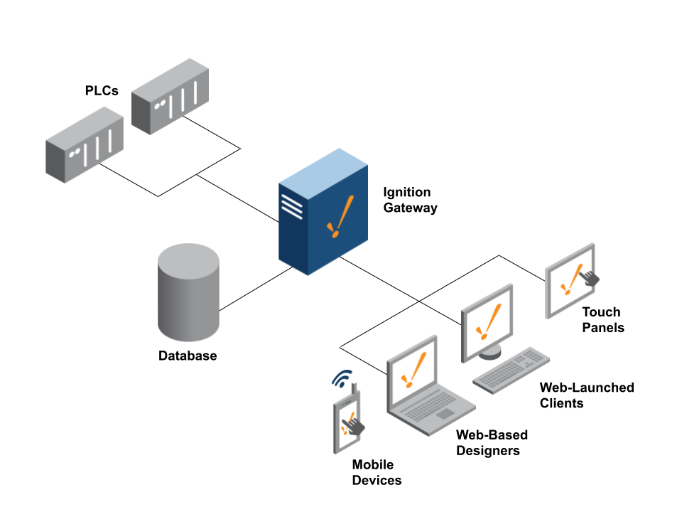

Single Gateway
Standard Architecture Graphic
Ignition’s most common architecture consists of a single on-premise Ignition Gateway connected to a SQL database, PLCs, and clients. In this case, all functionality is configured on the same Ignition Gateway. Ignition’s licensing is unlimited. However, Ignition is limited by the size of the hardware. With more capable hardware, Ignition can handle more device connections, tags, and clients.

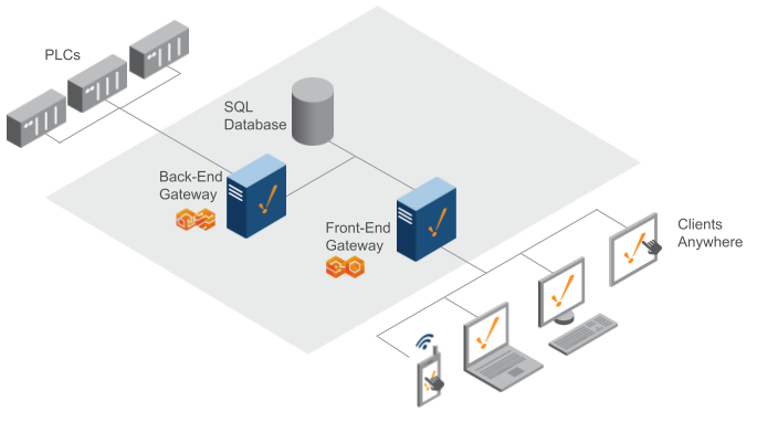

One Back-End Gateway / One Front-End Gateway
Scale Out - One I_O
With this architecture, you have one Ignition Gateway communicating to the PLCs and performing back-end tasks such as polling live values, historian, and alarming. The Back-End Gateway is responsible for logging data to the SQL database. The Front-End Gateway handles all of the visualization clients (Vision and Perspective) and should also communicate to the SQL database for querying historical data.
With this architecture, you can handle more device connections, tags, and clients since you have two Gateways. You can easily expand to multiple Back-End Gateways and Front-End Gateways as the size of the project increases, allowing for easy scalability.

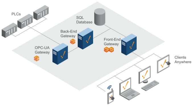

One OPC UA Gateway / One Back-End Gateway / One Front-End Gateway
Scale Out - One OPC-UA & I_O
With this architecture, a dedicated OPC UA Gateway that handles all of the PLC communication was introduced. Essentially, you are breaking apart OPC UA from a single Gateway. This architecture lets one handle a larger set of devices. The Back-End Gateway simply handles the tag value changes. You can easily handle a larger set of tags, in regards to history and alarming, with additional OPC UA Gateways for different sets of PLCs.

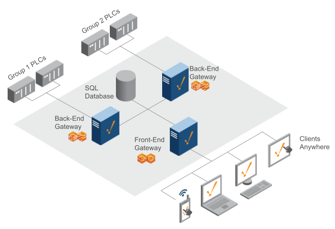

Two Back-End Gateways / One Front-End Gateway
Scale Out - Two I_O
With this architecture, you have two Ignition Back-End Gateways communicating to different sets of PLCs, allowing for communication to a larger set of devices and tags. For example, it is possible to handle approximately 250,000 tags from 200 devices. You can easily add additional Back-End Gateways as necessary.

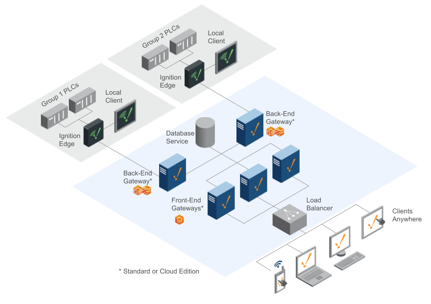

Full Scale-Out With Load Balancer
Load Balancer
The best thing about the Scale-Out architecture is that it is easy to scale up Ignition as your system grows. In the image above, more Front-End Gateways were added to help handle an increase in clients, and a Load Balancer to automatically distribute the clients between them. When using a load balancer, it is important to turn on “sticky” sessions to ensure the connection stays consistent for at least one hour. The Front-End Gateway has to be completely stateless. It gets its data from the Back-End Gateways and the SQL database service. Using this architecture with an appropriate number of Front-End Gateways, you can handle thousands of concurrent clients along with a high number of devices and tags.

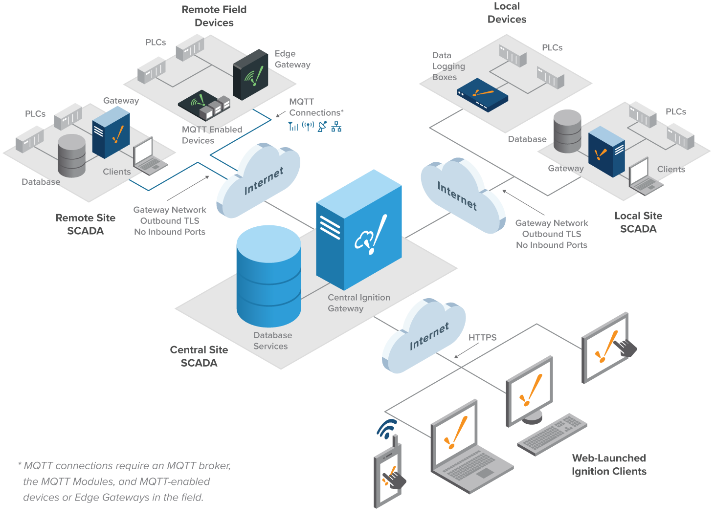

Hub and Spoke
Hub-Spoke-With-Cloud-Architecture
The Hub and Spoke Architecture consists of two main pieces. The hub piece is the Ignition Cloud Edition Gateway, with Perspective, MQTT modules (and more…) and a cloud provider database service. The spoke piece consists of an Ignition Gateway (Edge or standard) connected to the field devices, with OPC UA and SQL Bridge Modules, dedicated for data logging. Each site is fully independent, operating with its own history, alarms, and clients. The Ignition Cloud Edition Gateway is used for consolidation of data from all sites, giving a user the ability to see the larger view of the organization.

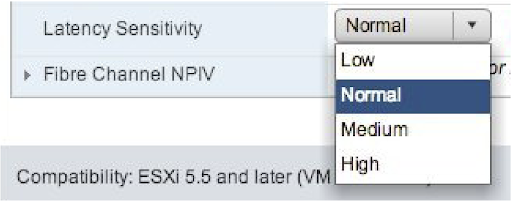

Dedicated Resources
When first specing an Ignition Gateway’s needs, always mention the need for dedicated vCPUs and memory. If an Ignition Gateway starts small, it might not be initially needed, but as it grows dedicated resources will be required to avoid issues. If dedicated resources aren’t initially configured, there may later be significant pushback from IT departments who weren’t anticipating this need.
VMWare Specific Settings
In VMWare, this is most commonly configured by setting Latency Sensitivity to High.
After configuring this, check to make sure the vCPU allocation is 100% dedicated to the Ignition VM. If it’s not, it means the whole VM Host is over-provisioned, and this will need to be fixed.
