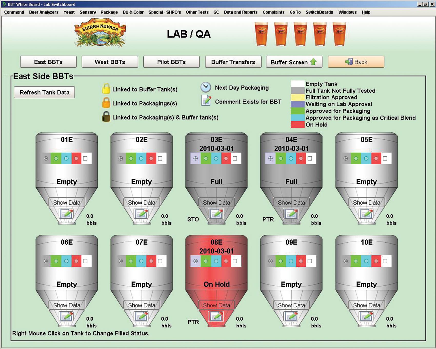

Ron Mayfield, system developer for Sierra Nevada Brewery Co., said that various interactions with the company’s SQL database had always been problematic in the past. When they rewrote all of the data to go through Inductive Automation’s software, life got easier.
“Once we realized that was possible – to work with the PLCs and other SQL production databases – we found we could bring it all together and put it on one screen,” Mayfield said. “That kind of synergy of info was all off limits until Inductive Automation came around.”
By being able to work with the PLCs and the database, Mayfield said they soon realized that they could help all departments communicate seamlessly. One example he gave was their filtration to packaging workflow.
Before a tank of beer is ready to be packaged, it has to be processed by the filtration department and then sampled and tested by the lab. Test information was then hand-written on to a series of whiteboards around the plant.
Mayfield said they faced a very simple, but big problem: As the plant grew, people had to remember to write that information down in more and more places – a round trip of nearly half a mile! Now, with web-launched client screens bringing together PLC data (tank statuses, etc.), lab test data (from lab devices), and workflow data (approvals, comments, out of spec alerts), all that information is now available through any PC in the plant.

Jonathan Swisher: Prior to Ignition, the data was communicated through whiteboards throughout the plant. Somebody would walk around and update the whiteboard with information. So as the beer flowed from tank to tank and we did various things such as yeast cell counts or temperatures or CO2 values on the tanks, that information was written on whiteboards so people knew where it was in its process stage, mainly before it went to packaging or on its way out to packaging. So, now with Ignition, we can communicate that with the click of a mouse from one area of the brewery to another area of the brewery without somebody walking around and updating whiteboards.
