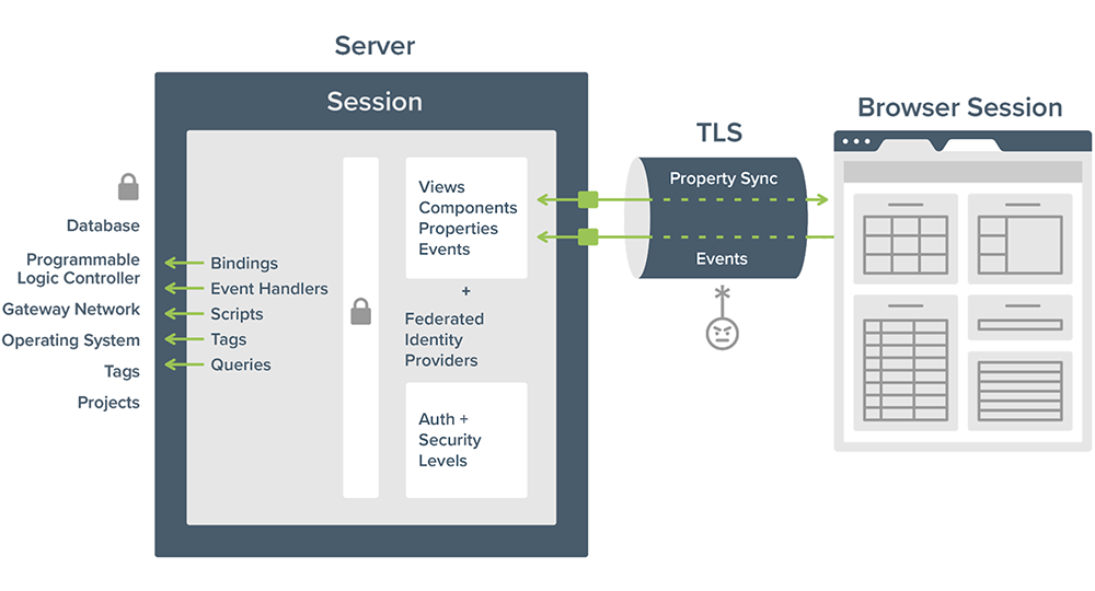

TLS-encrypted connection between the browser and the server.
In Ignition Perspective, the application lives on the server and the session runs in the browser. Property syncs and events pass through a TLS-encrypted connection between the browser and the server.
Let’s look at some of the underpinnings of Perspective to get a better look at how security is built right into it. Perspective can deploy mobile clients through the Ignition Perspective App or through web browsers. When you use Perspective in a web browser, you go to a URL, an IP address, or a host name of a server to get access, and then the entire application runs in the browser. Most of the security, however, is handled by the Ignition Gateway rather than by the browser. The Perspective browser session communicates back to the Ignition server to get information; however, it is very limited in how it can interact with the Ignition server. When you open up a Perspective application that you’ve built, you log in and establish a session with the server, so that Ignition can verify who you are before it grants access to any data. Once that session has been established, the entirety of the application basically lives on the Ignition server, including the page that you're on and all of the views, components, properties, events, and models that are represented in the session.
Synchronizing Properties
There are only two points at which the actual Perspective session interacts with the Ignition server, as the diagram above shows. One of those points is for synchronizing properties. Let’s say that you have a tank level component bound to a tag. As the tag property changes, you’d want it to be synchronized to the browser so that the proper level is indicated there, or vice versa. If you were to write to a tag to change the setpoint, then you’d want to let the server know that you’ve changed this particular value, and that is only accomplished through property syncs. Once you synchronize a property, there are whole layers of protection in place to determine whether or not that change can actually occur down to the device.
During a Perspective session, the Ignition server is communicating with a lot of resources such as PLCs or other devices, databases, other Ignition servers through the Gateway Network, the operating system, and any other projects or files, and it’s important to protect all of those connection points. Perspective puts a whole layer of security in front of all those protected resources. When a session is established, the federated identity providers on the server are used to check on who that person is and what permission levels they have. If the user tried to write to a tag, that request would have to go through the security layer on the server to check whether or not they are allowed to do that. If the user doesn't have the correct permission, the sync is rejected.
Responding to Events
The second point where the Perspective session interacts with the Ignition server is when responding to events. For example, when the user clicks on a certain button, the action is to have them upload a file. We want to know that the file was uploaded, and events are also sent to the server so that we can respond to those events with various handlers, and maybe to go and get data or do something with that.
As the diagram shows, the events and property syncs pass through a secure SSL/TLS encrypted connection between the browser and the Ignition server. This is similar to when you log into your bank account online and see “https” in the URL at the top of the screen, which indicates that the website is secured by an SSL/TLS encryption. Because events and property syncs go through this secure connection, it is very, very difficult for a bad actor to do something harmful with them.
By looking at the architecture of Perspective, you can see that we intentionally built it to protect the resources that communicate with the server by setting security layers and verification requirements that prevent bad actors from accessing them.
