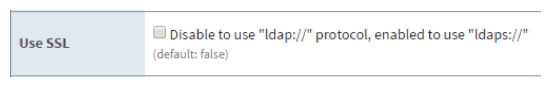

LDAP Protocol Security
The active directory User Source communicates with a Microsoft Active Directory server through the LDAP protocol. To prevent snooping on authentication, encryption should be implemented. In the advanced options for a new Active Directory User Source, Ignition has a setting to force LDAPS.
LDAP - Use SSL

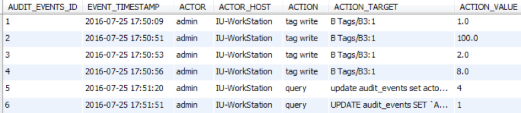

Audit Profiles allow Ignition to record details about specific events that occurred. Audit Profiles are simple to set up and immediately start to record events. By default, only tag writes, SQL UPDATE, SQL INSERT, and SQL DELETE statements are recorded. This allows you to keep track of which user wrote to which tag, or modified which table. Furthermore, a time-stamp is recorded, so you can easily track the changes, outline, and order of events.
Once some changes have been made to a tag or a database table, Ignition will begin recording.
Audit Profiles
More Information regarding Audit Profiles can be found in our user manual.

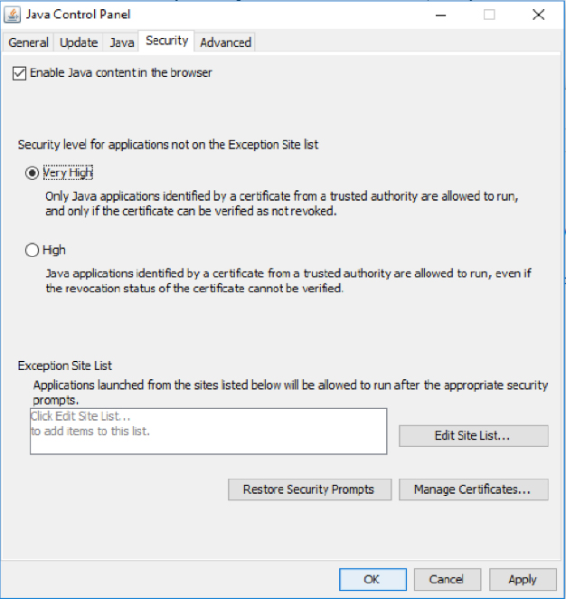

Runtime (Java) Security
Ignition is bundled with a purpose-built Java runtime that is kept up-to-date by staying on a current version of Ignition. Unless required by other applications on an Ignition gateway, it is recommended that externally installed runtimes such as Java and the .NET Frameworks be uninstalled to protect from known and future vulnerabilities. If needed, keep these runtimes up to date.

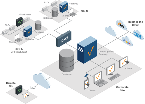

DMZ Architecture
A DMZ Architecture (referred to as a “demilitarized zone”) contains a subnetwork that accommodates the organization’s exposed, outward connecting services. In general, it acts as a point of contact between the organization’s internal network and untrusted networks, such as the internet.
The goal of this architecture is to add an extra layer of security to the local area’s network, allowing the local network to access what is exposed in the DMZ and keeping the rest of the network protected behind a firewall.
We recommend consulting with a network security professional to help identify the best network options for your organization, and whether a DMZ is the right choice for your network topology.
Igntiion DMZ Architecture
