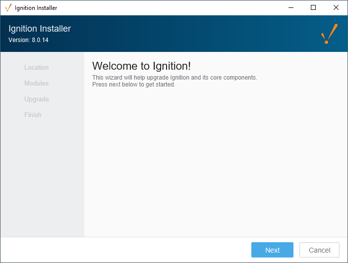

The next time you grab and run an installer from our Downloads page (starting with 8.0.14), you may notice some visual differences.
Ignition Installer

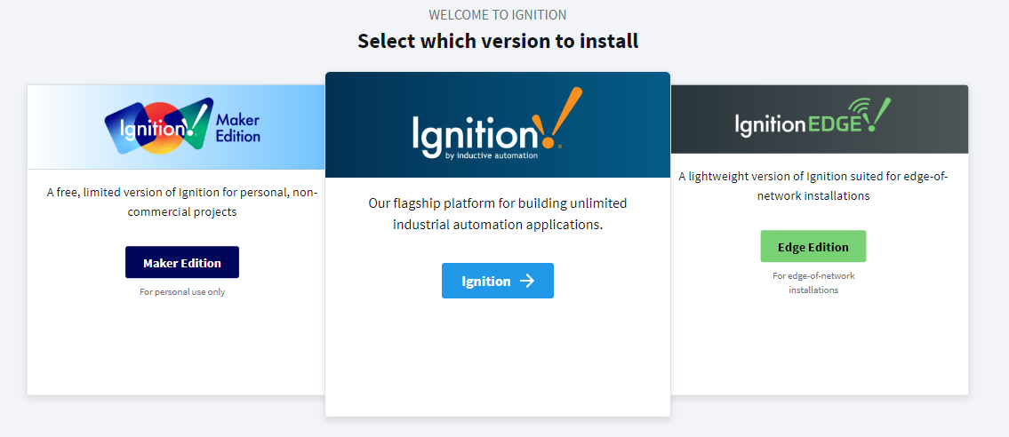

While working on Maker, we realized that we’re entering a brave new world where there are three editions of Ignition. We want to maintain the simplicity of our installation process, while allowing you to choose from these different editions.
With this release, we’ve developed a new installer with the same functionality you’re used to, but with some improved visuals and steps. On fresh installations, the commissioning process begins with an Edition Selection, allowing you to choose between Standard, Edge, and Maker.
Ignition Edition Selection
This means we no longer need to maintain separate installers for Edge, as the installer (and the zip files) can set the edition during initial commissioning.
Aside from the above, and the great new look, you’ll find the installers have the same functionality and familiar ease of use you’ve come to expect. If you want to take a look at the new installer (and Maker’s activation process), then start at the 1:25 mark in the video below:

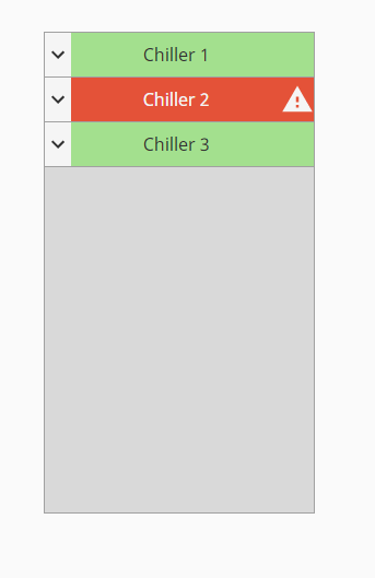

Way back in the 8.0.2 post, I introduced the newly added “display” property available on components placed in a Flex Container, allowing you to conditionally show or hide components in the component. That feature is exciting because you can use it to make collapsible drawers in a view, although the example I presented did require a bit of initial setup, as you had to make the “header” views, and hook up the bindings and other interactions to the content you wanted to hide.
The Accordion component aims to make it even easier to do, by providing an out-of-the-box collapsible drawer component.
Ignition 8.0.14: Maker Edition, New Installers, Accordion Component, and BACnet Beta
Each item on the component (if you’re sticking with my analogy, the “drawers”) is made up of a container and a header. The header features text, and swappable icons for both expanded and collapsed states. If you want to further customize the header, you can replace it entirely with a view, allowing you to put whatever you’d like in there.
The body of the accordion accepts an embedded view, so again you have complete freedom on the contents. We’re excited to add this new tool to Perspective’s growing component library!
