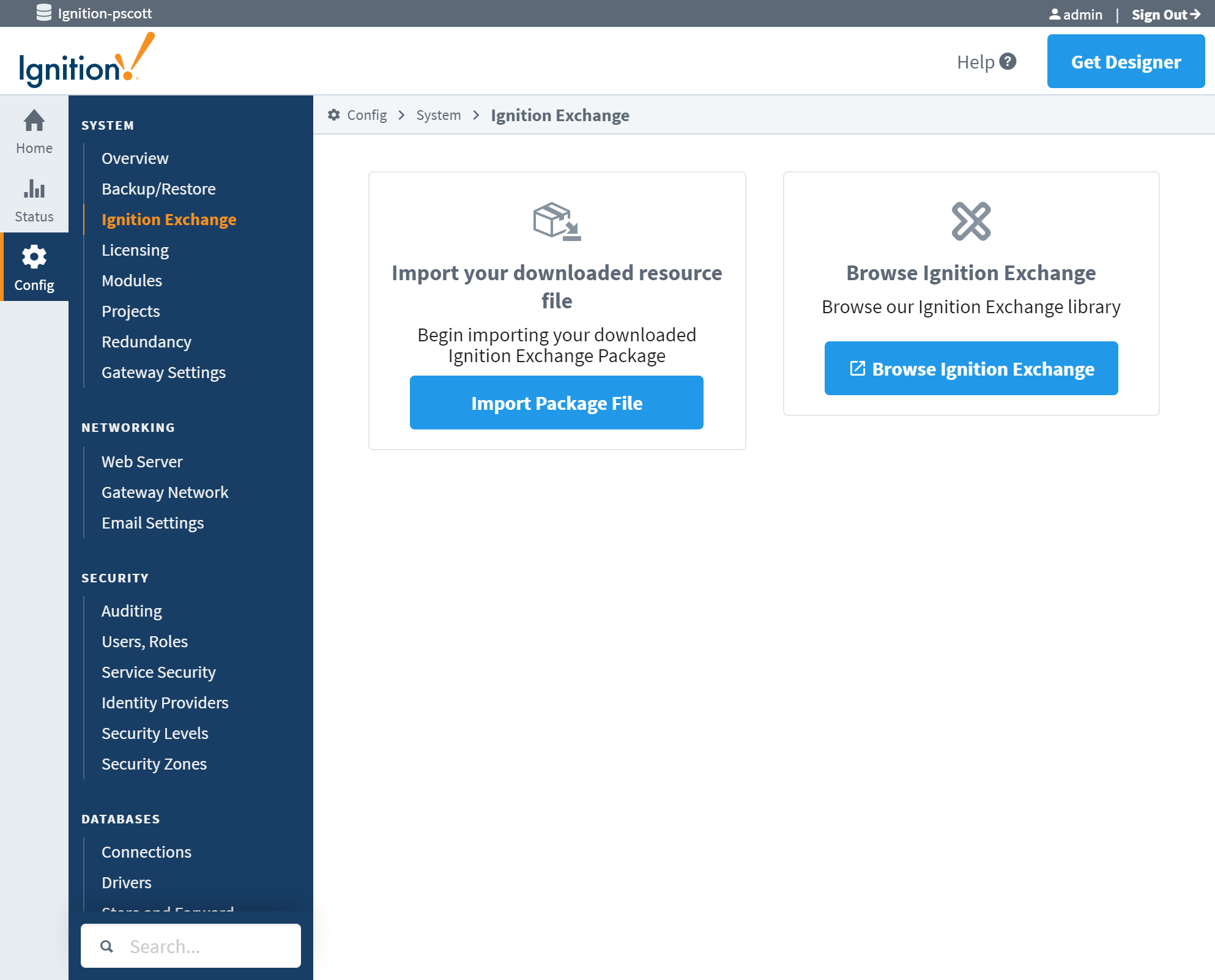

Ignition Exchange
You may have heard the exciting news about the brand-new Ignition Exchange, which we launched at ICC. If you haven’t read up on it, check out our blog post. In short, it’s a new community-driven way to share Ignition resources like templates, UDTs, and more.
The Ignition Exchange has two distinct elements: on one side is the Ignition Exchange webpage, which you can access through the homepage of the Inductive Automation site. The other side is the Ignition Exchange’s integration within the Ignition Platform, which we’ll examine more closely in this post.
Exchange package files can be imported directly into your Ignition gateway from a newly available Config page.
Ignition Exchange Webpage
The import wizard will walk you through the rest of the process! Once imported, you can access your new resources from the designer. This release brings Phase 1 of this Ignition Exchange integration, which focused on bringing the feature to life.
Phase 2, which should be completed by the next couple of minor versions, focuses on enhancing the current feature set, including:
  • Polishing the visual design of the import wizard
  • Adding support for multi-project exchange packages
  • Validating resource conflicts on import
  • Minimum module and platform version validation

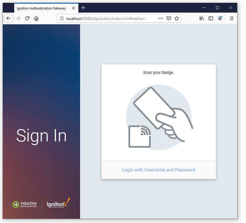

RFID support in Identity Providers
Next up is a long-awaited community request: RFID authentication support. Ignition’s built-in Identity Provider can now accept badge swipes as a means of user authentication, allowing your users to authenticate with badges!
Ignition Authentication Badge SignIn
To better support this feature, users in the Ignition User Sources now have a “Badge” setting, allowing you to associate badges with users. Alternatively, you can allow users to log in with a badge and password, instead of using a username! Now that first-class RFID support is in the Ignition Identity Provider, you can look forward to seeing the functionality brought over to other areas of Ignition in the future.

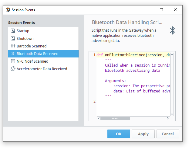

Perspective Bluetooth Support
Perspective now offers support for Bluetooth services when used with the Perspective Mobile App, allowing the app to detect advertising data from any nearby Bluetooth enabled devices in range. Once detected, the bluetooth.data Session Prop will populate, allowing you to use bindings to interact with received packets.
Additionally, there is a new Bluetooth Data Received session event, providing an ideal location for a script to parse the results.
Bluetooth Event Script

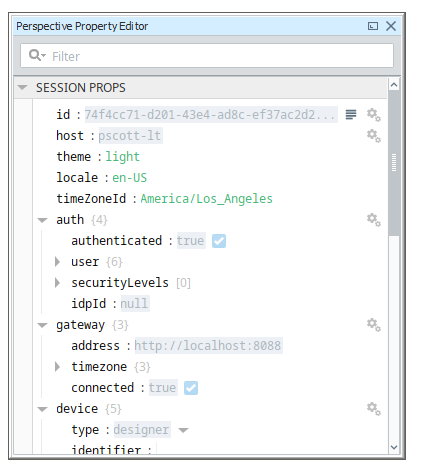

Property Protection Flags
Speaking of Session Props, you may notice in 8.0.5 that some of them have a grey background and new iconography.
Those properties have the “system” protection flag, which is another new feature introduced in this update. These protection flags allow you to restrict the browser’s ability to write or even read component properties, thwarting malicious attempts to modify property values via javascript.
Sensitive Session Props are automatically marked with the system flag, but you can add these flags to any other Perspective properties, allowing you to store sensitive data in component properties while protecting against browser access. Adding a flag is as easy as right-clicking on a property.
Ignition System Flag
