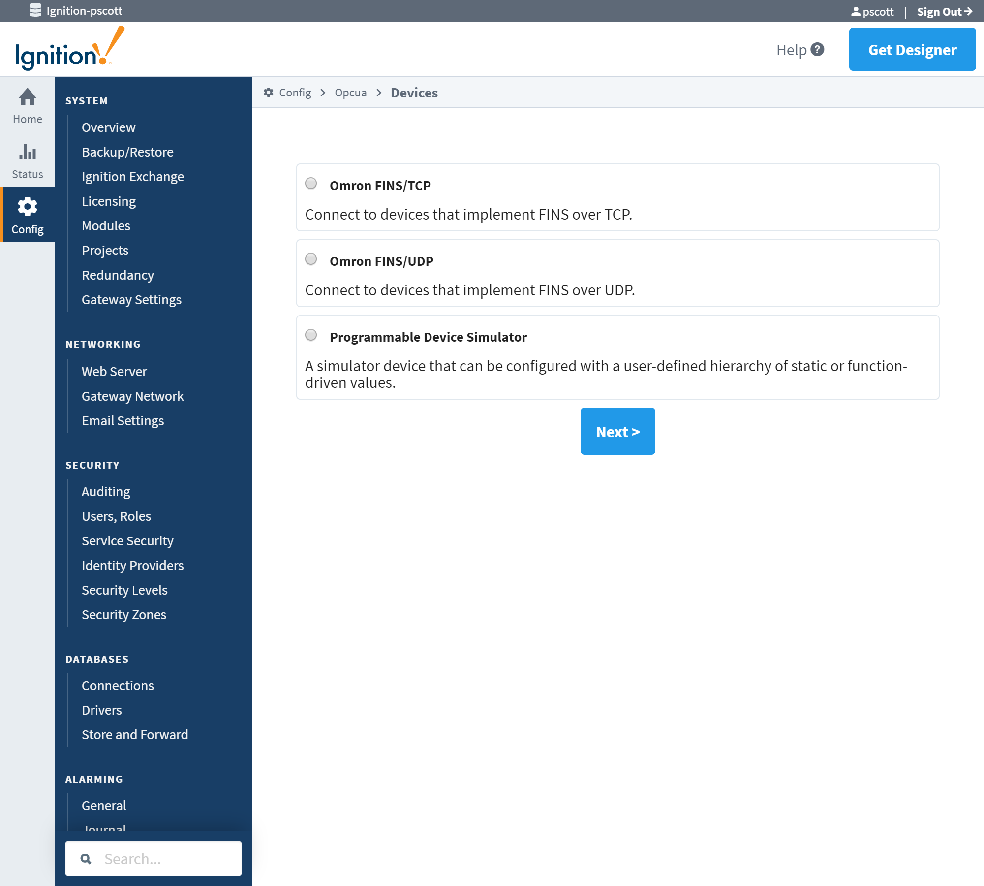

Omron FINS Drivers
First up is a new driver designed to work with FINS, an Omron protocol. We rolled out this new driver quietly on our forums first to collect some initial feedback. The driver is at a point where we’re ready to introduce it to a wider audience, and as always we’re looking for more feedback.
We already have a number of improvements in progress too. For example, extracting values from a device with the driver currently requires manually creating a tag in the Designer, but we’re already working on a Gateway page that will allow you to configure addresses easily, as well as import configurations from a file.
If you have any feedback on the driver, please let us know through our post on the early access forums.

Using the new simulator is simple. When creating a device connection on the Gateway, select the Programmable Device Simulator from the list of options. Once the device connection has been created, you can edit the program, which basically defines the tag paths and determines their values.

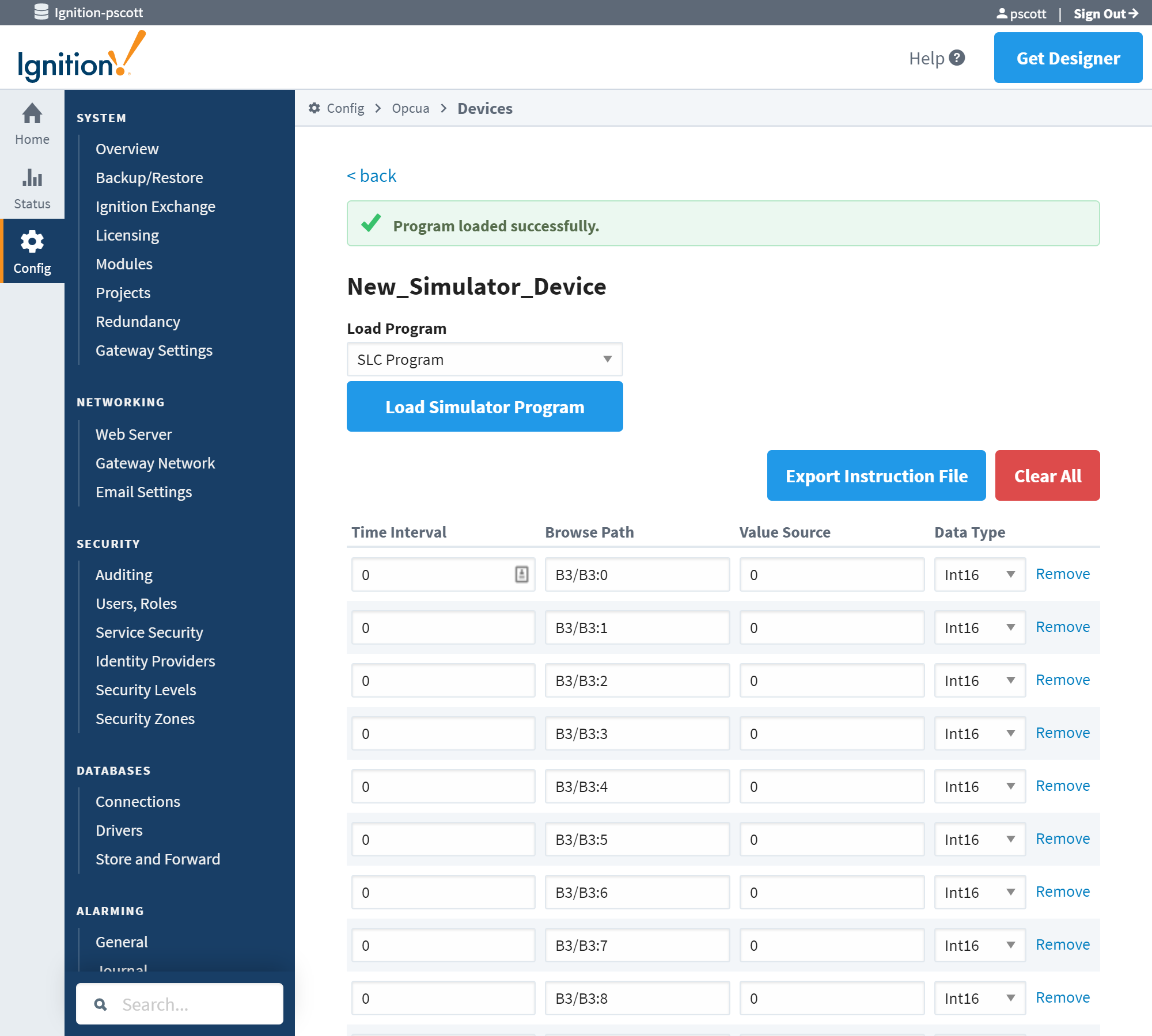

Additionally we bundled the tags from the legacy simulators (SLC, Generic, and Dairy) into the new simulator driver as loadable programs, allowing you to load the settings for one of our older drivers and then manually modify their behavior. This is a great way to learn how the new simulator works, providing an opportunity to tweak the loaded configurations.
Load Legacy
Programs in the simulator work off of time intervals. Each row in a program represents a tag at a particular time interval, and later rows will override the value set by previous rows. So a tag can have a value of 1.1 at interval 0, 2.2 at interval 1, and so on.
The program transitions between each time interval at a consistent rate, and that rate can be modified from the Designer and sessions, via the control tags. Each simulator instance receives its own set of control tags that allow for the program to be modified from the runtime. Thus you can reduce the base rate, pause the program, reset it, and make it repeat.
Lastly you can export the program to CSV, providing an opportunity to edit the program externally, before loading it back in.

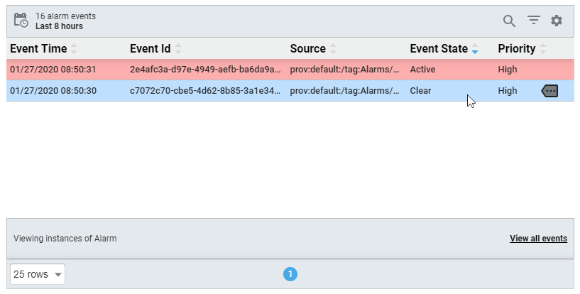

Finally, we see another beloved Vision Module component ported over to Perspective: the Alarm Journal Table component.
Alarm Journal
Similar in form to the Alarm Status Table component, with the main difference here being that the component can directly retrieve records from an alarm journal profile instead of looking at currently active alarms. We used Vision’s implementation as the basis for the Perspective component, with a few slight improvements.
Vision’s Alarm Journal Table component had a fairly narrow feature set. Any runtime configuration changes you wanted your users to make had to be added manually. That meant that if you wanted your users to be able to see events from different points in time, you needed to add a calendar component of some sort and configure the bindings yourself. The same can be said for adding priority filters or the ability to search for alarms; other components must be used for runtime configuration.
While easy to configure, it was somewhat troubling for us that our users needed to configure these small functionality improvements themselves. With Perspective’s table, we decided to add these features directly into the component, making the component more approachable initially.

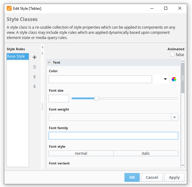

Perspective Style Editor 2.0
The dedicated style editor in Perspective was functional but lacked polish. It provided a means to start manipulating styles on components, but could be cryptic at times. A common question is “What do I type into Font Family?” since the UI didn’t give you much in a way of a hint.
Old Style Editor

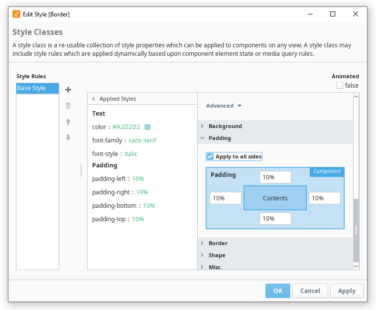

Ignition 8.0.8 unveils the first major reiteration of the style editor. We added a slew of new dropdowns for properties that had a fixed number of options (including Font Family), so you no longer have to guess what to type. In addition, we added a summary of active styling options currently configured (not to mention we added visual aids to help illustrate what many of those settings represent).
New Style Editor
Our hope is that these small changes to the style editors will make them friendlier for users new to Perspective.
