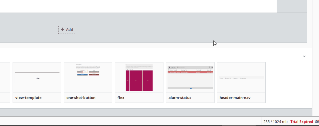

Gateway Trial Status Indicator
For any developer who’s been frustrated by not realizing their free Ignition trial has expired (and lost valuable development time as a result) — this one’s for you! 8.1.43 includes a persistent indicator in the designer to keep you informed about the status of your Gateway’s trial mode.
Now, when your two-hour trial expires, you’ll be immediately alerted via a pop-up corner notification, so that you can reset your trial and continue working on your project without missing a beat. The remaining time left in your trial will be displayed in the designer’s status bar while your trial is still valid, and once your trial expires, you’ll see a status of “Trial Expired.” And to make things as simple as possible, the status indicator includes a link to the Gateway so you can easily reset your trial.
This time-saving update will help make countless users’ workflows smoother, and it all came as a result of an Ignition user posting on LinkedIn about his desire to see this functionality come to fruition. Inductive Automation’s CEO Colby Clegg noticed the post and jumped into the conversation, saying he was sure we could do something about this. Less than three weeks later, this user’s dream of trial expiration notifications became a reality in Ignition’s nightly release.

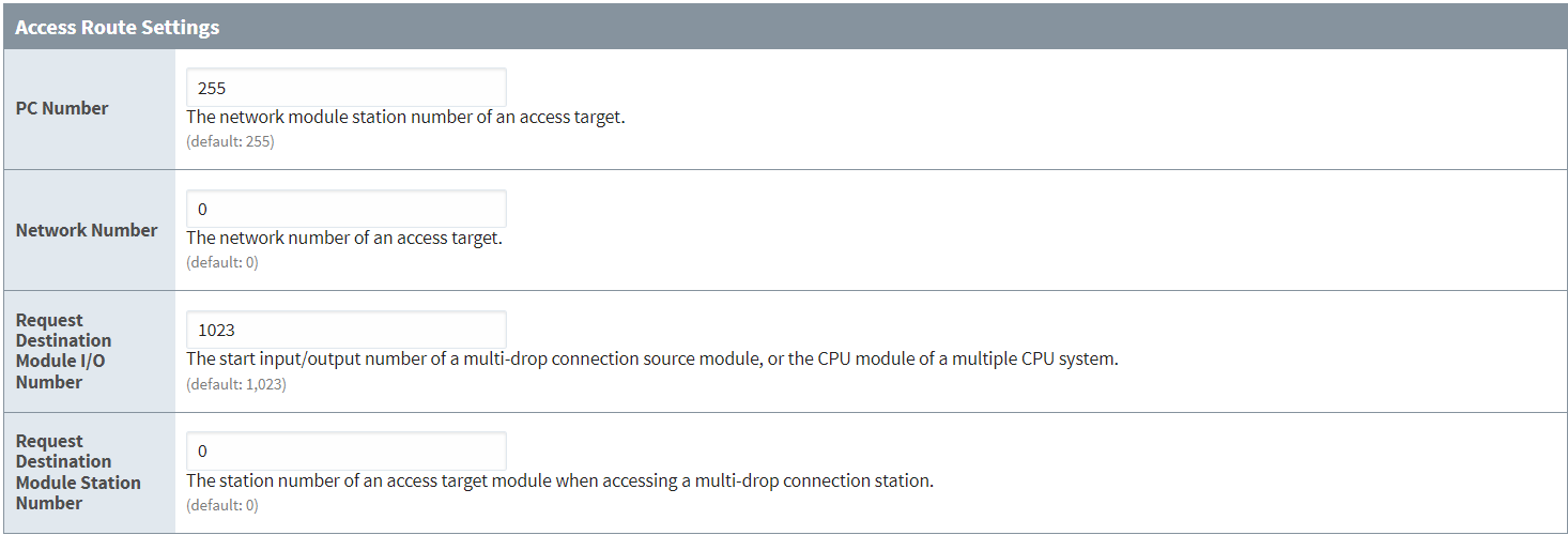

Mitsubishi Driver Configurable Settings
We added new functionality to Ignition so that you can now configure MELSEC Access Route settings in the Mitsubishi Driver. Previously, these settings were hardcoded, but we’ve implemented this update to offer users greater control.
The new options let you target PLCs in a multi-drop configuration as well as specific CPU modules in multi-CPU systems. This ability would let you, for example, add a station number so that your Ignition system could communicate with sub-PLCs (rather than only being able to communicate with the main PLC). Ultimately, the increased configurability makes it easier to customize your architecture to your precise needs.
