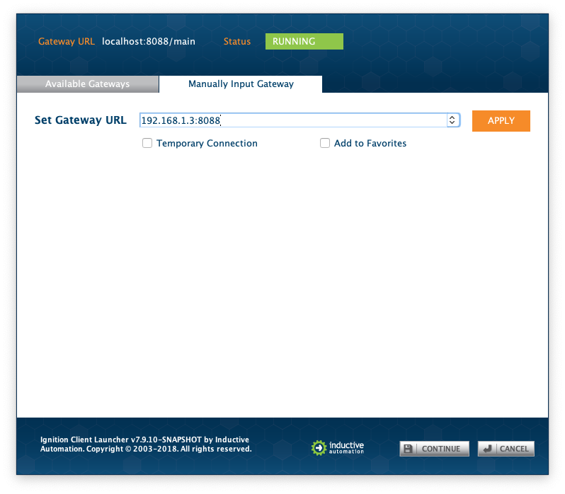

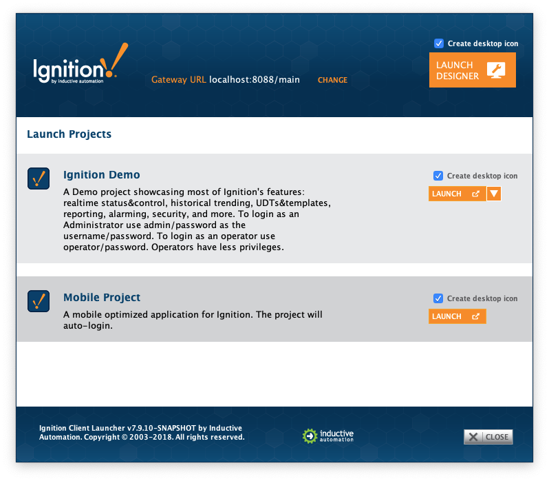

Native Client Launchers
We capitalized on the end of Java Web Start by embedding a minimized version of Java in the Native Client Launchers, which then checks with the Gateway and downloads a local copy of Java for the client if needed. This means the client does not need to have Java installed before you launch a client, and you won’t have a problem if there is a version of Java installed that’s not compatible with Ignition. Plus, your clients and designers will always have the correct version of Java, one which we’ve tested with Ignition. This should make using Ignition a smoother experience both for your users and your IT department.
