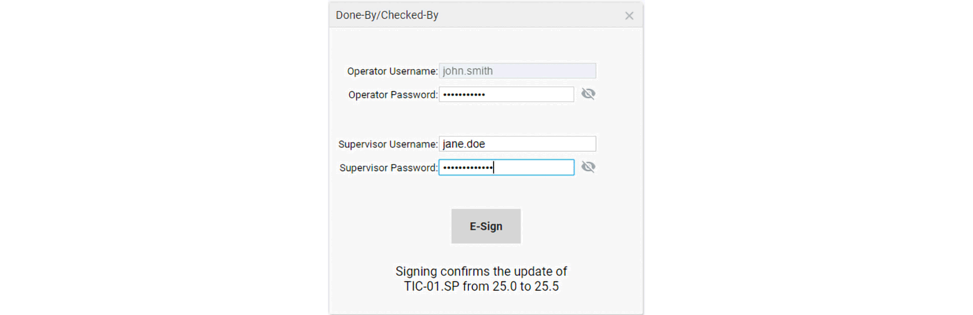

E-Signatures can be added to Ignition projects that require extra confirmation of user permissions. Utilizing the system.security.validateUser() function, users can be forced to provide their credentials before critical actions are performed. Multiple signatures can be required per action without logging off the current user, allowing a supervisor to E-Sign to confirm an operator action. Combining these credential validation methods with Ignition’s audit trail feature ensures that user interactions with Ignition projects are thoroughly controlled, attributable, and accurate. Roles can be utilized to ensure a hierarchical security structure, ensuring that critical audit and data integrity features cannot be altered.

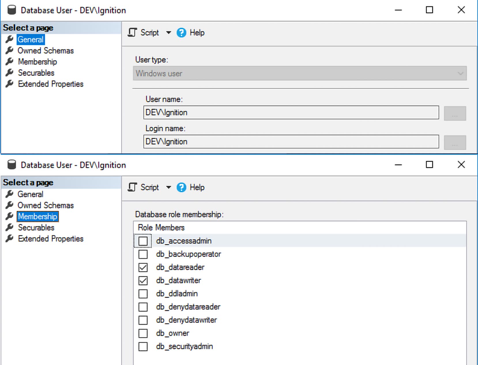

Ignition uses databases for the Tag Historian Module, alarm journal, and audit trail, as well as when utilizing expanded functionality for project-specific purposes. Although Ignition supports connections to multiple database types, the following security considerations generally refer to Microsoft SQL Server. For security-conscious configuration details of other database types, consult with your database administrator (DBA).
To ensure data integrity of SQL databases, logins and permissions must be strictly configured for each database. An exclusive account should be configured for Ignition to connect to SQL with “read/write” access. No other users should have “write” access, as this would allow tampering with historical and audit trail data. This account should be an Active Directory managed account where possible, and the account username and password information should be shared sparingly to avoid non-Ignition use of the account. The account should only be used for this single purpose so that the password can be reset if needed without disrupting other applications or services. The built-in “sa” account should never be used for the database connection.
Other users can be configured with read-only access to databases for querying data; however, any validated data provided by the system should be presented as read-only reports. Tools and controls are available within Ignition for creating displays to review data, such as trend charts and customizable tables. Tools are also available to generate reports to be printed or exported in read-only formats like PDFs. This allows standard validated report templates to be reused with minimal testing required. Since the report data is read-only from the data source and read-only in file type (pdf), data cannot be tampered with, contrary to processes that utilize spreadsheet-based data exports that do allow potential data tampering.

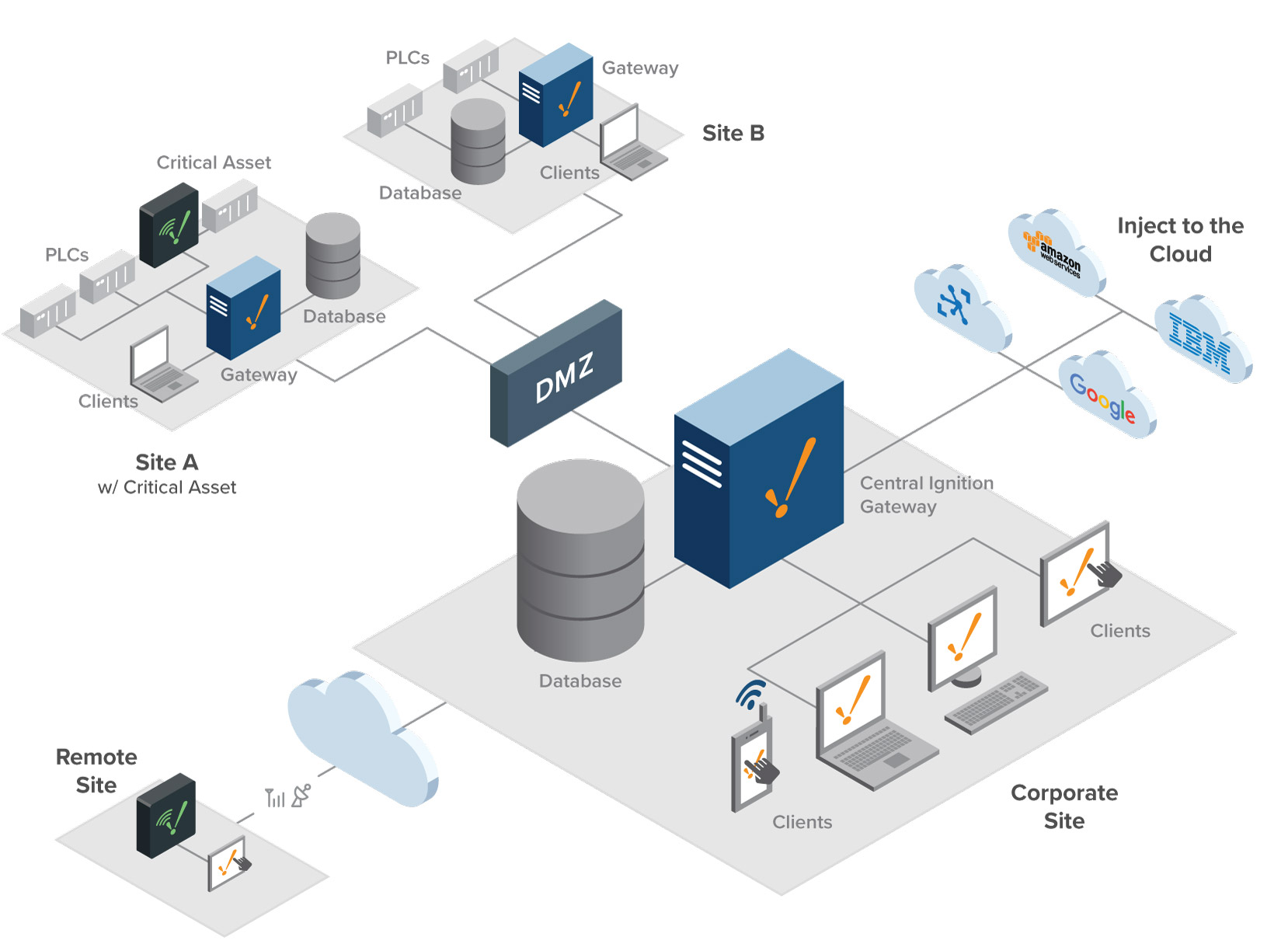

To further enhance data integrity within Ignition, the design of the network and related components should be considered. In an ideal setup, process equipment should be located on a network that is separate from office systems such as end-user computers. This segregation ensures that validated systems and their data cannot be tampered with intentionally or inadvertently by users who should not have access to them. In such a setup, firewall rules can be applied to allow only specific required access to Ignition between the two networks. For example, specific network ports can be opened so that users on the office network can access an Ignition client to view report data, but not access the equipment the data originated from.
When configuring connections to data sources in Ignition, unique non-expiring system accounts and passwords should be used where possible; use of anonymous connections should be avoided to ensure traceability of audit trail and log information. Secure encrypted protocols such as OPC UA are preferred to ensure data integrity across the network. Direct connections are preferable to indirect connections (such as passing data across multiple OPC servers). By keeping architectures simple, configuration and communication issues can be avoided that could otherwise impact the integrity of end data.

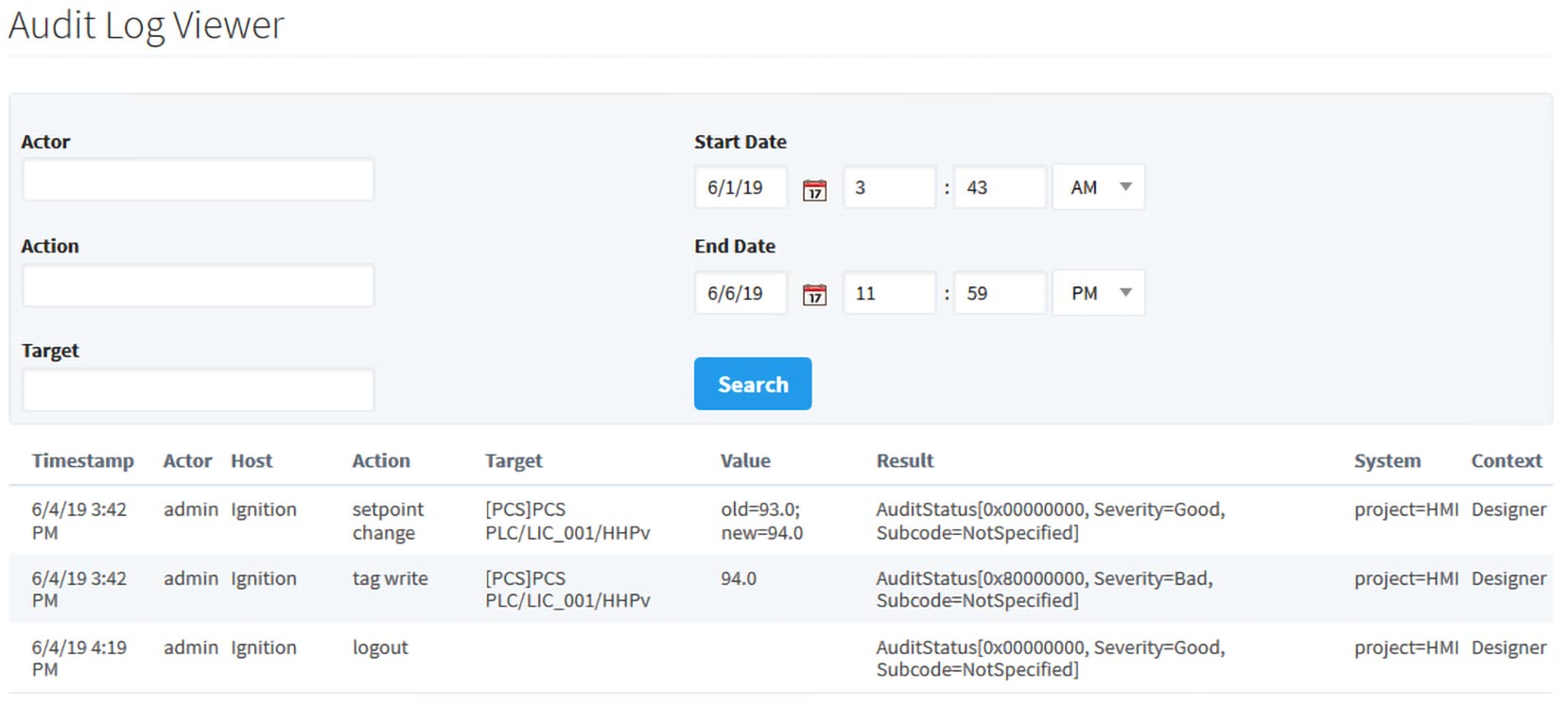

Ignition provides an audit trail to record contemporaneous logs of user actions within the system. Multiple audit profiles can be created and applied to projects based on specific user requirements and retention periods. By default, Ignition will record a timestamp, username, computer name, and details about each audited action. Default audited actions include tag writes, SQL commands (UPDATE, INSERT, DELETE), project changes from the Ignition Designer, and user login/logout events.
Because the audit trail information is stored in a SQL database, the default audited actions can be extended. During any scriptable event or binding (for example, clicking a button to switch a system from Auto to Manual mode), a SQL INSERT query can be configured to add an event to the audit trail. Security challenges or E-signature events such as “Done By” and “Checked By” information can be added to every scriptable event within the audit trail. By configuring these actions in a template object, audited actions can be simply applied throughout the project without redundant configuration or validation testing. Audit trail data can be reviewed from the Ignition Gateway or queried and presented in tables or reports.
A common example of extending the Ignition audit trail is recording when a user has changed the value of a setpoint from an HMI. For this action, a text input component would be configured within a template. Using event handlers on this component, a script is utilized to detect when the value of the text field is changed. When the value is changed, a query is executed to insert an entry into the audit database table. All fields can be filled in to match built-in audit events, including the current user, current host name, and timestamp. In this example, the “action” field can be populated as “setpoint change”, and the “value” field can be populated with the old and new values for the setpoint. With this configuration completed inside a template, it can be reused throughout the project without extra configuration or testing.
