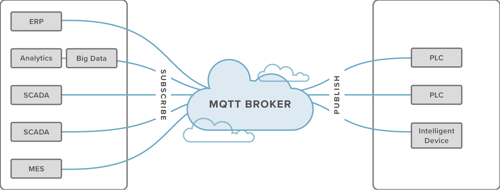

Most common IIoT protocols fall into two categories. One category is the publish-and-subscribe (pub-sub) protocols which connect and publish data to a topic on an intermediary broker. MQTT, AMQP, DDS, and XMPP are examples of pub-sub protocols.
The other category is the poll-response or client-server protocols, such as Allen-Bradley, Omron, and Modbus, in which clients continually connect to the server and make requests to determine if any data has changed.
Of the two categories, which one should you choose? To effectively build a highly scalable solution with a high level of efficiency, it is best to adopt a publish-subscribe communication protocol. Rather than connecting applications directly to devices, publish-subscribe protocols decouple devices and allow applications to connect to middleware. Through middleware, you can connect any application that requires data from any device without placing any heavy demands on the network.
From the list of available protocols in the pub-sub category, we highly recommend using MQTT. More than just a protocol, MQTT is the foundation for building your new architecture, making IIoT a reality today.

Decoupled Applications & Devices

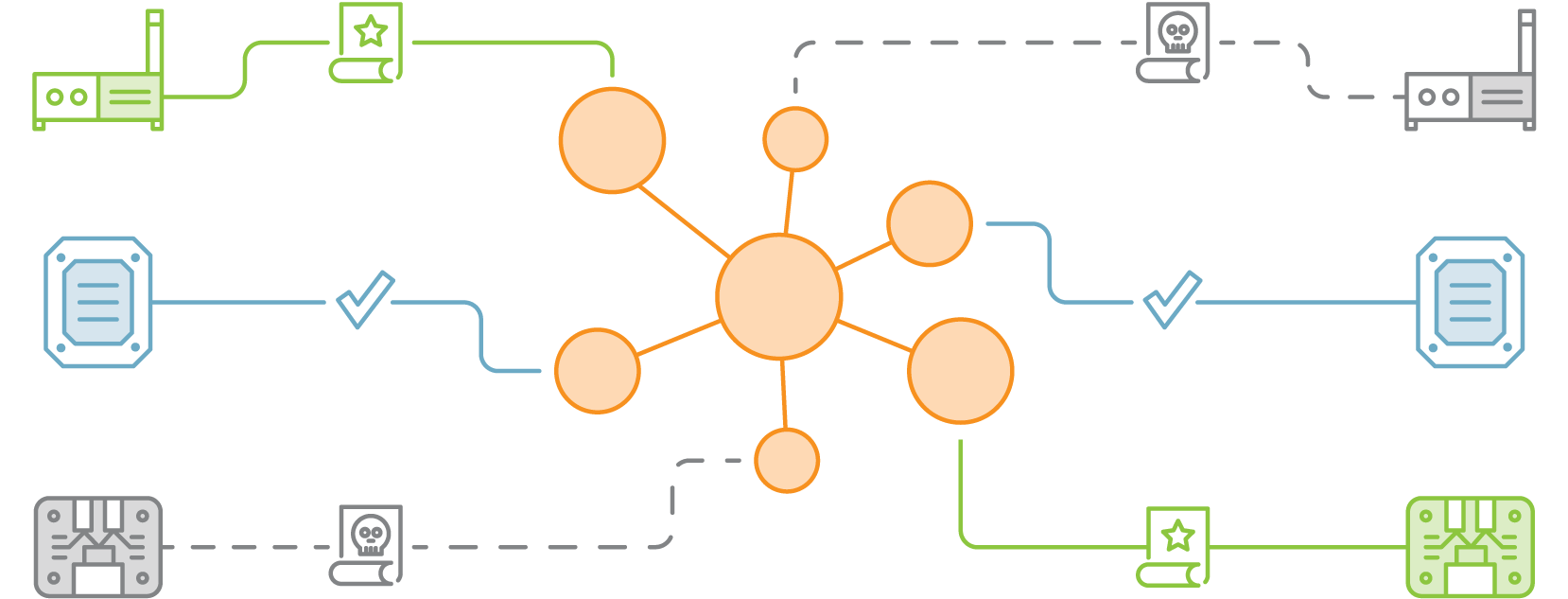

MQTT's Built-In Stateful of Awareness
With its low-bandwidth publish-subscribe methodology and TLS security, MQTT has proven to be a formidable IIoT communication protocol. Another feature that is critical to your IIoT infrastructure is the stateful awareness that is built into MQTT.
Stateful Awareness is Important for IIoT
Stateful awareness is important for SCADA systems, especially for remote installations.
Knowing the health of the device and the network connection helps to mitigate any downtime and ensures data is being shared with all levels of an organization. By having stateful awareness, data becomes more stable, reliable, and contextual.
Most enterprises still depend on legacy poll-response communication protocols to be able to know the state of the network connection between devices and the SCADA system. Unfortunately, devices must be polled frequently to determine whether or not a network connection is good, which can put a strain on the system.
Stateful Awareness is Built Into MQTT
MQTT has stateful awareness built in and it is the only stateful architecture available. It is designed with a “last will and testament”: if the device stops working and falls off the network, then the MQTT server will publish a “death certificate” and the device will be marked as being unable to publish data. On a larger scale, with thousands of devices connected to the MQTT server, it is important to know within seconds the state of each device: whether it is online and ready to publish data or if it is unavailable.
Let’s say that you’re using the Ignition platform with an MQTT server and an MQTT client. When a device connects to an MQTT server, it registers its state and then it registers its last will and testament. Ignition and the MQTT client will know that the devices are online and will deliver information if and when it changes. In the event of hardware failure or environmental issue, the MQTT server will publish the fact that the device is no longer available. In Ignition, those tags are represented as stale data and the device is marked as unavailable. When the device comes back online, it republishes its birth certificate. The MQTT client knows that the device is available, and Ignition shows the updated tags and the device’s availability.
Stateful Awareness Improves Processes
Stateful awareness is a subtle but powerful feature of MQTT. There are many MQTT implementations that are stateless, but for SCADA implementations, stateful awareness is essential. MQTT uses reporting by exception (RBE), which is made possible by stateful awareness. Data is only sent when there are changes to the state of the device or when data values change, which reduces the amount of useless data taking up bandwidth resources.
Knowing the device state is valuable since it helps to provide context to the data. Operators, especially, can keep track of devices and quickly pinpoint any trouble spots without having to send a technician out to a location to verify an issue. On the organizational level, data can be verified to be up-to-date and accurate.

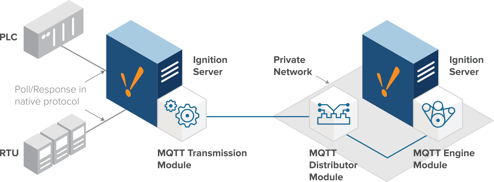

Ignition architectures with MQTT are comprised of several elements: edge devices, MQTT servers, and MQTT clients. Each of these elements plays an important role in your ability to take a legacy system and migrate into a cutting-edge SCADA system.
Edge-of-Network Devices
The edge-of-network device is the first important component of the MQTT architecture. Edge devices which include edge gateways (also known as directors) allow you to communicate to legacy devices such as PLCs and RTUs, to collect tag and state data, convert it to MQTT, and publish that data onto an MQTT server. Edge gateways, along with MQTT, allow you to decouple devices from applications, thus improving bandwidth usage.
There are four methods for implementing an edge-of-network device. The first method is to use a dedicated edge gateway to bridge legacy devices to new devices or to an MQTT server.
The second method is to install a brand-new edge device that natively communicates via MQTT. Several manufacturers are now embedding the Sparkplug specification onto their devices, allowing for direct communication with an MQTT server.
The third method is to use the Cirrus Link MQTT Transmission Module on an Ignition server. The MQTT Transmission Module turns the Ignition server into an edge gateway, allowing you to collect and publish edge data to the MQTT server.
The fourth method is to use Ignition Edge MQTT, a limited, lightweight Ignition solution that turns touch panels, client terminals, or virtually any embedded PC or field device into an MQTT-enabled edge gateway.
MQTT Servers
The second piece of the architecture is the MQTT server, often called the broker. This is where the message-oriented middleware (MOM) resides. All edge-of-network devices in the MQTT architecture publish MQTT tag and state data to the MQTT server. The MQTT server then enables MQTT clients to securely connect and subscribe to the device’s published data.
Since MQTT is an open standard, there are many companies making their own brand of MQTT servers. For example, there’s AWS IoT from Amazon, Azure IoT Hub from Microsoft, and Chariot from Cirrus Link, as well as HiveMQ, CloudMQTT, Red Hat AMQ, and VerneMQ. There are many options to choose from, whether it be a locally hosted or cloud-hosted solution.
As a best practice, use the Cirrus Link MQTT Distributor Module for Ignition. The MQTT Distributor Module is launched by the Ignition Gateway and is a small, self-contained MQTT server. It provides you with a complete MOM solution that is best suited for an on-premise MQTT infrastructure with a limited number of edge-of-network devices. The module provides rapid development and is ideal for situations where communications are restricted or costly. It’s designed to simplify and speed up the process of getting a complete MQTT infrastructure going. It’s also very effective at increasing data throughput for high-performance plant-floor solutions.
MQTT Clients
The third piece of the MQTT architecture is the MQTT client, which connects to the MQTT server and subscribes to one or more topics of information, bringing that data right into an application.
While there are many MQTT client tools available, it is recommended to use the Cirrus Link MQTT Engine Module for Ignition. The MQTT Engine Module is the key component that enables Ignition to act as a native MQTT citizen.
The MQTT Engine allows the Ignition platform to communicate bidirectionally with MQTT-enabled edge-of-network devices via the MQTT server, which can be sent securely all the way down to the device. It takes data from the MQTT server and injects it into industrial SCADA applications.
