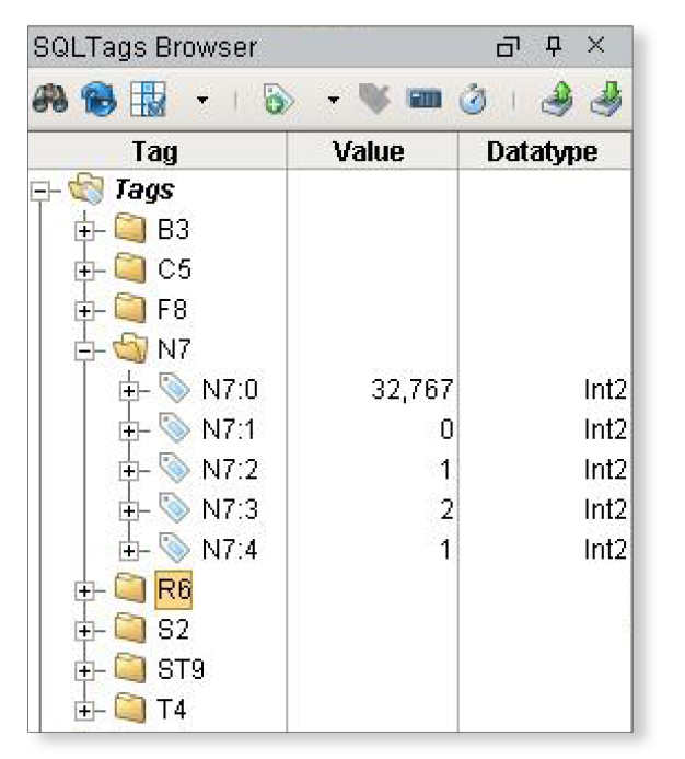

Tag Organization
SQL Tag Browser
Upon connecting to a PLC, the individual tags of the PLC can be seen in your design environment. Each SCADA application handles this differently, but many have a tag browser where tags can be managed and organized. In order to make working with tags easier it is important to take the time to organize them. This is especially true if your project has to connect to numerous PLCs and deals with a large number of tags.
While some of the newer PLCs have their own organization for tags, you should not necessarily rely solely on that. Organize your tags in a way that makes sense for the project and screens.
Keep in mind that it needs to make sense to you, as well as the next person who works on the project. Otherwise, the next person to make changes may get lost in your tag organization.
Use folders to create a hierarchy of tags. For your main folders, start with big categories such as line 1 and line 2. Then use sub-folders inside your main folder to further categorize the information. Ideally, your folder organization should be clear enough that someone could easily navigate to a specific tag without knowing too much about the project. Making individual tags easy to find can save you a lot of time hunting for the right tag on the PLC.

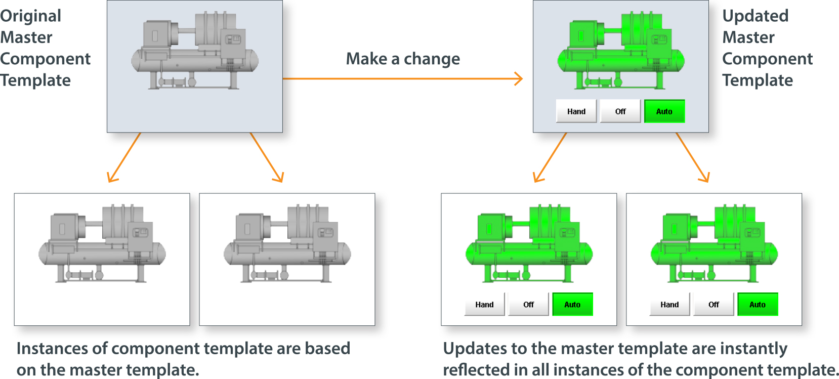

Leveraging the power of templates when building your HMI / SCADA project is one of the most powerful time-saving activities you can do. Fully utilizing templates is one of the hallmarks of a true HMI / SCADA project development professional. You’ll save time in two significant ways: cutting development time in the short term, and reducing development time in the long-term.
Advantages of Using Templates
Advantage #1
Utilizing templates correctly can cut down development time to a fraction of what it would take to build each element manually. You can put a template together once and then use it over and over again. This can save an enormous amount of time while building a project. However, the truth is that an HMI / SCADA project is never “finished”, it’s very common for a project to be frequently updated to fit the changing needs of its users. This is where the next major time-saving aspect of templates comes into play.
Advantage #2
The second advantage is that templates can help you future-proof your project. Templates are built on the idea of creating a master template that affects all the other instances where the template is used. If you make a change to the master, that change is reflected everywhere that template is used throughout the project.
This is a huge benefit when making changes to your project in the future. If you want to change the way a template looks or works, it can be done all in one place – instead of having to manually make a change in multiple places throughout the project. A project built upon templates is very flexible and easy to update, resulting in enormous time savings when you’re called back in for future project development tasks.
Using the Right Template for the Job
To take full advantage of templates, you must plan for them. Templates must be part of your project development strategy. Do an evaluation of the functions your project will need to perform and the information it will need to display. Referencing other HMI examples can help you build templates that better fit your HMI project as well.
Any repetition in your project is an opportunity to use a template to cut down on project development time. Next, let’s discuss some different types of templates you can use when designing your project.
chart
Component Templates
A “component” is a fairly general term in the context of an HMI / SCADA project. It is essentially an object that performs some kind of function in the project. A component can range in complexity from the humble button or the common pump to a powerful chart or table. Components are the basic building blocks for constructing HMI / SCADA projects.
A component template is exactly what it sounds like: It is a component that can be saved and used over and over again throughout the project, eliminating the need to recreate it each time.
To take advantage of this feature, make sure you are using HMI / SCADA software that has this ability. Create a new component and then save it as a template. Once saved, the template can simply be dragged into the project screen to instantly recreate the component.
If you need to make any changes to the component template, just open the master template, make a change, and watch as the change is instantly propagated to every instance of the template throughout the project.
To effectively use component templates, create a library of them to use throughout the project. When you begin the design phase, review your project plan to find any cases where the same component will be used repeatedly. Spend time at the beginning of the design phase to create a new template for each of these components. Once you finish you will have assembled your own component template library. With a full library at your disposal you will be able to speed through the process of developing the rest of your project screens.

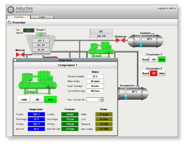

Construct Parameterized Windows
Leveraging the power of parameterized windows is a very effective tip for quickly and efficiently developing HMI / SCADA projects. A parameterized window is a blank project window that is populated by information that the user “defines” – usually by selecting something in the project to view.
To illustrate how and why you might use a parameterized window, it’s easiest to look at a simple HMI example. Let’s say that on your project overview screen is a display of several of the compressors on your plant floor. When you click on one of the compressors – let’s say compressor #1 – a pop-up window appears. The pop-up window displays more detailed information for compressor #1 as well as a start / stop button.
After you are done with that window, you close it and then click on compressor #2, and a similar popup window appears with exactly the same type of information and functionality that appeared on the pop-up window for compressor #1.
To the user, the two pop-up windows appear to be two separate but identical windows with the information for each compressor. In actuality, the two pop-up windows are one and the same; the only thing that changed was the data that was displayed to the user. The user “defined” what they wanted to see by clicking on a button (for compressor #1 or compressor #2), and the window displayed the information the user defined based on the parameters established for the window.
Data is passed to the window through a technique called indirection. Indirection is a way to link together project windows with data sets in a relative way instead of an absolute way. Instead of telling the window the exact location to look for data – like you would tell someone your specific address to find you – indirection tells the window where to find the data relative to where the window is located in the project’s file organization scheme.
You could approach the creation of this type of popup window in two ways. On one hand, you could create each pop-up window separately for the entire project, but on the other hand you could create one parameterized window and simply use it over and over again. This can be a huge time saver, especially when working on a large project that has hundreds of such windows.
