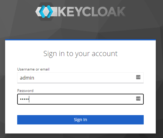

3. Login using credentials defined in Docker run command.
username: admin
password: admin
![admin](/blog/sites/default/files/inline-images/image4_12.png)

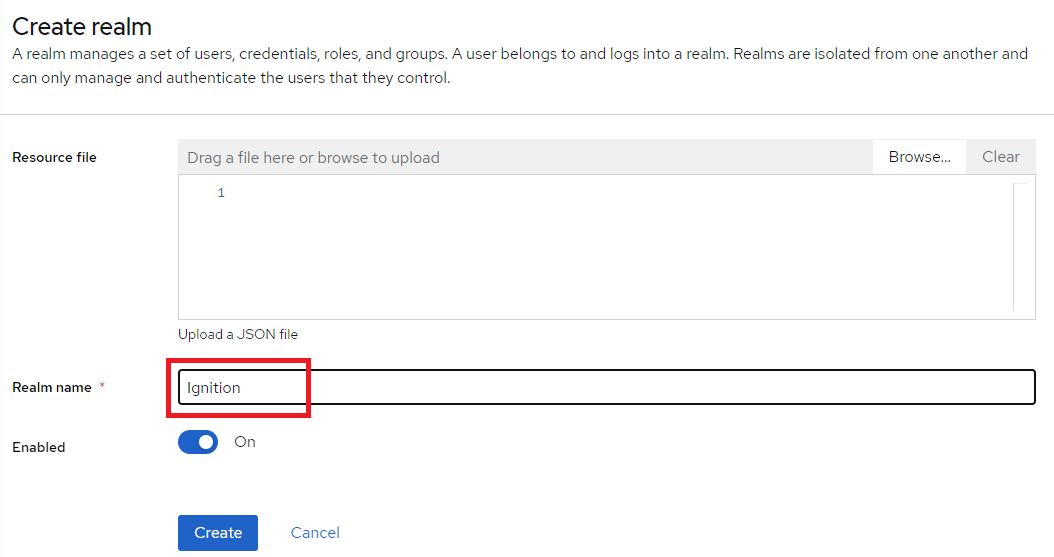

2. Name the realm ‘Ignition’ and click Create.
![Realm Name](/blog/sites/default/files/inline-images/image42.png)

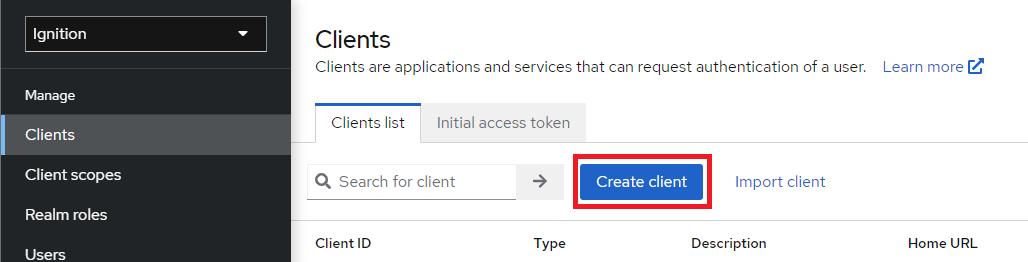

3. Select the newly created Ignition realm from the dropdown. In the Clients tab, click Create client.
![Create client](/blog/sites/default/files/inline-images/image44.png)

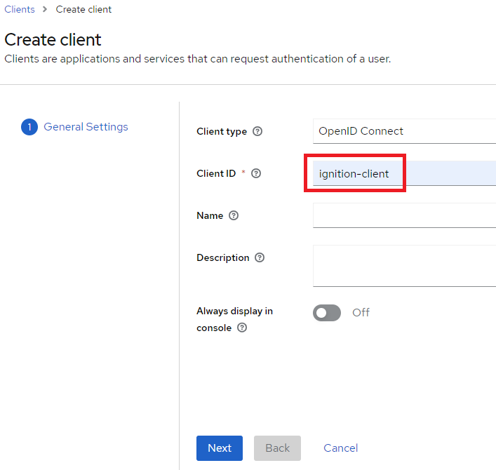

4. Select OpenID Connect as the Client type. Enter ‘ignition-client’ as the Client ID. Click Next.
![Client ID](/blog/sites/default/files/inline-images/image61.png)

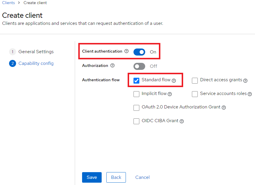

5. Set Client authentication to On and Authentication flow to Standard flow (disable others unless desired) , and click Save.
![Client Auth](/blog/sites/default/files/inline-images/image43.png)

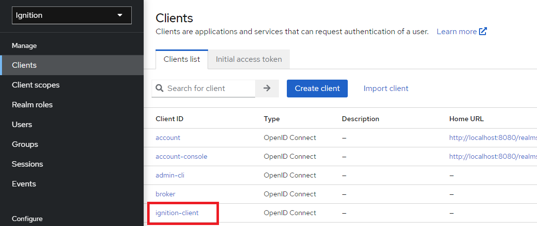

6. From the Clients list tab, select the new ignition-client.
![ignition-client](/blog/sites/default/files/inline-images/image8_2.png)

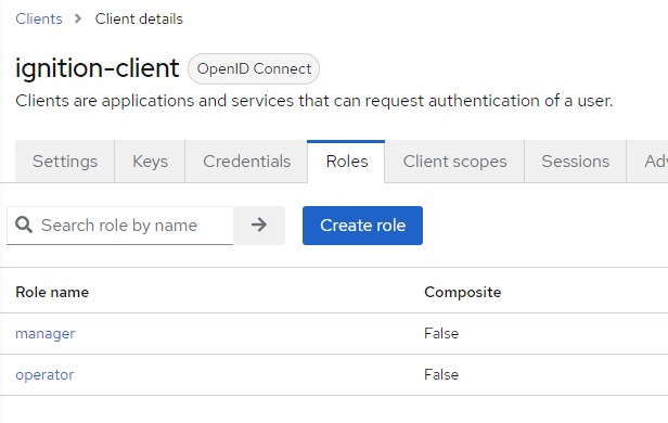

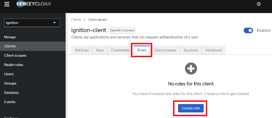

7. Select the Roles tab and click Create role.
![Create role](/blog/sites/default/files/inline-images/image38.png)

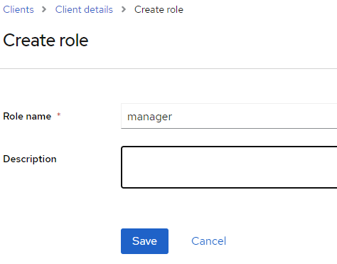

8. Create a new role called ‘manager’ and click Save.
![manager](/blog/sites/default/files/inline-images/image19.png)
9. Following the same process, create another role called ‘operator’. Two roles should be available for the client name ‘ignition-client’.
![operator](/blog/sites/default/files/inline-images/image64.png)

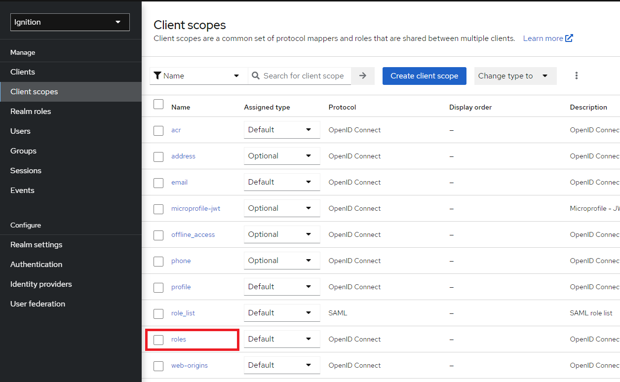

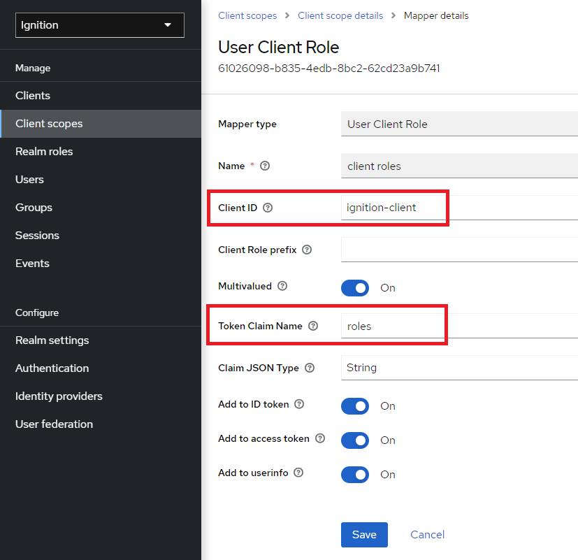

10. Once the roles have been created, the client needs to be configured to pass the roles, along with the response, when authenticating a user.
Navigate to Client scopes > roles.
![Client scopes > roles](/blog/sites/default/files/inline-images/image30.png)

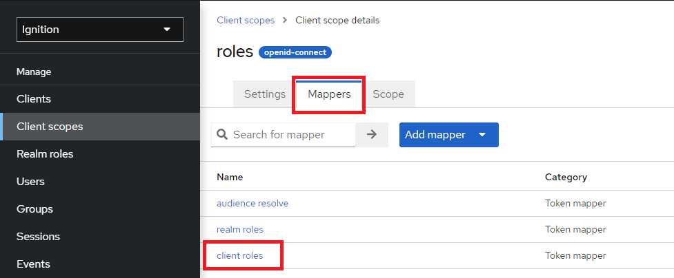

11. Select the Mappers tab, then select client roles.
![Mappers](/blog/sites/default/files/inline-images/image24.png)
12. For Client ID, select the ignition-client from the dropdown. Next, set the Token Claim Name to ‘roles’ only, which will make parsing the roles simpler in the Ignition User Attribute Mapper.
![Token Claim Name](/blog/sites/default/files/inline-images/image17.png)

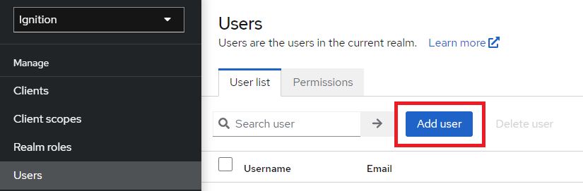

13. Navigate to the Users tab to create some new users for the Ignition realm. Click Add user.
![Add user](/blog/sites/default/files/inline-images/image21_0.png)

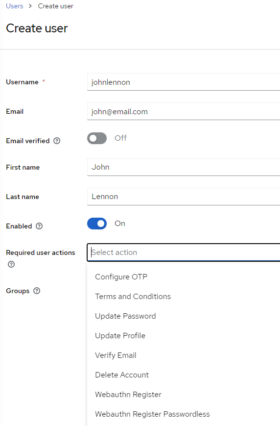

14. Create a new user. Note some of the options for required user actions, such as OTP. These will be discussed later in the document. Leave this blank for now.

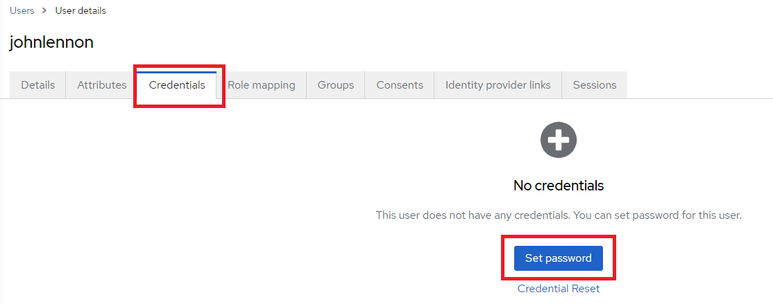

15. Once the user has been created, navigate to the Credentials tab for that user and select Set password.
![Set password](/blog/sites/default/files/inline-images/image2_23.png)

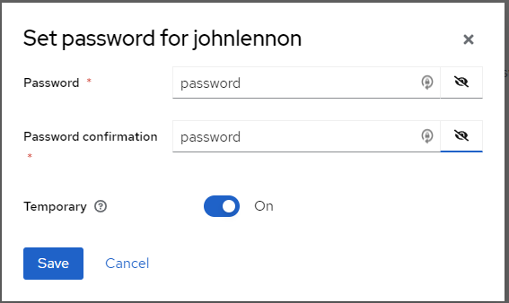

16. Set the initial password for the user. Leave Temporary set to On. This will force the user to create a new password on initial login. Click Save.
![Temp Password](/blog/sites/default/files/inline-images/image54.png)

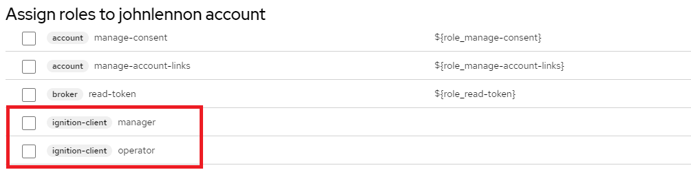

19. Select either one or both of the ignition-client roles for the user, and then click Assign.
![Assign roles](/blog/sites/default/files/inline-images/image12_1.png)

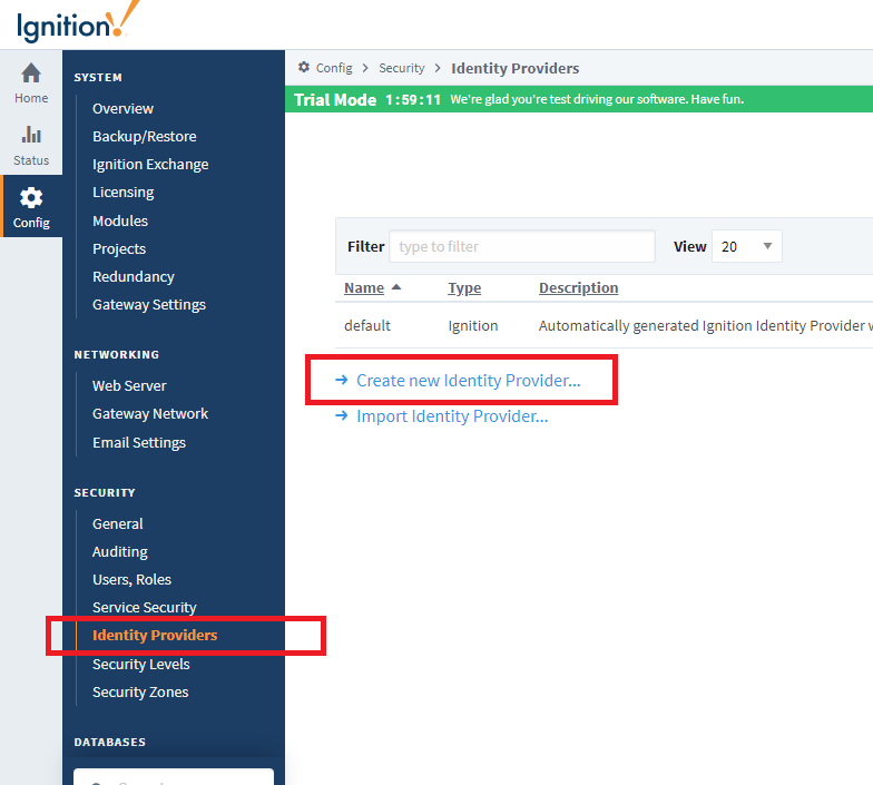

1. Open the Ignition Gateway page, login, and navigate to Config >Security > Identity Providers. Select Create new Identity Provider…
![Create new IdP](/blog/sites/default/files/inline-images/image26.png)

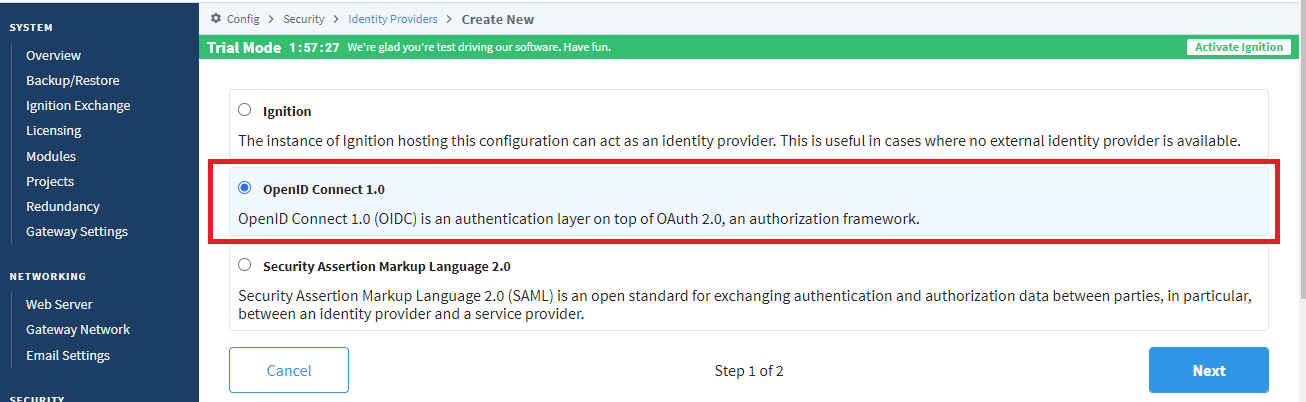

2. Select OpenID Connect 1.0 and click Next.
![OpenID Connect 1.0](/blog/sites/default/files/inline-images/image34.png)

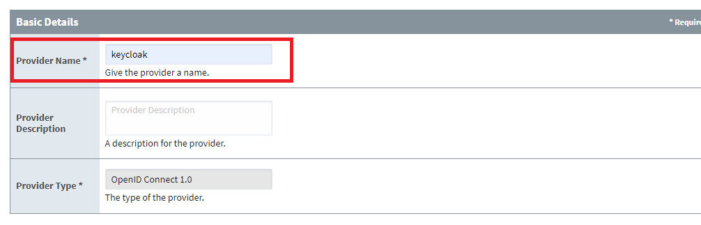

3. Enter in the Provider Name as ‘keycloak’.
![Provider Name](/blog/sites/default/files/inline-images/image7-1.jpg)

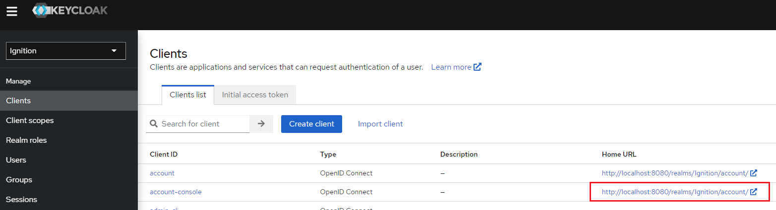

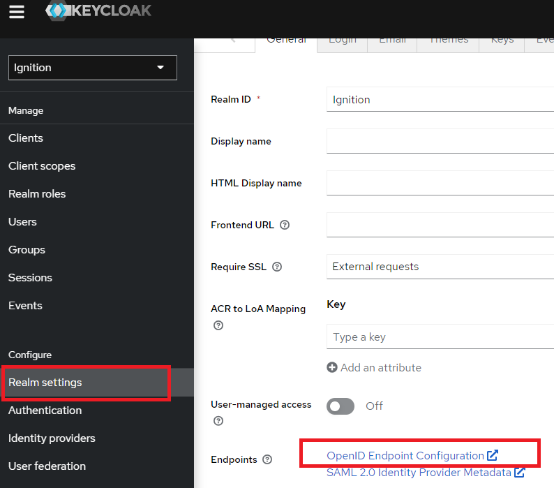

4. For the Provider Metadata, return back to Keycloak and navigate to the Ignition realm Realm Settings. Click on the OpenID Endpoint Configuration link. This will open a browser window. Copy and paste the endpoint URL.
NOTE: It is strongly recommended that Require SSL be enabled in Keycloak for all requests in a production environment.
Default endpoint:
http://localhost:8080/realms/Ignition/.well-known/openid-configuration
![OpenID Endpoint Config](/blog/sites/default/files/inline-images/image6_7.png)

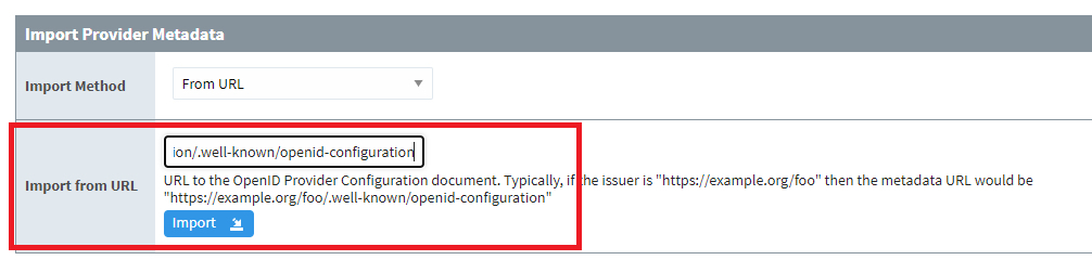

5. Once the URL has been pasted into Ignition, click Import. Ignition will respond with a successful or failed import of the metadata.
![Import from URL](/blog/sites/default/files/inline-images/image7-2.jpg)

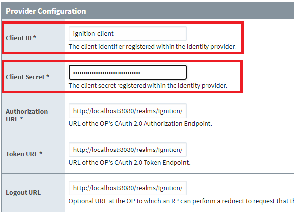

6. There are two additional parameters for the provider configuration that need to be manually entered. These are the Client ID and Client Secret. The Client ID is the client created in Keycloak, which is called ‘ignition-client’ for this example.
![Client ID & Client Secret](/blog/sites/default/files/inline-images/image48.png)

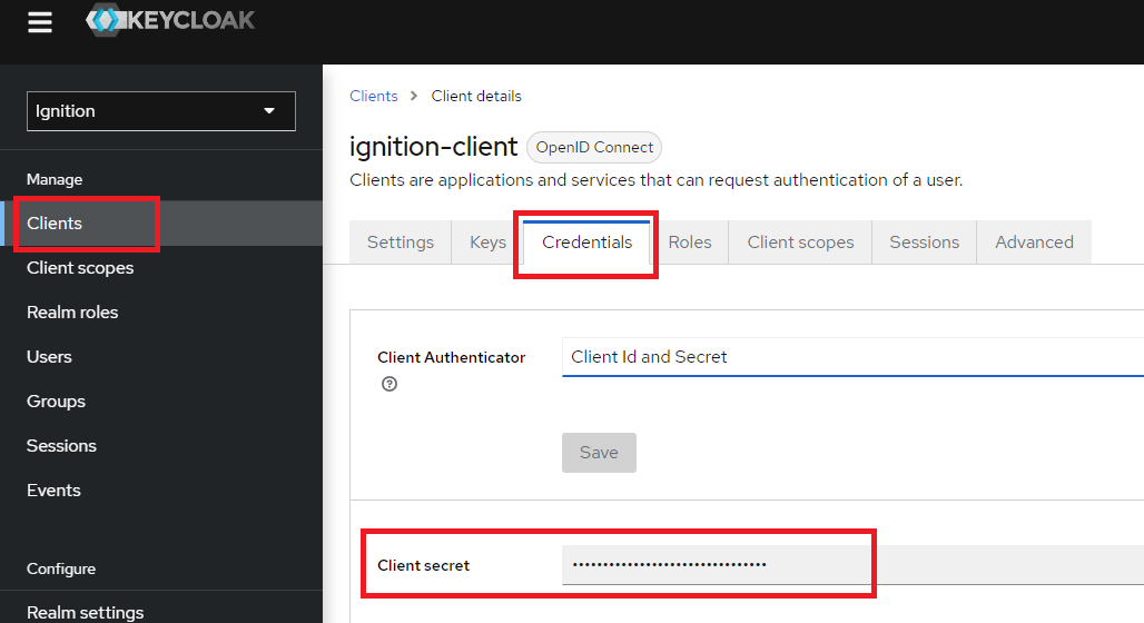

The Client Secret is found in Keycloak by navigating to the Clients > ignition-client > Credentials tab in Keycloak. The Client secret can be copied from here and pasted back into the provider configuration in Ignition.
![Client secret](/blog/sites/default/files/inline-images/image47.png)

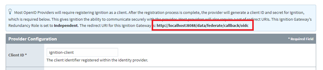

7. Locate the redirect URI located directly above the Provider Configuration section. Copy this value for use in the next step. Click Save to complete the Provider Configuration.
![Redirect URI](/blog/sites/default/files/inline-images/image58.png)

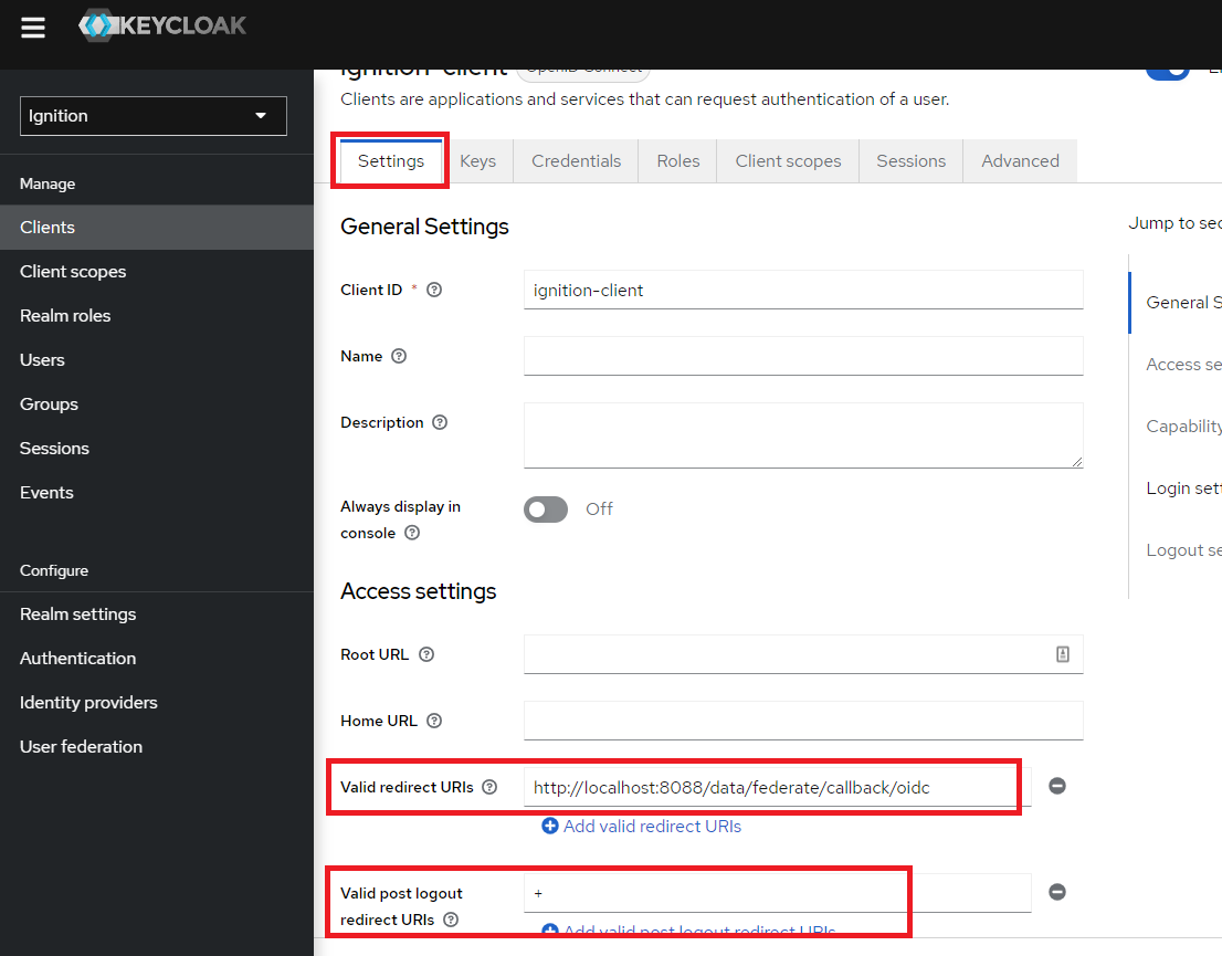

8. In Keycloak, navigate to the Clients > ignition-client > Settings tab. Paste the redirect URI from Ignition into the Valid redirect URIs box. Also, add a ‘+’ symbol into the Valid post logout redirect URIs box. This notifies Keycloak to use the same list of valid redirect URIs. Click Save to complete changes.
![Valid redirect URIs](/blog/sites/default/files/inline-images/image40.png)

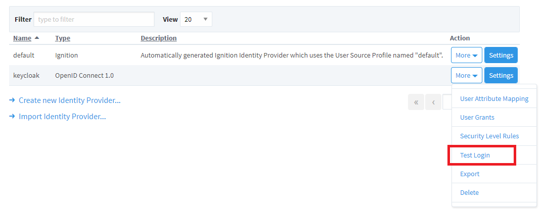

1. From within Ignition, navigate to Security > Identity Providers. Use the More dropdown menu for keycloak and select Test Login.
![Test Login](/blog/sites/default/files/inline-images/image14_2.png)

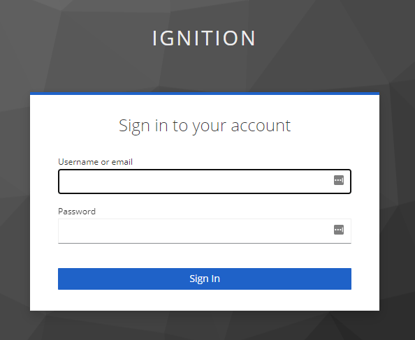

2. The default Keycloak login screen will appear. Note the ‘IGNITION’ name, which is referring to the Ignition realm created in Keycloak.
a. Sign in with one of the usernames created during setup.
![Sign in](/blog/sites/default/files/inline-images/image36.png)

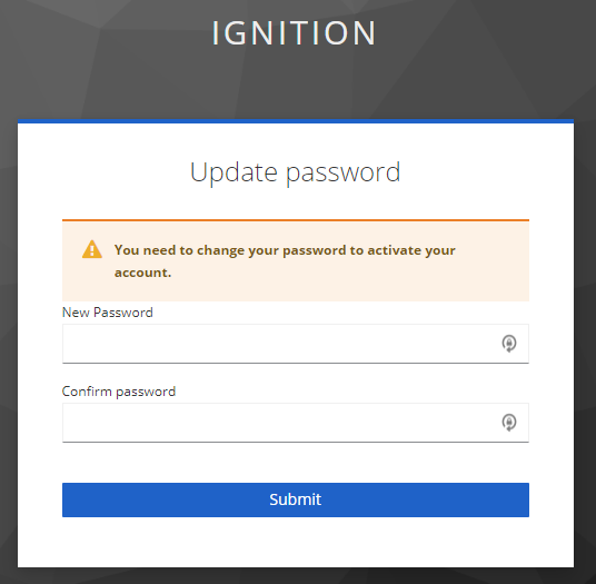

3. Since this is the initial sign in, a prompt will appear to update the password for this account. Again, for this example, the initial password credential was set to temporary, which forces an update to the password. Update the password and click Submit.

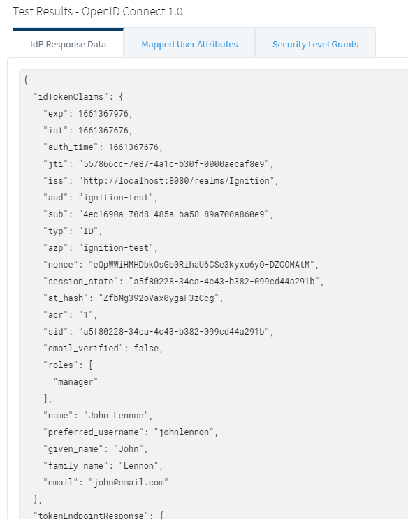

4. Upon a successful login, the response from Keycloak can be seen within Ignition.
![IdP Response Data](/blog/sites/default/files/inline-images/image31.png)

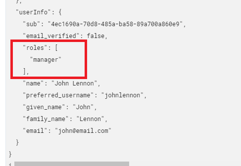

5. Specifically, note the ‘roles’ token nested in the ‘userInfo’ token. This was previously configured in Keycloak.
![A Closer Look](/blog/sites/default/files/inline-images/image5_13.png)

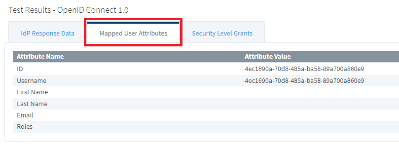

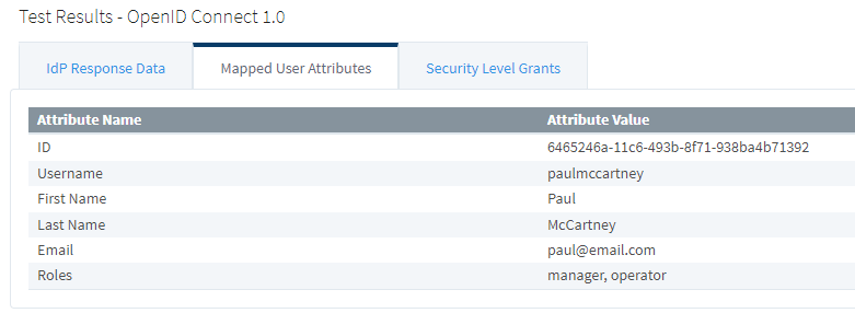

6. Navigate to the Mapped User Attributes tab. Notice that only the ID is properly mapped.
![Mapped User Attributes](/blog/sites/default/files/inline-images/image11_2.png)

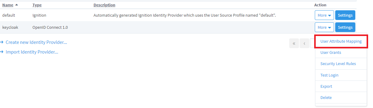

7. To set up the mapping, navigate to Security > Identity Providers. Use the More dropdown menu for keycloak and select User Attribute Mapping.
![User Attribute Mapping](/blog/sites/default/files/inline-images/image15_0.png)

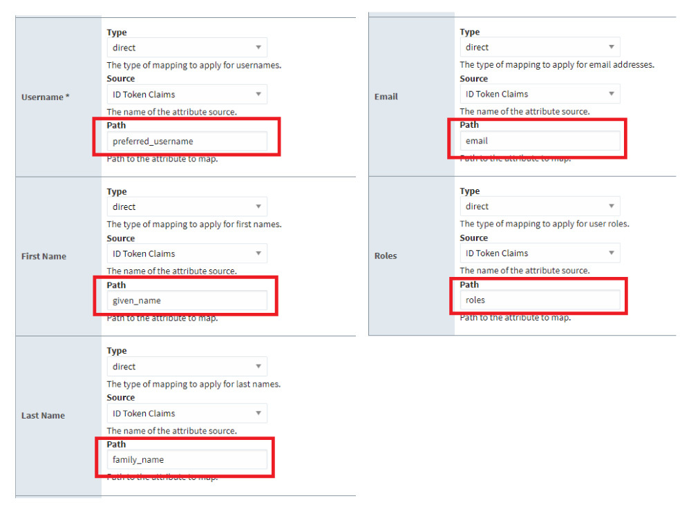

8. Map as follows:
a. Username: Type=direct, Source=ID Token Claims, Path=preferred_username
b. First Name: Type=direct, Source=ID Token Claims, Path=given_name
c. Last Name: Type=direct, Source=ID Token Claims, Path=family_name
d. Email: Type=direct, Source=ID Token Claims, Path=email
e. Roles: Type=direct, Source=ID Token Claims, Path=roles
![Username/First Name/Last Name/Email/Roles](/blog/sites/default/files/inline-images/image60.jpg)
9. Click Save.

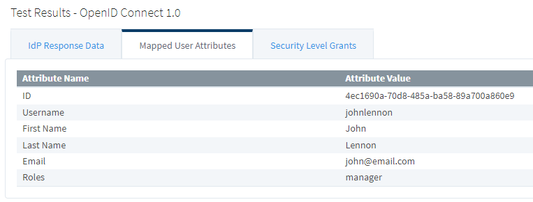

10. Test the Login again and navigate to the Mapped User Attributes. Notice the user info attributes are now properly mapped.
![Properly Mapped](/blog/sites/default/files/inline-images/image16.png)

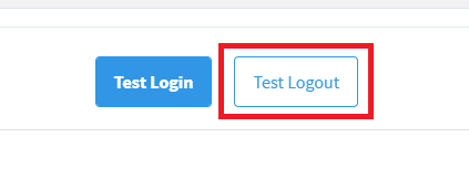

12. Verify the Test Logout redirects correctly as well.
![Test Logout](/blog/sites/default/files/inline-images/image20.png)

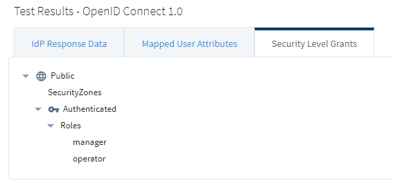

14. Finally, the security levels need to be defined in Ignition. The Security Level Grants in the test login results shows both of the configured keycloak roles.
![Security Level Grants](/blog/sites/default/files/inline-images/image52.png)

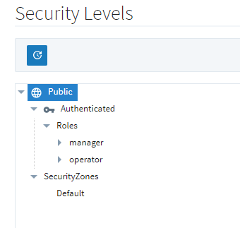

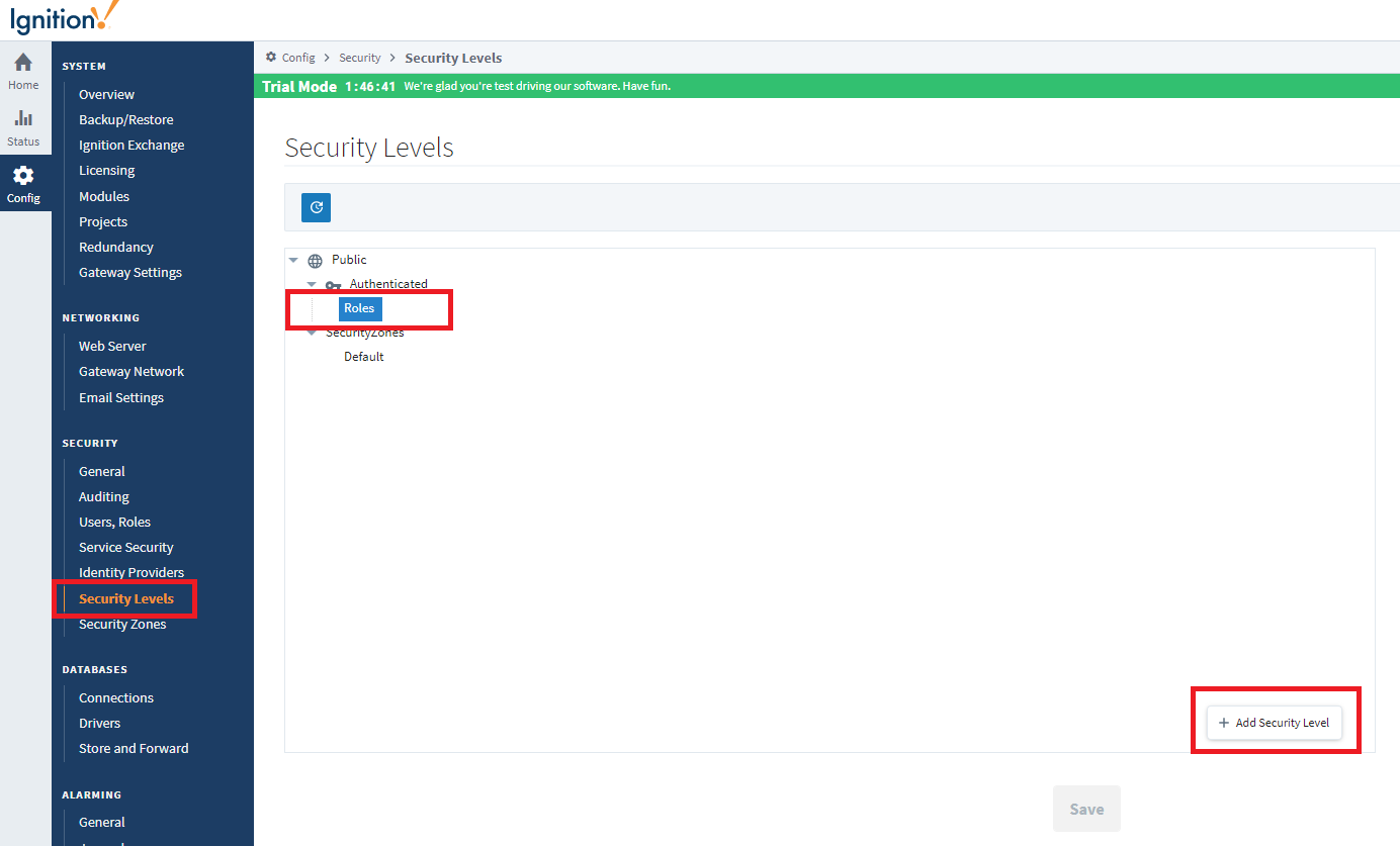

These roles need to be added to Ignition’s security levels. Navigate to Security > Security Levels and add the roles under the Roles branch.
![Add Security Level](/blog/sites/default/files/inline-images/image66.png)
15. Once complete, click Save. The new roles should be visible in Ignition’s Security Levels tree.
![New Security Roles](/blog/sites/default/files/inline-images/image10_2.png)

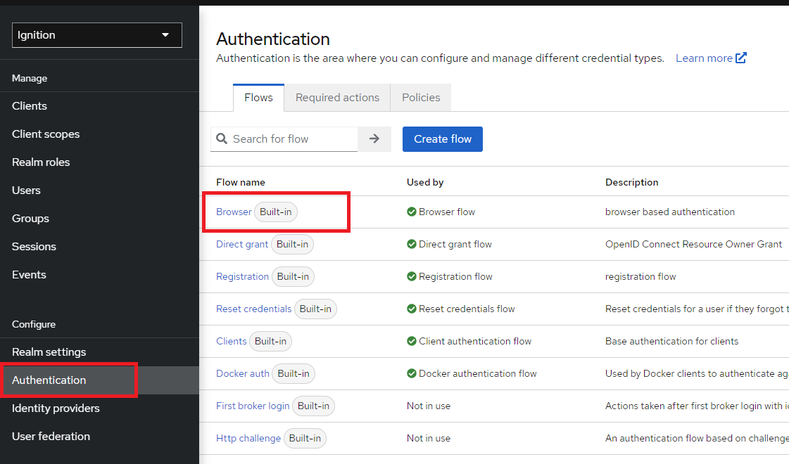

To configure an OTP for all users, navigate to the Authentication > Flows > Browser Flow name.
![Browser](/blog/sites/default/files/inline-images/image35.png)

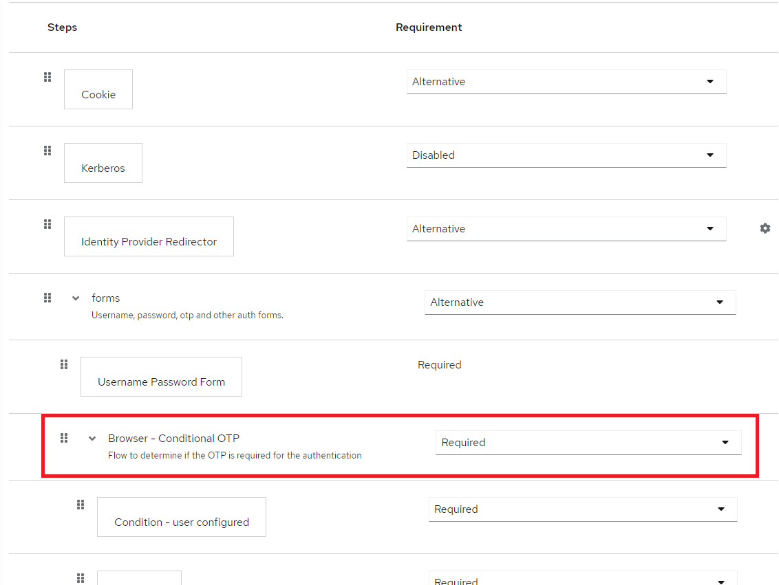

2. Find the Browser - Conditional OTP step and change it to Required.
NOTE: This will force all users to utilize an OTP with every login.
![Browser - Conditional OTP](/blog/sites/default/files/inline-images/image49.png)

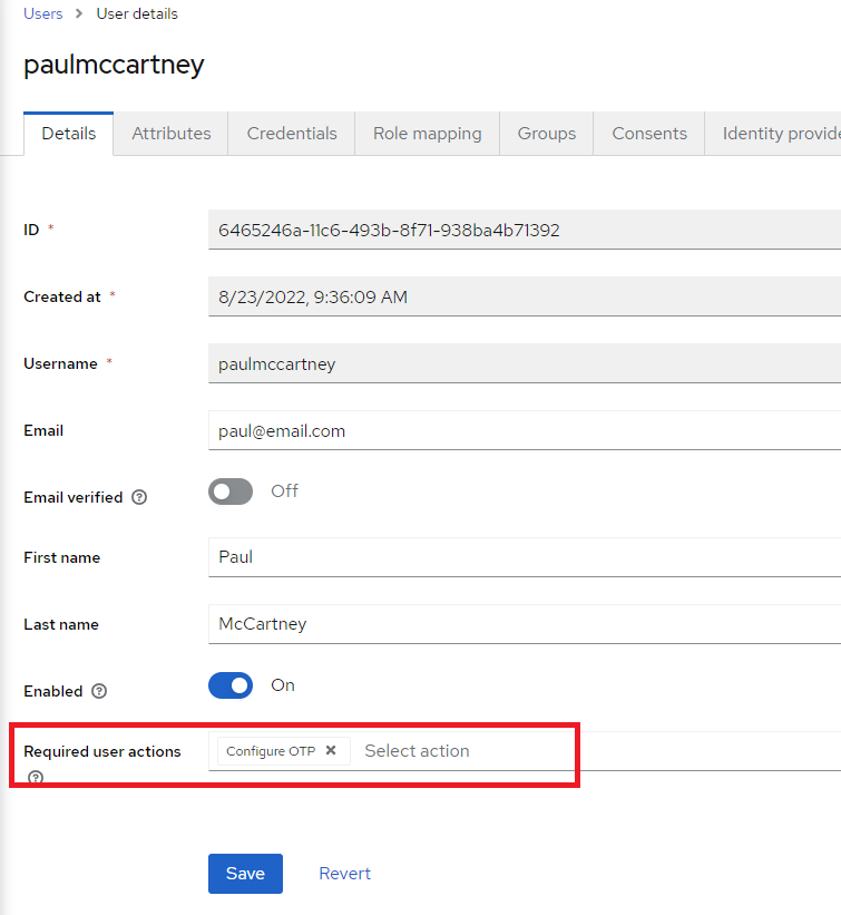

3. Another option is to set OTP on a per-user basis in the Required user actions when configuring a user. If this is configured, this particular user will be required to utilize the OTP with each login.

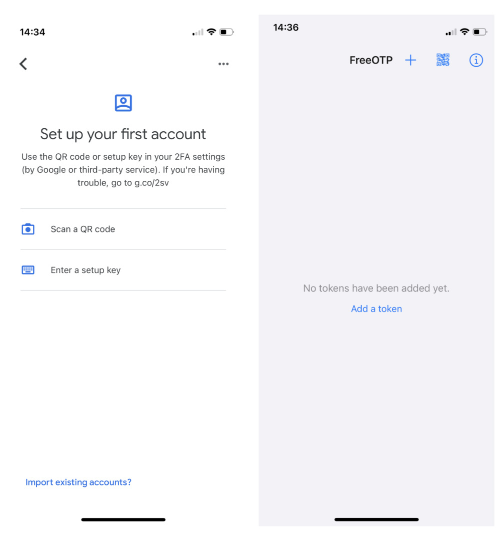

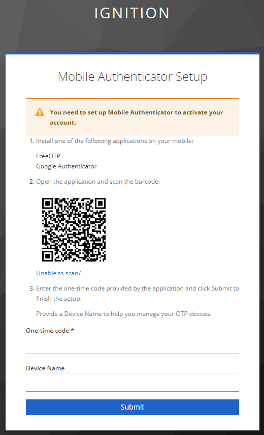

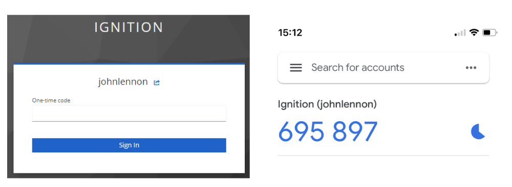

4. In either case, when the user logs in for the first time, the user will be prompted to set up the Mobile Authenticator (either FreeOTP or Google Authenticator).
NOTE: The FreeOTP or Google Authenticator app must be downloaded on a mobile device to proceed.
![Mobile Authenticator Setup](/blog/sites/default/files/inline-images/image3_21.png)
5. The apps have similar interfaces. In both apps, the QR code can be easily scanned.
![Google Authenticator/FreeOTP](/blog/sites/default/files/inline-images/image37.jpg)
6. If the scan doesn’t work, the setup key can be manually entered directly on the app. Select the “Unable to scan?” link on the login page. This will bring up another screen with the setup key.
![Unable to scan?](/blog/sites/default/files/inline-images/image21.jpg)
7. After the initial setup, the user will be prompted on each subsequent login for an OTP.
![Prompt](/blog/sites/default/files/inline-images/image41.jpg)

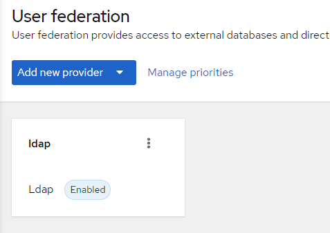

User Federation - Active Directory
In a scenario where a customer is using an existing external database or directory (like Active Directory) for user management, but also wants to add in 2FA (two-factor authentication), implementing the User Federation component of Keycloak is a great option. Using the following steps, Keycloak can be configured to import users into the local database and incorporate additional authentication requirements, such as OTP.
1. Select User federation from the side menu.
2. Select the dropdown Add new provider > LDAP.
![LDAP](/blog/sites/default/files/inline-images/image65.png)

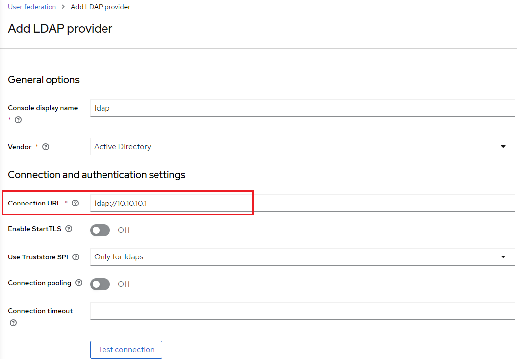

3. Add the Connection URL of the Active Directory server.
a. For example: ldap://<myADserverIP>
![Connection URL](/blog/sites/default/files/inline-images/image57.png)

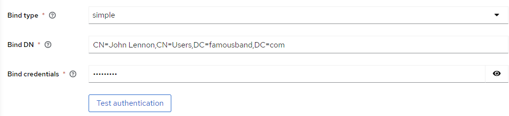

4. Next, add in the bind distinguished name (Bind DN) information.
![Bind DN](/blog/sites/default/files/inline-images/image25.png)

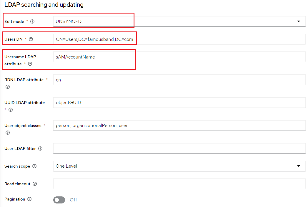

5. In the LDAP searching and updating section, select the desired Edit mode. There are three modes available for user storage: READ_ONLY, WRITEABLE, and UNSYNCED.

a. For this example, UNSYNCED will be selected for the mode.
b. Enter in the full DN of the LDAP tree for the Users.
c. Since Active Directory is being used, the Username LDAP attribute will be sAMAccountName.
![LDAP searching and updating](/blog/sites/default/files/inline-images/image18.png)
6. Click Save to add the new LDAP provider.

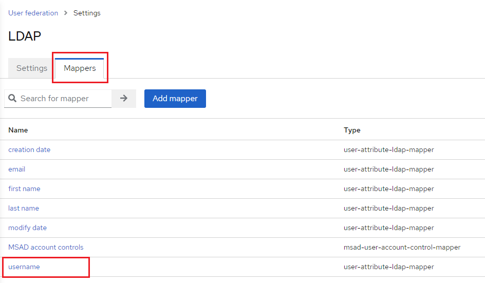

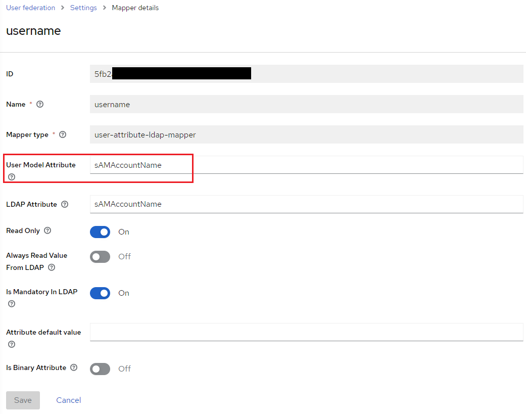

8. Select the Mappers tab. Then, select the username mapper.
![Username Mappers](/blog/sites/default/files/inline-images/image56.png)
9. Modify the User Model Attribute to match the Username LDAP attribute previously entered during configuration. In this example, that value is sAMAccountName.
![User Model Attribute](/blog/sites/default/files/inline-images/image51.png)
10. Click Save to apply the new mapper values.

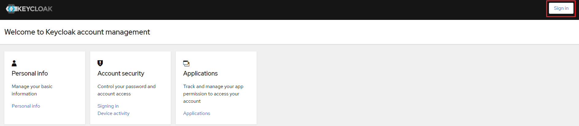

12. Once a successful connection has been established with Active Directory, verify that the user can be authenticated from Keycloak. Navigate to the Clients > Clients list > account-console Home URL.
![Home URL](/blog/sites/default/files/inline-images/image59.png)
