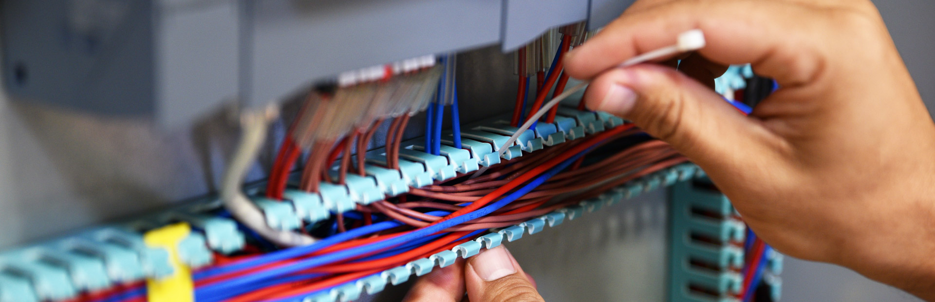

Someone wiring a PLC

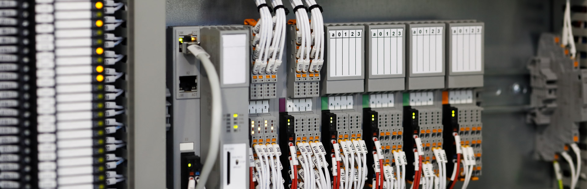

Programmable Automation Controllers
What Is the Future of PLCs?
The industry continues to see new products entering the market ranging from devices like Programmable Automation Controllers (PACs), which combine the functionality of PLCs with higher-level PC functionality, all the way to industrial embedded hardware.
